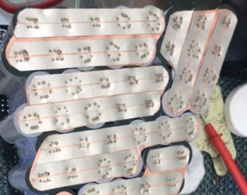

Re: Spot Welding Copper Strips to 18650 Battery Cells
from my observations i think the nickel sandwich works cause the nickel heats up enough to fuse the copper to the cell.spinningmagnets wrote: ↑Sep 20 2020 2:23pmI can only speculate as to why the copper/nickel sandwich works, but...for some reason it works.
with straight copper to cell, it would only work with tungsten electrode tips. the tips could be seen glowing cherry red for an instant as the weld was created, but the weld was still cool to touch after.
tungsten gets hot cause it has quite high resistance, but wont melt.
copper is just so good at passing current and without getting hot that its very difficult to get it hot enough with standard copper tips.
with the sandwich, the nickel does the heating, and id say also may help by excluding the air.
it works brilliantly and gives strong welds, but still requires very high power and vary short pulse time.
i couldn't get diy plated copper to work, the nickel would just vaporise off and get bad welds.
Correct. We even electroplated the copper with nickel ourselves. Tried several times. Never could get consistent weldsridethelightning wrote: ↑Sep 22 2020 7:05am
yep, 2.0 copper is tig welding territory! though, if your lucky, you might be able to get the 0.15 nickel to weld to it, provided its well cleaned and you have enough power. if you insulate and preheat the copper plate with blow heater or heat gun while you weld nickel to it it might help. you could then let it cool before welding the nickel bridges to cells.. i will be keen to see how you get on67carguy wrote: ↑Sep 22 2020 9:41pmSo my conclusion is if I go with these particular cells, a 2mm thick "holey"copper plate may be better, and the "laminated" .15mm nickel may be the most practical way to get from the copper plate to the cell. I may try a nickel-copper sandwich using the .15mm nickel and the 2.0mm copper plate once I get my kWeld but I'm doubtful.
yeah, and it pisses me off because iv opened powertool packs to find they have spotwelded plated copper to cells very nicelygarolittle wrote: ↑Sep 22 2020 1:01pmCorrect. We even electroplated the copper with nickel ourselves. Tried several times. Never could get consistent weldsridethelightning wrote: ↑Sep 22 2020 7:05am
It's my understanding that Makita and others use nickel-plated copper so that the nickel provides corrosion protection, The nickel is thin, and does not help the welding. These manufacturers often use a laser-welding process, with a very expensive and fast machine.

I’m doing the sandwich....
0.1mm pure copper sheet/foil
0.2mm pure nickel x 8mm
I figured this cross section should give zero
“C rise” to 75-90 amps
100-140 amps with some loss to heat
160 amps max
I have a 30amp BMS. 35 miles on the pack so far.
Not even warm to the touch when asking 30amps.
60 Jules and using 3 LiFePO4 12.8v nominal 9.6ah packs to power the Kwelder 1500-1600amps draw from Kwelder.
