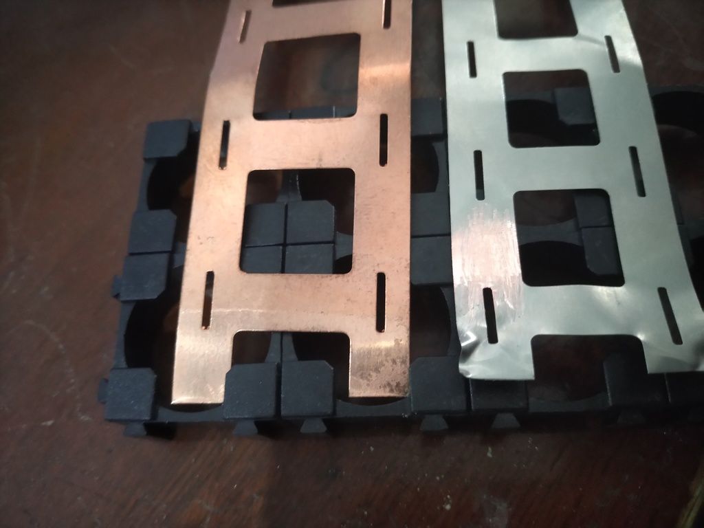

Why would a copper sheet with holes and nickel plated stripes welded across holes and then welded to battery surface be better than just solid nickel welded across battery ends, am I missing something?

Nickel has about 1/4th the conductivity of copper, which also means that it has about four times the resistance. At fairly average amp levels, then using only nickel would be fine. At high amps, the nickel buses begin acting like a heater. They would convert a higher percentage of the battery watts into waste-heat.
Resistance compounds over conductor length. As long as the nickel portion is short, it lessens the negative impact. Also, when nickel buses get hot, they stay hotter longer than copper. In the style I described, the copper portion would also act as a heat-sink, to pull heat away from the short nickel part, and then copper would shed that heat much faster than a nickel bus.
It all comes down to how many amps do you want to use? For common 10A cells, the common 0.20mm thick X 7mm wide nickel ribbon is fine. The 30Q can put out 15A, and the HG2 can put out 20A.
If you have a 5P pack of HG2 cells, the cells can put out a combined total of 100A, and putting 100A through 0.20mm nickel is not an optimal method.
It also doesn't hurt that copper is cheaper than nickel. And if you are building your own pack, why not?

Re: Spot Welding Copper Strips to 18650 Battery Cells
This is an example of several ideas I have been growing fond of.
Honeycomb layout of cylindrical cells
copper bus-plates for high conductivity and heat sinking/radiation of amps heat
nickel tabs to connect cell-ends to bus-plate
By connecting the nickel tabs to the copper bus-plate before you spot-weld cells, you can use high heat with a simple and cheap 2V / 700A DIY RSU. After you are done and the work-piece cools off, you can move on to spot-welding the cells onto the nickel tabs by common methods

This is so cool. That looks like a perfect design for high amp rated projects. I would think this design combined with the Kweld unit would make for a powerful 18650 battery pack.

If you can get your cell position precision to a high standard, then you could buy this pre- made and use some shears to cut to required shape. Damn! That would be very cool!
My problem with the glued cells was minor changes in position of the cells meant every piece was different. Cell holders or CNC cutout would solve this. Makes me want to build!
