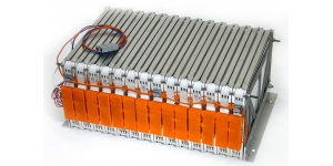

My zeon uses 4 Trojan 31XHS and has a compartment roughly 28" x 12.9" x 10.5" high.
My pure grass cutting blades use 30amps while some pretty heavy duty mulching blades I have can use 80amps. My current set of trojans is down to giving me 35ah so I need to replace them soon. I've been looking for a long time and have 4 options right now.
Another trojan pack ~$900. The mower is on it's third pack now. 2 before I bought it and then the one in it which has always had a 4 bank charger.
I saw some 200AH prismatics that could fit but it is 5k for the bare cells not even counting shipping.
A actual lithium zero turn mower from mean green mower for 11k+. I'd probably do this before sinking 5k+ just for batteries into the discontinued zeon mower.
A salvage pack. A big potential weight diet for the mower to prolong it's life and maybe a little bit more than the "advertised" range. Does anyone have any experience at using them at ~48 volts or have an opinion on what might work better?
The person at hybrid auto center suggested the following batteries which seem like a really good fit for where I want to install them.
20l x 10.5w x 11.5h capacity 90Ah Volt(?) packs

If I'm pulling less than 1C closer to .3-.5C for an hour or two does it matter which I use? It is looking like the Volt batteries won't fit easily. I partially dissasembled the mower yesterday and took measurements. I'd only have two choices for getting 3 volt batteries and i'm not sure I should do either.
1) Cut the cooling sections off the side to slightly cut down the width.
2) Cut through about 30" of 1/8" steel to remove the back of the mower and move it back an inch then put it back on. All the electronics hang off the back of the machine so this may also require wiring replacements.
In either case I have to raise the seat cover 1-2"
So I'm probably left with the option of 2 volt batteries and minor surgery to raise the seat.
4kWh 12 cells, 94Ah with BMS. 45 volt nominal max voltage 50v $1,235
or going with a kit of leaf cells that would fit without a problem. I suspect I could drop the cell count down to match and maybe save a little $.
6.4kWH 14 cells, 120AH with BMS. 53.2 volt nominal max voltage 58.8v $1,890
The mower is 48V running on Trojan Lead Acid which means it can see 59.2 right off the charger if used right away or 50.4 if it is on a maintenance charger. It has been running lately 46v-44v for most of the time and I limp around just above 41v with a 41V cutoff where the deck shuts down. My batteries are toasted now so I run them down but I used to stop at 43 or so or when once battery dropped down below 10.8.

Yes those are the pictures :!: I was looking at them before on my phone but on this huge monitor :shock: :shock: I'm going to try and take one more series of measurements. Maybe there is a way to make it wide enough for the cooling chamber by just "expanding" the bottom 1/3rd or so of the box if the batteries were next to eachother and not in a line.
So I have a 12S 120AH leaf battery setup coming with charger and BMS. The BMS has wifi so hopefully it will be something I can connect to and do some easy monitoring.
It came down to space and wanting to preserve the mower as much as possible without making it into a rolling science project. The leaf batteries will fit without modification at all. The 12S is for fear that all three controllers show a range of 42-55 volts. The price of replacement lead locally was about 1/2 as much so it isn't too big a jump. The weight of lead is a bit more than 2x as much so I'll save dragging around some weight. In theory i'm going from 70AH usable to ~100AH. I usually stopped around 50AH in the best of times with the trojans so the difference might be a little better. I've also found a way to reduce amps with some flat blades that work really well in my grass so that should help even more.
Finally got it all together and in the mower. 12s or 14s of leaf cells would fit perfectly. I went with 12s because I worried about letting the smoke out of the controllers since they discontinued the motor after a short run a few years ago.
