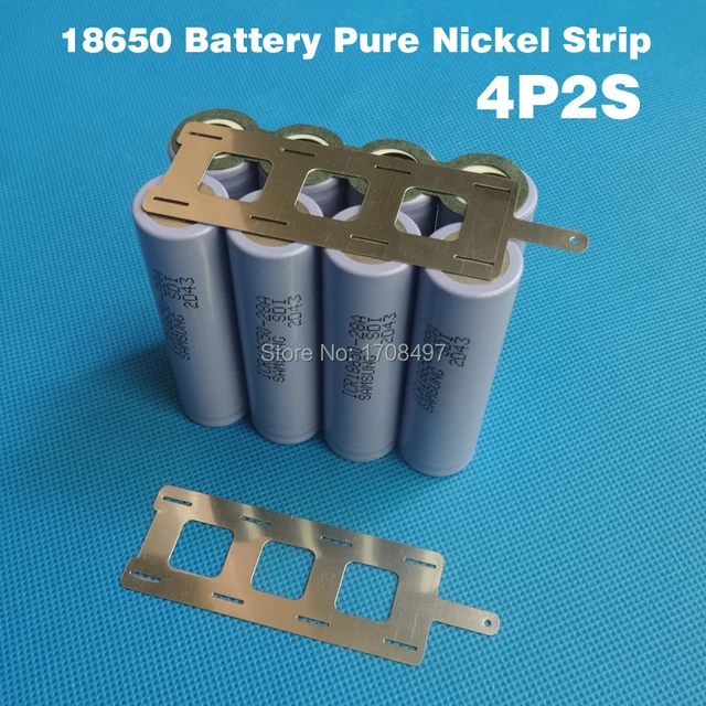

Well I hammered out some gilding metal to .15 and .2mm. Its not the best way to prepare a sample cause of the surface irregularities. So the results were a little inconsistent. But having said that I welded the .15 mm straight to the can with reasonable results. I say reasonable because whilst the first weld pair were great( nice and strong) the second weld was a bit hit and miss sometimes good sometimes didn't take.
The .2mm slotted was just ok straight to the can- wouldn't persue it, but if welded to nickel this resulted in a good weld.
So in summary so far:
.1mm pure copper: OK (main daw back is weakness)
.2 yellow brass : good
.2 yellow brass slotted: very good
.25 red brass:very very poor (no weld at scary power)
.25 red brass slotted: very good (very strong,but req a decent amount of power)
.15 gilding metal slotted: good
.2 gilding metal slotted: fair (hard to stick second weld)
All results better if welding to nickel instead of directly to can.
Slotting improved results even more so than in nickel..I guess with high conductivity alloys the trouble is actually getting the current to go down into the can to make the weld points, hence slotting making a bigger difference than in nickel. And I needed to keep the welds as far apart as poss to help stick the 2nd weld.
I've got some .15 yellow brass on order. I want to see if this will make good broad sheet peices to cover entire P groups- think Madin88 style.
( If anything it is way cheaper than nickel. )
I'm trying to find two separate outcomes .
One is a cheap nickel substitute- doesn't necessarily need to carry more current, but needs to weld well. I'm thinking broad .15yellow brass for this. Cheap, available every where,will prob weld fine.
The other, a high current option that can take around 20 amps from a cell(s) and not get hot.
Still working on this but .25 red brass or .2mm gilding metal may be contenders esp if welded over nickel
Hard to source though...

Parallel strips works awesome for the first weld. Then it's still pretty good for the second. But... It soo fiddly and time consuming it's often not worth it. A longer (20mm) slot works almost as well without all the difficulties. having said that there would be times when it probl is worth it though.

There has been a recent development of using a "sandwich" of nickel and copper. Copper and brass sheet are both cheaper and more readily available locally than ordering and waiting for pure nickel (8mm wide, 0.15mm thick, or 0.20mm).
For the SERIES connections (high amps), if you put a copper strip on the cell, and overlay a nickel strip, it welds much easier using the common welders (Riba, Malectrics, kWeld, etc). Since the copper strip carries the current, then the nickel strip does not need to be thick. 0.10mm-0.15mm nickel is fine for this.
The parallel connections can be pure nickel of any thickness, and even nickel-plated steel. Expected parallel currents under all conditions are very low.
