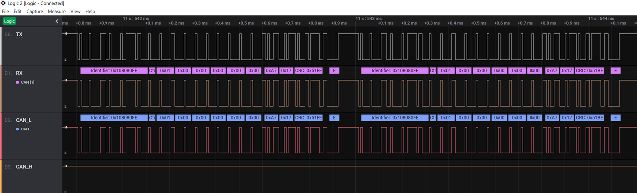

Just dropping by some info:
0x108180fe  01 00 00 00 00 00 xx xx    电压 a6 c0 - ea 67 01 03 00 00 00 00 xx xx    电流 00 00 - 04 e2 波特率125k 扩展帧 数据帧
If you Google 0x108180fe you can find the source.

Edit, Jackpot:
OCR:
Code:
0x108180fe      01 00 00 00 00 00 xx xx     电压            a6c0 - ea67
                01 01 00 00 00 00 xx xx     默认输出电压      c000 - e99a
                01 03 00 00 00 00 ii ii     电流            0000 - 04e2
                01 04 00 00 00 00 ii ii     默认输出电流      0000 -
xx xx = 1022 x 输出电压
ii ii = 197 x 输出电流
55.2V = dc 5e
15.0A = 01 27

0x1001117e      00 01 00 00 00 00 ii ii     输出电流反馈 = ii ii x 0.509
波特率125kbps扩展帧数据帧
Found some more stuff:
3脚通信H,4脚通信L
6/7/9脚用线焊短接起来,电源启动。
3 = CANH, 4 = CANL
Short pin 6/7/9 to turn the PSU on.
Seems like you have to short some pins, either internally or externally, to turn the PSU on.

usertogo said:
usertogo said:
I am going to test pulling them down to GND and report!
The good news is I connected the 2 board detection pins together and pulled them down to the negative 48V (GND) and that was all that was required to get the unit to power up and deliver the proud 53.5V output!
An internal modification was not necessary...

And I've also ordered some ESP32 dev boards + TJA1050 CAN transciever from AliExpress and will be making open source firmware to control the PSU through CAN.
With the ESP32 that means you could control the PSU through physical buttons, knobs or Bluetooth and WiFi.
Looking forward to ditching all of my other PSUs and charging 12S, 13S and 14S all with the same PSU and some fancy buttons/lights/display :D
I guess he's sold out for now. It'll probably take a week or two.
I'm already heavily invested in the EATON PSUs, so I'm just doing what I can to help from the outside.
All the CAN info you need is in this post: https://endless-sphere.com/forums/viewtopic.php?f=14&t=86038#p1427144
Use google translate on the OCRd chinese text (I don't speak chinese myself either, used google translate too).
That's the CAN IDs and messages you have to send to adjust the [default] voltage/current.
All you need is a microcontroller/dongle that can do CAN and maybe a CAN transceiver chip.
I doubt the chinese guy will give away his source code, I've read some forum posts of his and he didn't want to share any information for free.
As said before I'll be using an ESP32 + TJA1051 to control mine and will make the code open source, could take a few weeks however.
I do have a TI Tiva-C here too and a CAN transceiver chip in a broken device, so I might experiment with that too when I get my PSU.
I only need 10A for charging my 14S10P pack, even less for the others, so 2000W is overkill for me anyways :D
