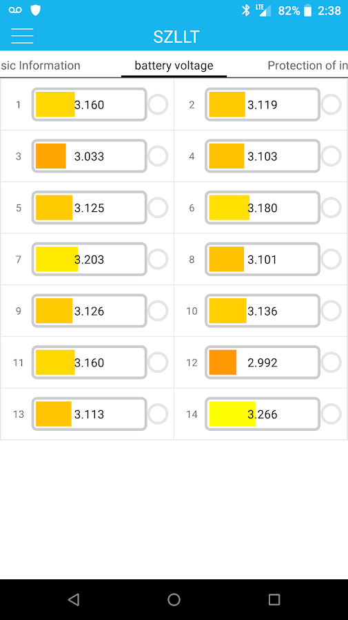

First post here just to share my successful BMS experience. I'm using the 14s 60a smart bluetooth BMS from AliExpress, link here.
I did calibrate all 14 cell groups with a meter that read to the thousands of a volt when I installed the smart BMS. If anyone needs to do this still, the PC software over the USB cable needs you to type in the voltage (in millivolts) that you measure with your meter. When you click "calibrate" it will calculate the offset needed. I still need to see if I can connect the PC software over Bluetooth as a serial device, since I sealed the battery pack, and not all settings are available with the android software.
My only issue is I need to get some experience with my creation to see if there is actually a problem with cell group 13, or if it just needs more cycles to be fully balanced. I did confirm the connection of all cells when I built the pack, and again confirmed all cells connected in group 13 and 14 when I installed the smart BMS. All 84 cells are new LG MJ1 cells, and I used them for a few cycles with a dumb BMS beforehand. Also for some reason cell group 12 seems to dip lower than the rest under load, but is fine with no load. All I'm wondering is when a battery pack gets empty, is it normal for the limiting factor to be one cell group suddenly 0.3 volts lower than the rest? At this point, I'll try watching it for a few cycles before opening the pack to test the capacity of all 6 group 12 cells. Here are pictures of my timeline:

first of all it's ok to see bigger differences in cell strings when they are empty than when they are fully charged. if 300mV is too much is hard to say w/o knowing the exact circumstances, but at 2.8V those cells have ZERO capacity left, they will drop to next to no voltage very easily.
as you said that all cells are new, you would NOT expect one of the strings to become out of balance this easily or have a higher resistance than the others. IF the pack is welded properly. the current distribution needs to be exactly the same for all cell strings to discharge evenly. if the serial connections are of different cross section they will discharge unevenly. maybe posts pics of the pack, and we will find some ways to improve it?!
here are two examples of a perfectly even current distribution, and one of a "not so optimal" one. guess which one is the one made by me, and which one is a replacement for bionx which i tried to improve.
(btw: in case someone wonders: ALL of these are brand new samsung 30q. i have to replace the heatshrink on some of them after i glued them together in the wrong order, that's why they are differently colored)

Nice battery build!thundercamel wrote: ↑Jul 24 2018 9:59amThanks for the replyI hadn't heard about different serial connections causing uneven discharging before.
Let things work out a few more charge cycles. It may be that the weak group is not really weak. It may be that you actually have a weak cell in there too. Smart BMS allow you to have so much better awareness of your pack status than dumb BMS. It is possible your dumb BMS was NOT doing it's job and you just didn't know it and now you do. Maybe you've had a problem with a weak set of cells all along? give things a few more charge/discharge cycles and see how it goes.
There's 2 things to think about in any pack. They have what I call a recovery voltage and a load voltage.
You will commonly see your cells sag to some lower voltage as you load them. I call this load voltage and it's the real voltage of the pack. Then take away the load and you will pack voltage rebound upwards several volts, this is recovery voltage and should be ignored as it isn't anything you can realistically use. Ideally, you want a battery pack that does NOT sag at all, or sags very little, like 1-2% at most. However, towards the bottom of your charge, you will see that sagging gets worse and worse. LEts say your pack fully charged is 48 volts and 36 volts when discharged. At 48 volts, you may see sagging to 47.6 volts. At 37 volts, you may see that under the same load that the pack sags to like 33 volts. This is pretty typical.
I'm sure you have looked at the last post by Izeman. That's what your pack ought to look like fully charged and fully discharged. Notice how similar his cell voltages are. This is what you want.
IMHO, A pack with a cell that runs down too quickly is only going to get worse and worse. IT is already weak and you need to load it just as much as the other cells around it. It won't hold up long term most likely. You have significantly reduced capacity becasue of a weak link in the chain. To extend the life of those weak cells, the entire pack has to be set up based on those weak cells. It can be used this way, but if you can fix it and eliminate the problem, that's the better solution.
There's a couple of things you can do to help yourself out, if you have weak cells.
1. set the start balance voltage lower. mine are set to 3.9 volts. This gives me more time to balance out the pack.
2. Set the LVC cut-off higher. You know some cells seem weaker than others. Set the BMS with those cells in mind.
3. If the other cells are something like 16Ah and the weak ones are 12ah, then realistically the pack can do 12Ah. Set the BMS to 12Ah.
4. Realistically you can go as low as 2.5 volts per cell on LION. I do NOT recommend this. In fact, I'd set LVC to 3 volts.

Thanks guys. Those are some really uniform voltages! Good to know that it's possible.
You're right, I'm so glad I switched to a smart BMS. I was surprised how much the voltage sagged under load, and this might be attributed to the fact that I'm pushing the Vruzend 1.5 caps to 4 amps per cell, once the efficiency of the motor controller is taken into account. I popped a 20 amp fuse when I first tested the bike, but have never blown a 25 amp fuse yet. The pack is 14s6p; 15s10p is huge!
I tried topping off the charge of group 13 last night, but the Zanflare C4 charger considers 4.15 volts to be full, which I can't blame them. My friend is bringing over his "highly configurable" charger tonight, so we can match the rest at 4.20v. I also was able to adjust my Vruzend charger from 58.8v down to 57.7v, so I need to make a post about that in the appropriate cycle life thread. Future charges should top out at 4.12 volts per cell, unless I'm planning to do a long trip ahead of time.
If there actually turns out to be a problem, I will be fixing the pack rather than using it in a degraded state.

Those Vruzend caps can only handle 5A, so with 6P that pack can only handle 30A.
What sort of current are you pulling?
If some of the caps are not seated as well as others the the resistance may be higher, coupled with pulling more than 5A per cell this could result in uneven discharge.
Maybe set the balance voltage lower too so the BMS balances the pack before terminal voltage.

imho that's the main reason for the issues the OT sees. if only one or two cells is not fully seated in the end cap he will see those issues.
those endcaps are fine for small packs for low power usage. tbh i haven't tested them personally, but have some (not so good) experience with spring loaded cell holders.
Re: bluetooth BMS?
considering the problems visible in the bms i have to disagree about how well it is working.thundercamel wrote: ↑Jul 25 2018 11:41amPossibly, but spot welding seemed too permanent to me, even if the nickel strips can be torn/drilled off and the cell ends filed down. If they actually prove to be a problem, I'll consider a more compact staggered spot welded arrangement, that might fit all 84 cells in the frame. So far, the performance has been great!
the longer you drive with this the faster you are killing you cells.

After absorbing over an amp hour, I got group 13 pretty well matched with the rest. As I've only done one cycle so far with the smart BMS, I will just be keeping an eye on everything as I go from here, to see if there is actually any problems.
This setup is actually my wife's bike, and after experiencing how well it works, I can't help but assemble parts to convert my own bike.
The last piece of the puzzle that I've been waiting to become available are the Vruzend 2.0 caps. Hearing ElectricGod tell me that there should be less than a volt of sag under load, flippy's opinion, and the unknown wait time has got me looking into spot welding instead. If I notice big differences between the two bikes after that, I'll be able to rebuild her pack and possible fit all cells into the frame with a staggered/honeycomb setup. Future developments with me can be found at the build thread I just created, so that we can keep this thread focused on smart battery management systems
