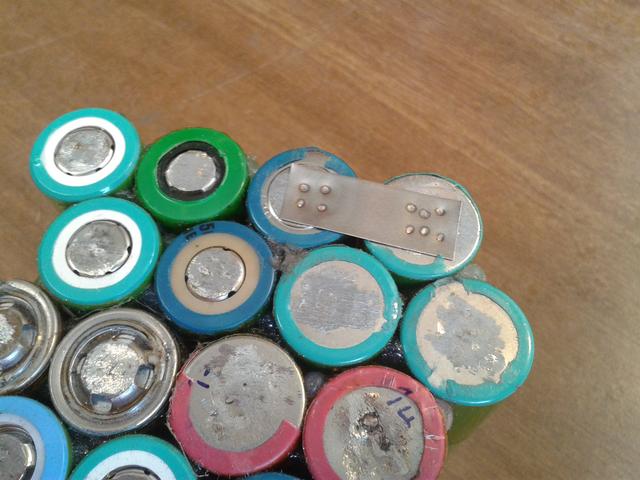

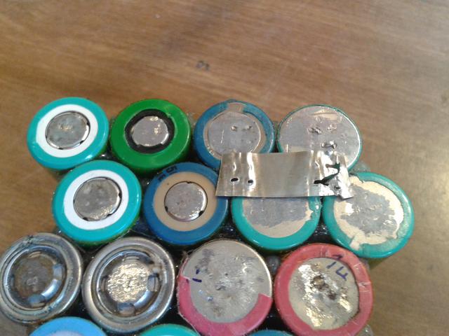

I'd like to see what results other users of this welding machine get with the various parameters that can be set.
These days I changed some settings and I tried to vary the resistance of the input cables and the input voltage.
My target is to obtain the lower pulse width with the higher current to have a nice clean spot.
At the beginning to solve the over current problem I reduced the voltage of my LiPo input battery from 12V to 8V but now I noticed that at 8V I have a fairly low current at about 1200A with a pulse width of 35ms with a 50J energy (nickel strip 0.2mm thickness). This result in a spot not clean but with a black/blue contour because the longer the pulse width the higher the heat generated between the two spots.
So I tried to reduce the input cables resistance and I obtained a cleaner pair of spots (nickel strip 0.2mm thickness) with the following setup: Input Batt: 8V; Energy set 55J and the results where PW=12.78ms Current=1405A.
After calibration I obtain values between 1.2mOhm and 1.4mOhm
Now I'm trying the first battery setup with a LiPo 3S5P but I have added some resistance in the input cables by adding 200mm of 10AWG cables on both positive and negative than I will reduce the length of the input cables to see what I can obtain at 12V.
The first results are the following:
Input Batt: 12V; Energy set 55J and the results where PW=40ms Current=1358A with a bad pair of spots not clean (nickel strip 0.2mm thickness)

I may be wrong but, kWeld does not limit the current, it adjusts the pulse length on Joule basis. Your only current limiting factor is circuit resistance. Lowering circuit resistance, like shortening cables, increasing cross-section, increasing surface contact on electrodes without any change in settings will increase current and by algorithm lower the pulse length

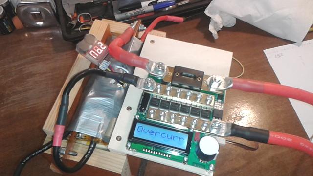

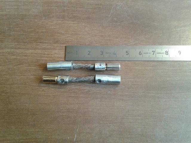

Sure it works that way so I started with these huge 4AWG cables:
And this 3S5P lipo made with very old zippy lipo 5000mAh 40C cells:
And I could not do anything because Kweld tripped the over current protection while attempting the first calibration. So following the advice of the builder I reduced the input battery at 2S5P ad finally succeeded to have a calibration done with a R=1.24 mR. Note that I also changed the input cables to 8AWG because I do not have the copper bar on the second negative contact of my welding battery.
This is what I have that produce the colored black/blue spot welds due to too many long pulse width as described above.
Two days ago I decided to dial the welder in a better way because 280 new VTC6 cells are on the way to my home and I will be spot welding a new battery shortly.
Again following the advice of the builder I tried to reduce the cable resistance staying at 8V (2S5P) and for the moment with the positive input cable back to 4AWG I obtained the best result so far. A cleaner pair of spots (nickel strip 0.2mm thickness) with the following setup: Input Batt: 8V; Energy set 55J and the results where PW=12.78ms Current=1405A.
Note that with this setup I trip the over current if I try the calibration.
I would like to reach a current around 1800A - 1900A with a pulse width of about 10-15ms so for the moment I tried to go back at 12V with the idea of shortening the 10AWG cables a little at a time (which I added) to see if I have an increase in current during welding but may be I will try again 8V with also the negative cable back to 4AWG.
I wonder if anybody else with Kweld obtained spot welds with current around 2kA?

OMG :shock: You really are seriously in it!
I suppose, over current protection feature is codded in to the IC algorithm to protect Fets and not a discrete hardware solution.
Can't tatus just remove it or raise the bar a little, just in your welder, for experimenting purposes? :)

My thoughts to this are that this is a kind of optimization task:
a) the current must stay below 2kA during calibration (with zero Ohms spot resistance)
b) the current should not drop too much when the weld spot resistance is added to the total resistance (typical values of that are 1-2 mOhm)
c) total wiring length must be as short as possible to minimize inductive kickback
d) wire cross section should be as large as possible to minimize losses
There are a number of contradictions in this (this list is probably not complete):
- to achieve a) we need to use a low battery voltage and/or thinner wires
- we can't easily extend the wire length to addr resistance because of c)
- to achieve b) we need to use a high battery voltage, which minimizes the current drop caused by this additional resistance
- a high battery voltage will again increase the current, endangering a)
- we can't easily increase the wire cross section to achieve d), because this again endangers a)
My solution to this optimization problem was the Turnigy nanotech 3S/5AH/130C, plus 1 meter of 8AWG wires. The typical welding current is around 1400A, and calibration does not exceed 2000A. I am paying a price for this, which is that the system efficiency (amount of energy delivered into the weld versus drawn energy) is only 15%.

bigbore wrote:
May 11 2018 11:35am
Maybe you can use a trick here. As I described above, calibration current is always higher than welding current, because the weld spot resistance is missing. You can do the calibration with a weaker power source that delivers 1000-1500A. The machine only measures its output resistance, and it just needs enough current for that. Once you have done that, you can crank up your source.
parabellum wrote:
May 11 2018 1:05pm
Yes, this is a software feature. I could disable that, but that will likely end up in a smokey and expensive experiment. I have actually done this experiment, and achieved roughly 100 pulses at 2800A before breakdown. As ohmic losses (and also magnetically stored energy levels) are in a quadratic equation of the current, this means that I have been using the machine at twice it's ratings. Interestingly, one of the MOSFETs failed, and the TVS diodes were still intact.

During week end I keep plying with the bigger battery option (12V) that is 3S5P shortening the 10AWG wires that I used as a resistance in the input cables.
It turns out that 30mm is the best solution to have some nice and strong spots.
These are the "resistance" I'm going to use:
The total cable lenght including copper electrodes is 1,28 meters and with this setup I was able to lower the energy needed to weld 0.2mm nickel from 50J to 30J. This is one result I noted down, but it is rapresentative for the average results. PW = 13.98ms at 1527A with 27.5J, during the many weld test I made I obtained currents from 1530A to 1560A.
