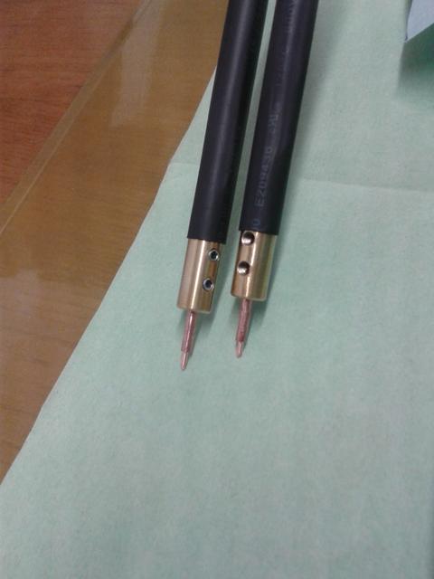

Using the kWeld for a few builds recently, but the cables/electrode holders can get too hot to touch after 5/6 welds. It takes 10 minutes or so to get this point.
After calibration I am getting 3.9ohm using a 12v 90ah car battery. Is this figure too high?
I am also using the previous version of the electrode holder. The bullet connectors...

The bullet connector electrodes should give you roughly 2.5 ~ 3mOhms during calibration. I suspect that your battery isn't delivering enough current, it should be at least 1000A for an accurate calibration. When you keep the foot switch down after making a weld, what current level does the display read?
What material are you welding? If that is 0.3mm nickel, then you will need regular cooling breaks. This is one of the reasons why Ron and I have been working on an beefier electrode system. The problem is that the welding heat is partially transferred to the electrode tip. As copper is a good thermal conductor, it is distributing that into the electrode holder as well. Our solution to that is to make everything bigger which increases both thermal mass and heat dissipation capacity. The new kWeld stock electrode system also attempts to use a longer electrode rod connected only at the rear end, so that heat has to travel a longer way.

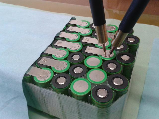

Test weld this morning.
Welding 0.3mm nickel strips together.
120j manual- 1163a.
tatus1969   100 W
Posts: 273
Joined: Mar 17 2017 7:36am
Location: Germany
Re: kWeld - "Next level" DIY battery spot welder
Post by tatus1969 » Jun 14 2018 9:14am
sacko wrote:
Jun 14 2018 12:55am
120j manual- 1163a.
Current is a bit on the low side for 0.3mm nickel. It is better to get this up to 1500A (more voltage and/or less battery ESR), because the pulse duration becomes shorter then and less heat can spread out during the pulse, lowering both energy demand and losses. This will keep the elctrodes cooler as well.

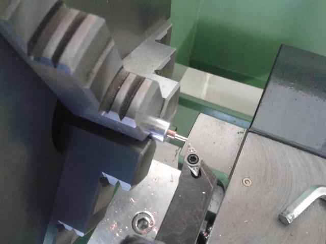

It looks to me like the bullet connector is no longer used with the revised system.
The following is from the online shop, "...requires access to a suitable crimping tool with inserts for 6.5mm diameters...".
I'm thinking that you cut off the old bullet connector and crimp on this new copper electrode holder. I'm thinking that the set screws are the new way to swap out the new longer electrodes.
If I'm wrong, I'm sure Frank will correct me when he has some free time.
Unless you have access to a 6.5mm crimp die, it might be best to choose the assembled option so the holder comes crimped onto a cable.

Regarding the longer electrodes, are you able to crimp them into a bullet connector for me; so I can do a straight swap with my existing ones?
I wouldn't recommend doing that, because the bullet connector's material overlap is just a few millimeters and not mechanically stable enough. I have already built up new stock of those bullet connector style tips to be able to supply replacement parts for existing customers. It's not online in the shop yet, if any of you has immediate demand please let me know.
Alcus wrote:
Jun 23 2018 11:13am
Exactly! The tool that I am using here is something like this: https://www.jaycar.com.au/heavy-duty-te ... r/p/TH1849 in the (smallest) 6mm^2 setting. The brass electrode holders were a bit too brittle and could break if not centered well, but the new copper holders are very easy to do.
I am sorry but I made the mistake of not having ordered some individual new electrode holders from my supplier (only complete sets, plus spare electrodes), which would have allowed me to also sell them individually as an upgrade part for those already owning a kWeld. I made a quick calculation, and the set of electrode holders and electrodes make up for more than 80% of the price for the unassembled cable kit, so I hope for your understanding.

last weekend I finished the assembly of the battery, this is the definitive setup I used to spot weld the 280 cells of my 20S14P battery.
Currents went from about 1600A at the beginning of each section to around 1750A after around 100-200 spot welds, I guess my welder battery has warmed up and and reduced it's IR.
In my opinion this is the best shape of the electrode tip. It allows to maintain a constant contact surface while consuming the electrodes. The tips are turned down to 1,5mm diameter.

I also experience this, the chemistry likes it hot. But the major part of this is the current reading itself. Current is measured from the voltage across the MOSFETs (the most cost effective principle), which has a temperature dependency. A typical "rough use" MOSFET temperature is 25K above ambient, which accounts for an error of approximately +10%. You shouldn't notice this when welding, the variation from material escaping the weld from arcing is much bigger that that. In fact the current production batch (that arrived TODAY! [still waiting for cables]) has a temperature sensor close to the MOSFETs to correct that.
Great pictures, thanks for that :-)

... upgraded electrode system...
The clear shrink wrap is a great choice. Looks really good and very practical.
Looks like a much greater crimping area. How many mm does the cable insert into the revised holder?
That hasn't changed actually (10mm). It just works much better with copper compared to brass.
