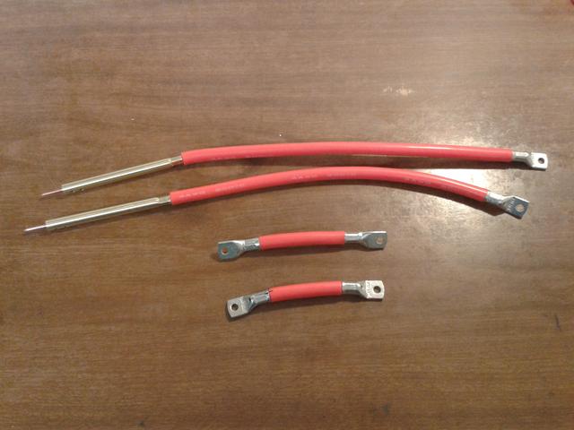

I'm almost ready to turn my Kweld on for the first time. These are the massive 4AWG cables with 10mm diameter brass electrode holders. The electrodes I'm going to try for the first time are made with 3mm copper rode.

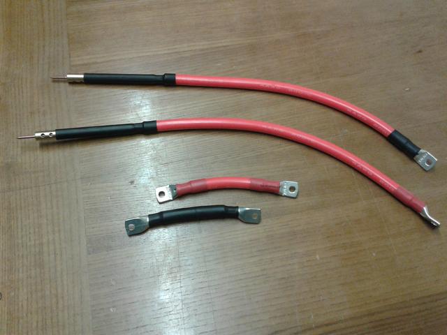

This is what Kweld looks like with 4AWG cables
I’m very excited to find out what resistance I have after calibration. The length of the cables are the same as per manual with shorter electrodes holders but with this bigger wires I guess I can make them longer.

bigbore wrote:
Feb 20 2018 9:41am
What a monster! :wink:
bigbore wrote:
Feb 20 2018 9:41am
That'll probably depends most on your battery, I forgot what type you plan to use? The welder itself accounts for 0.33mOhm (switch path) + 0.78mOhm (fuse path) from terminal to terminal (actual measurement data).
EDIT:
bigbore wrote:
Feb 20 2018 9:41am
Keep in mind that this also adds inductance, and to dial the total round trip length into the unit if you exceed EDIT: 1 meter.

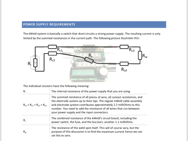

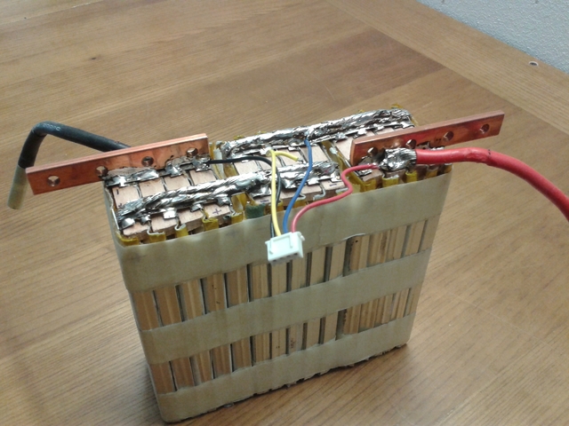

I will be using a 3S5P lipo made with very old zippy lipo 5000mAh 40C cells; this one
Then from calibration il will get Ri+Rc1+Rc2+Rc3+Rc4+Rs. Is it correct?

That looks like it has very low ESR, together with your thick wires you may exceed the 2kA limit. You'll see during calibration, maybe you need to reduce to 2S. Just guessing, anyway.
bigbore wrote:
Feb 21 2018 9:36am
No, calibration only measures between the two output terminals of the module, that is Rc3+Rc4. But as Rc1/Rc2 should be extremely low in your case, you can estimate the battery ESR from the current that is displayed, and the other known values.
EDIT: here is the full picture of what I get with the Turnigy nanotech:
(milliOhms | Where measured)
1.87 Probe system, measured between terminal screws
0.33 Power switch, measured between terminal screws
0.78 Fuse, measured between terminal screws
0.19 Battery plus cable, measured between terminal screw and cable end
0.19 Battery minus cable, measured between terminal screw and cable end
3.34 Complete system, measured between kWeld cable ends
4.89 Battery ESR including leads and XT150 connector
bigbore wrote:
Feb 21 2018 9:36am
Also could you tell me the total length of both electrode cables you obtain with your electrode holders? I would like to know the length from electrode tip to the center of the ring cable shoe hole.
It is 0.4m each for both electrode wires, and 0.1m each for the battery wires. The total is 1.0m, not including the lengths through the module, those of the electrode holders and electrodes, and of the wires on the Lipo itself. I wasn't too accurate here, but there is quite some safety margin.

It's not about the inductive kickback, that only depends on flowing current and conductor inductance (inductance is a pure geometrical/material relation). The reasons why I try to keep the battery (or ultracapacitor) voltage as low as possible are this:
- to get higher voltage, you need add more cells in series, and this also causes their internal resistances to add up. But we ideally want to have a power source with "zero" resistance.
- the welder plus a typical weld spot have a combined resistance in the order of 5 milliOhms. If we want 1000A welding current, this means an ideal power source (no internal resistance) needs to have V = R*I = 0.005Ohms * 1000A = 5V. If that ideal battery would have 10V instead, then we would get too much current, 2000A. We don't want that much current, so in order to get back to the 1000A, we need to add another 5 milliOhm resistance. Like, I = V/R = 10V / (0.005Ohm + 0.005Ohm) = 1000A. But this resistance does not help us, it just dissipates unnecessary heat. Therefore, the rule: as little internal battery resistance as possible, and as little voltage as possible. It's in fact an optimization task.
