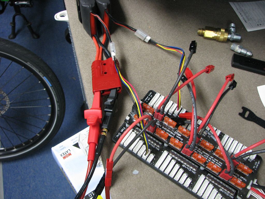

Re: kWeld - "Next level" DIY battery spot welder

I use the 120 Amp rated Anderson connectors and feed both Negs and Pos into one connector for each pair. Matching connector is on KWeld.

BVH   1 kW
Posts: 348
Joined: Mar 26 2009 10:59am
Post by BVH » May 14 2020 6:32pm
Here's a mock up of how I balance charge the 2P pack. Not shown, but obvious are the balance board input cables and balance cable which are connected to my FMA Dual PowerLab 8 .
It may look a little "Mickey" with the alligator clips but they are rated for 10 Amps and I charge at about 4-5 Amps. I did make and use an Anderson 120 Amp-to-Anderson standard connector adapter, just didn't get it out for the pic. It's a little more refined! Any multi-pak balance board will work fine. Since the packs are permanently Parallelled, they are always at the identical Voltage and they are balance charged to within about 3-5 Millivolts. I keep them at 3.75 Volts Per Cell storage charge when not using them. I charge the pack just before use and discharge (if necessary) right after use.

SubnetMask   1 mW
Posts: 17
Joined: Apr 17 2020 7:44pm
Post by SubnetMask » May 14 2020 10:05pm
BVH wrote:
May 14 2020 6:32pm
Looks like a pretty good setup (not judging the alligator clips as they look beefy and charging, you're not really typically pushing a crazy amount of current - for the initial charge of my new packs, I used MUCH less substantial clips and wires from the charger, but I was only charging at 1A), but just to throw it out there for anyone new that doesn't know, you need to be VERY careful about parallel charging like that - You need to be very aware of your pack and cell health. If you parallel charge multiple packs and one of them has a bad cell, the bad cell in that pack can wipe out the same cell in ALL connected packs.
