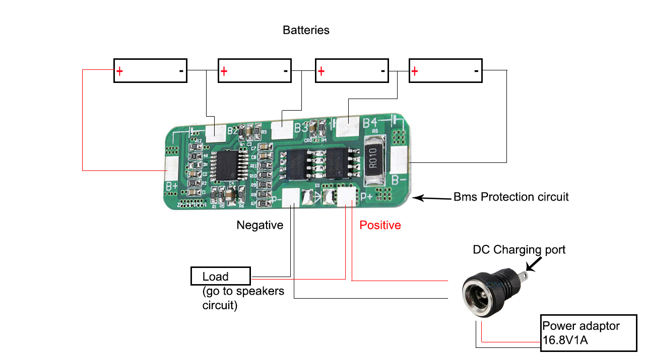

I'm building a bluetooth portable speaker.
However, I have some questions about building my first 18650 battery pack.
I have 4 pcs of Panasonic unprotected NCR18650B 18650 3.7V 3400mAh.
My goal is to build a 4s 18650 pack with these batteries, and the battery pack must:
- be inside the portable speaker
- Fully protected
- Safe
My question is, how do I design this battery pack?
I have a idea, but want to know if it is a good way to build it?(see the second picture)
I also have some others questions:
During my searches on internet some people use balanced charge, is it necessary to it use in my case?
If yes how? Do I need to use a power adapttor or lithium li-ion battery charger adaptor?
Thanks for your future help Cordially,

There has been much discussion over the years about how to run a pack (regardless of size) without a BMS. There have been many cases where a faulty BMS killed an expensive pack.
I am not going to say that this is a good idea, but many do it.
I suspect you want to avoid buying an expensive balancing RC charger. They are made to run off of a 12V car socket, but....since many charge at home too...they can take a higher input voltage in order to raise the max charging amps, and to also access a greater efficiency (higher volts allow lower amps, etc). Due to these reasons, they are often built to accept any input voltage from 10V to 30V DC. The well-regarded iCharger 106B is one option to compare others too (106 = 10A of max charge, up to 6-cells capable). If you want to charge with this unit at home, you will need to add a 120V-to-12V power supply (10-18V DC output at 10A max, for the 106B).
There is another route. You can create a gang-socket. Each end of the four cells has a wire going to the Gang-socket, for eight individual sockets (actually ten sockets, see below). A plug is configured so that it cannot be accidentally plugged-in backwards. When the "run" plug is inserted, the pack is configured as a 1P / 4S pack, and will provide an average of 3.6V X 4S = 14.4V. You must add two additional large sockets for the eight sockets to be connected to the "power out" cables.
When you want to charge, pull the run-plug, and insert the charge plug. This plug looks similar, but the butt-end of the pins are connected so that the pack is now a 1S / 4P unit, and can be charged with any 4.1V charger. Most chargers provide 4.2V when the pack is fully charged. Do NOT do that. Look for a "Li-Ion" charger that has a 4.1V setting. Put a resistor between each of the four cells on the charge plug. If not...a cell that is a little high will try to rapidly charge a cell that is a little low. (due to individual cell resistances, a pack that is at 3.7V will have some cells at 3.6V and others at 3.8V, this is the whole reason why "balancing" is needed).

What do you think if i put a balanced charger in the speaker,
does it possible the wires stay always connected to the charger and the speaker circuits?
Does it is necessary to have a bms for protect my batteries because they are unprotected?

A BMS should provide you with balancing, which would allow you to use a bulk charger, and the BMS would simply balance it if it saw any cell voltages differ from the others. You shouldn't need to use a specific balancing charger for this.

A little late but why couldn't a tool pack battery work. Like a 4ah ? Or a small bms off a tool pack. There should be many people on E.S. that have ten or more in a drawer. Look for somebody building packs out of tool packs. Aka Drbass or ?

The best replacement for a 12V lead-acid battery is often a 4S LiFePO4 pack, with added circuit-board protection when it comes to charge/dis-charge. You may have better luck looking into LiFePO4 components.

Which Bms can you advise me for charge my batteries pack?
