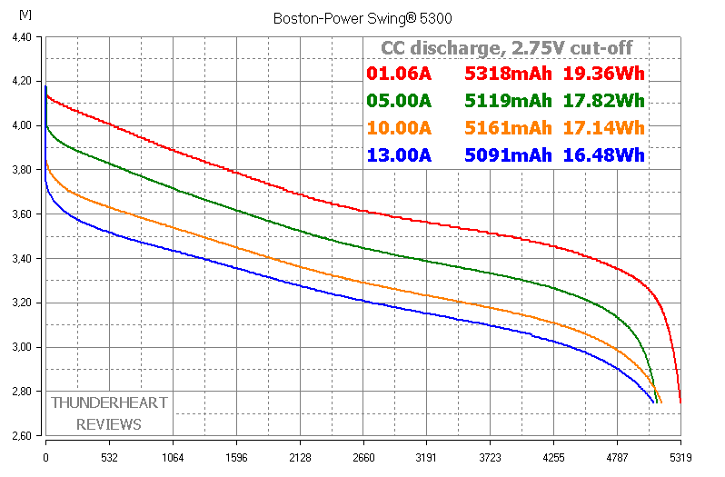

Hi guys!
I've got a Boston-Power Swing 5300 cell tested and want to share the results with you.

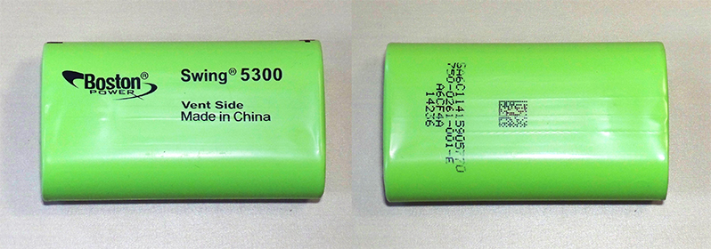

The Boston-Power Swing 5300 is a 3.65V Li-ion cell with a wide working temperature range (-40 to +70°C).

I've tested with ZKETECH EBC-A20 and a self-made battery holder. It's a PC-connected battery tester supporting 4-wire measuring and discharging at up to 20A.
I've tried to follow all the prescriptions of the IEC61960-2003 standard concerning battery's capacity measurement. Before each discharging cycle the battery was charged at 3.7A to 4.2V (cut-off at 0.1A, which is higher than 0.05A allowed by the manufacturer, but it's the lowest supported by EBC-A20). Before each discharging or charging i've held a 1-1.5hrs pause. The environment temperature was 21-23°C.
Discharge cut-off voltage was 2.75V in all cases. I've done a 0.2C (1.06A) discharging to check the nominal capacity, then I've discharged at 5.0 and 10.0A and finished with the max allowed continuous discharge current - 13A.
The results i've grouped together, so it must be easier to compare them.
As turned out, the battery is not overrated and at 0.2C it gives out 5318mAh - a lil bit more than the nominal capacity. The amount of energy is also slightly higher than the nominal - 19.36 vs 19.3Wh.
At 5.0A the capacity is lower than at 10.0A, but the amount of energy is higher. This is a normal thing, and the important one is the amount of energy.
At 13.0A the measured capacity was 5091mAh and the energy - 16.48Wh.
The results are good and not surprising for me. This is a high quality cell which can give out almost 5100mAh/16.5Wh at 13.0A. In some cases the prismatic form is preferable than cylindrical and i think it will help to build battery packs with higher energy density than in case of using 26650 cells with ~5000mAh capacity.

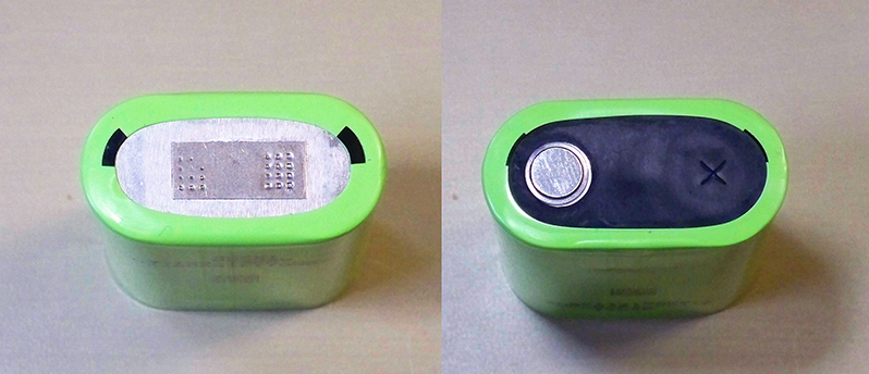

It still looks suspicously like a pair of 18650s assembled in parallel ?
Pull the shrinkwrap off and let us see what is inside . :wink:

Hillhater wrote:It still looks suspicously like a pair of 18650s assembled in parallel ?
According to your own posts and the image you linked in this thread from a few months ago:
https://endless-sphere.com/forums/viewt ... 14&t=89482
they're not. ;)
There's also an older thread
https://endless-sphere.com/forums/viewt ... 31&t=81815
that actually has a pic of one cut open

Yes , i have seen similiar "unrapped" pictures before, but even there it still looks "suspiciously like". A pair of 18650s in a metal case.!
But AW linked to a post with the can cut open to prove it is a single , oval wound, cell construction.
Its basic performance specs are not outstanding by current standards, but maybe it has some advantage in cycle life, safety, US availability, etc ?????

Nice to see they have 2 flat sides ! Makes the pack more energy dense per unit volume and also easier to liquid cool !
Also the vent notch on side is a cool safety feature, at least the sidewall failure location is predictable. But the inside visible in this post :

Post by hemo » Oct 17 2017 1:24pm
The cells are hard to tab weld and the ends are as hard as nails apparently. They were conceived to work with a modular set up/connection, which I believe in themselves are not cheap to buy.
Jimmy the boss at Insat Intl/ BGA Reworking in North London has boxes and boxes of these in his work space, and tab welds using copper. His normal industrial spot welder couldn't manage decent welds to the Boston's, so in order to accomplish this he said his new state of the art welder cost about 30k sterling.
Might be interesting to see if any one buys these and whether they are able to manage welding them or not.

Here's the best video showing the insides of the Boston Power style of cells, with the insides being "oval" wound, instead of cylindrical. Fast forward to the 9:44 mark...
https://youtu.be/TNk0bouiPDQ?t=586

Excellent review here on this battery. Has anyone since tried welding any of these? I corresponded with the gent who did that review on Youtube and was told problem soldering them just like 18650s ...so I would think they could be spot welded just as easily.

Yes they could be easily spot welded by cheap Chinese welders as for example LG HG2 cells.

Pajda wrote:
Mar 10 2018 4:57pm
Yes they could be easily spot welded ......
...... Their housing is made from aluminium as on most 18650 cells.
:shock: Every 18650 i have seen had a steel case ....(magnetic) !.

You are right that 18650 cells are in steel cese. I found one datasheet for Boston Swing 5300 with info that their casing is made from aluminium. But I did not checked that. Anyway I have no problem with welding nickel tabs on Swing 5300 with the same setting as on 18650 cells.
