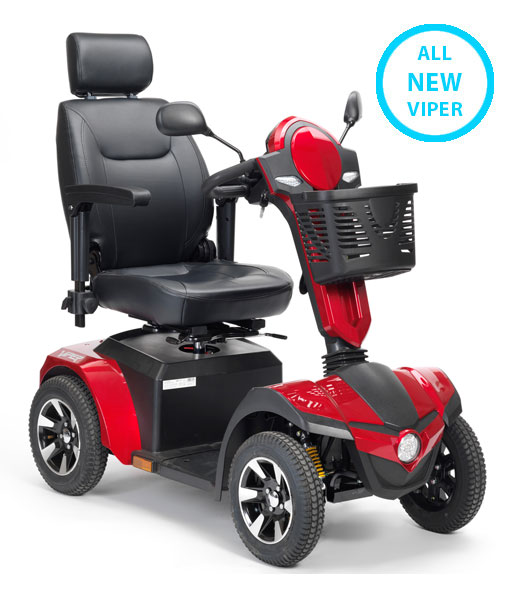

I think you might be thinking of the wrong type of scooter. Try one of these:
Same concept though :p
