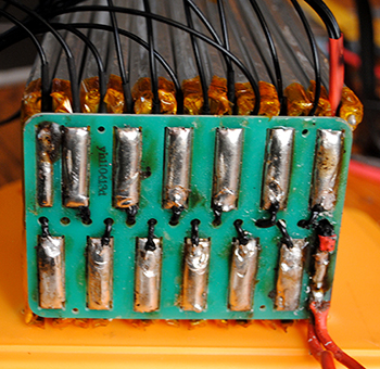

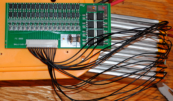

OK, I pre-tinned the leads and soldered them to the top, going one by one:
However... (sigh, why do I always have to use that word!), there seems to be a problem. When I hooked up the wires to the BMS, one of the lights is not working:
I took a third look at the boards and the wiring seems to be correct:
The one thing of note is that the "red wire" went to B13 on the old board. It now goes to B13 - B16 on the new board. Did I mess up somewhere or is this correct?
BTW, if any thinks that they can repair my old board, PM me and I'll ship it to you. It has a blown out trace on it, but if you have the skills, I would rather give it away than toss it:

Re: looking for recommendations for BMS upgrade
Post by fechter » Dec 19, 2017 2:28 pm
Your new board might be OK. The lights only come on when the balancing shunts are active. Normally, there would be no lights on when the pack is in standby. Toward end of charge, there may be several lights on but not necessarily all of them. Check the cell voltage on the one with no light, it may be just out of balance enough so that one is lower than the others. The board balances very slowly, so if you have a low cell, it would be faster to individually charge that cell to bring it up with the others.
Your connections sound OK.
Post by zogthegreat » Dec 19, 2017 6:57 pm
How should I test? I measured complete pack voltage and I got 47.5v. I then measured terminal to terminal, walking down:
and I got 3.6v on each. The math seems right, but when I hook the BMS back up, I still have a light out on #D16.
(EDIT) Just to mention, #'s D1, D2 and D3 also don't light up. These are the ones that are linked with D4 to the red connection.

Post by fechter » Dec 20, 2017 1:05 am
If you leave it connected long enough, all the lights should go out. At that point measure the individual cell voltages again.
It sounds like it's working correctly. The lights only come on when the cell voltages are higher than the set point.

Post by zogthegreat » Dec 21, 2017 9:59 am
OK, so I finished wiring up everything last night. I put it out on my BBQ and plugged it in, (paranoia can be healthy at time! :wink: ), and left it for the night.
This morning the light on the charger was green and I started testing the packs and I got the following:
The strange thing is that although the sum on the individual readings equals 57.1v, when I measure the entire pack, I get 53.9v. I have remeasured twice and I get the same results.
The lights have stayed on after charging. D1, D2, D3 and D16 have stayed off.

Post by GalFisk » Dec 21, 2017 1:55 pm
Um... did you charge LiFePO4 to 4.1V per cell? That chemistry should not go above 3.65V per cell.

Post by zogthegreat » Dec 21, 2017 9:14 pm
So I drained the battery pack down to 50.5v and hooked it up to the charger. When it was finished charging, I remeasured and got the same results, cells 10, 11 and 12 showing 4.0v and all the rest showing 4.1v.
The BMS is also still showing red lights on D4 through D15, with D1, D2, D3 and D16 off.

Post by zogthegreat » Dec 21, 2017 9:36 pm
I went back to the sellers eBay page and reread the instructions and I noticed this:
I don't have anything connected to the part that says "C- charge or discharge negative" "D- only as discharge negative". Is this where I should be connecting the charger? The original BMS was connected directly to the battery, so I went with what the original connections were. Did I make a noob mistake? Should I be connecting my charging neg to the C- charge or discharge negative"?
Here is the rest of the technical information:
"First 16 cells in series. If there are 32, you can be connected in parallel, and then series connection.
B-negative connection in accordance with the battery pack, followed by B1 + B2 + B3 + ... .. B14 + B15 + B16 +

To answer my own question, yeah, I did do a dumb arsed noob mistake. I went back and checked the pictures I took before and I noticed that there were neg wires on the BMS go to the battery:
I'm going to drain the pack down to about 46v, hopefully I didn't screw anything up. Is there anyone who can guide me through connecting the BMS properly?

Post by zogthegreat » Dec 22, 2017 3:00 am
OK, I think I have this figured out:
The positive from the charger goes to the battery positive, which loops back to B16 via the connector wires as per OEM's diagram. B16, B15, B14 and B13 connect to the battery positive. All of the other connections go to the battery in sequence.
The charger negative connects to the "C-" on the BMS. The B- on the BMS connects to the battery negative.
I haven't figured out "D-", I'm hoping that someone can enlighten me! ;)

Post by GalFisk » Dec 22, 2017 6:23 am
zogthegreat wrote:
Dec 21, 2017 6:51 pm
999zip999 wrote:
Dec 21, 2017 10:46 am
Put a load onit dran it down a little and recharge. A light bulb will work.
LOL, I only have 12v lights in my RV. I made a loop with a controller and a motor, then taped the throttle open about 15% to drain the battery. I'll take it down to about 50 - 51v and then try charging it again.
I'm using the charger that came with the batteries, so I'm assuming that it's the correct voltage for these batteries.
The seller avertised Li-ion but you got LiFePO4. The seller said 48V, but 13S LiFePO4 is 36V. The BMS was fried.
I think either this seller or the previous seller fried the thing with the wrong charger, and now you're doing it again.
LiFePO4 doesn't swell and catch fire when overcharged, but it still takes damage.

Post by zogthegreat » Dec 22, 2017 8:57 am
Man I really want to use profanity right now! What do you think is my best course of action now? I'm a noob when it comes to lithium batteries, I've been using SLA's up to now.
The charger matches the charging port on the case. Here is the link to the battery on sun-ebike.com:

I hooked up everything according to the schematic that I made and all of the light come on now. :D :D
This just leaves "D-". On the original BMS, "D-" went to the key switch:
It's hard to see on the picture, but the black lead from "D-" is spliced into the red wire going to the key switch. Since I'm planning to reuse the key switch with the battery, I'm going to connect it there unless someone thinks that's a bad idea. On the schematic provided by the seller it says "D-" is "only as discharge negative". I don't have enough experience with these batteries to know what that means.

Post by amberwolf » Jan 12, 2018 2:20 am
zogthegreat wrote:
Jan 11, 2018 10:52 pm
It means that if you use that to power the controller from, it will shut off power to the motor when the battery runs low (hits LVC), but that it doesnt' do anything to protect the battery if you tried charging thru it.
The C- (according to it's name) will protect both charge and discharge.
You'd use the charge/discharge (C-) to charge thru, regardless of which one (D- or C-) you run the controller from.
