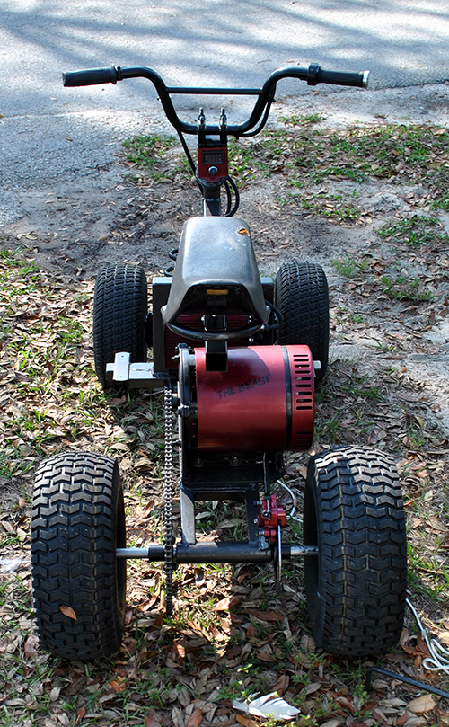

Good point! Here's what I'm working with, (and I will say "NO!" in advanced to the questions regarding if I am under the care of a mental health expert! ;) ).

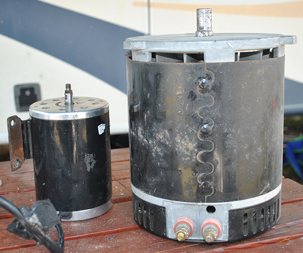

So the motor is an Imperial Electric P66LR006 industrial permanent magnet motor, rated at 36v that I have been running at 48v on my, (heavily), modified Razor Dirt Quad:
This is the motor next to a 36v 1000w Unite. The motor weighs in at 54 lbs and has an internal fan, so over heating at the higher voltage isn't a problem.

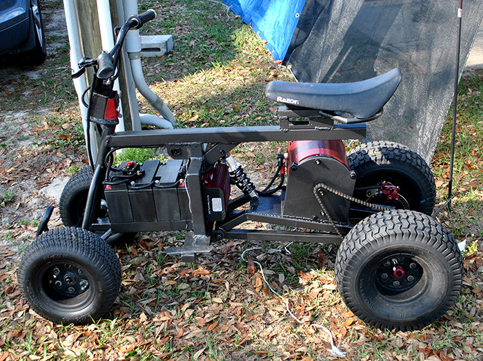

As I said, I had it on a modded dirt quad:
I had to rebuild the rear swing arm to fit the motor. I called the build "The Beast" because of the motor. The problem with it was a combination of a huge amount of torque and the center of gravity being to high, giving it some nasty handling, even on straight roads. I was using a Kelly KDZ48200 for the controller and 4 x 12v 18ah SLA's for the battery pack.
I was looking for a go kart frame to put the motor on when I found this mini bike chopper at a flea market:
It originally had a 5 hp gas motor on it that the seller wanted $125.00 for. I told him that I didn't want the motor and he let me have the frame for $40.00
My initial plan was just to swap everything from the quad, but one of the 12v 18ah SLA's went bad and while perusing eBay for some new SLA's, I came across the LI-Ion pack that I will be receiving on Monday.
I was just realized that the motor is 9.5 hp, not kw, ( :roll: What did the Scarecrow say, "If I only had a brain!")! I had no problems running it on the previous battery pack, (the battery that went bad was due to my not storing it properly before doing a 1500 mile trip from Montreal to Florida).

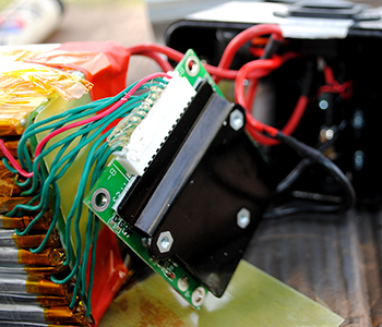

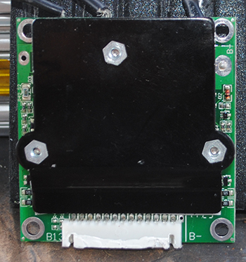

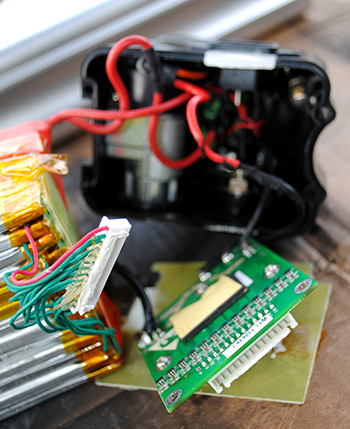

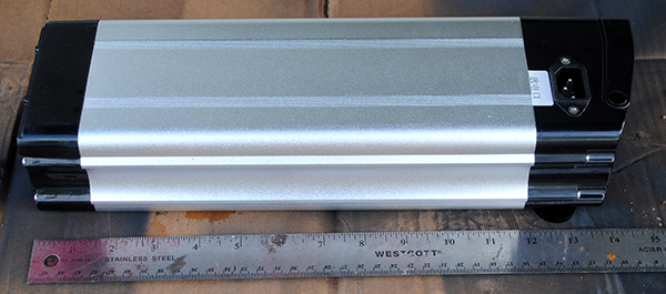

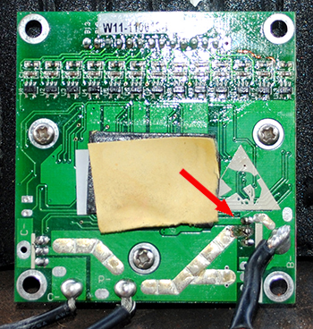

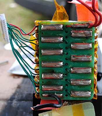

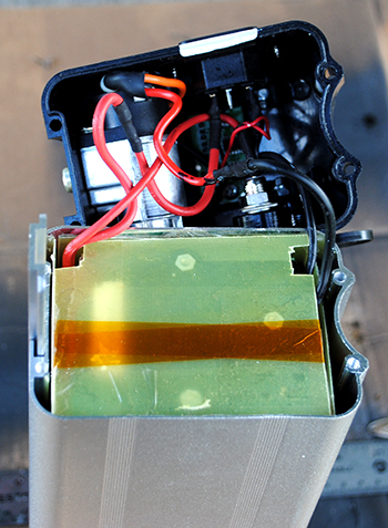

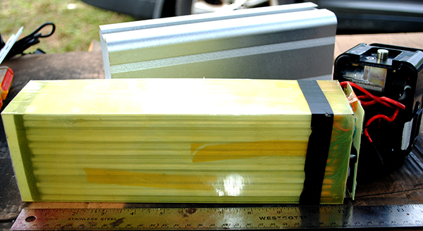

Well, it looks like I was a good boy this year, because Santa, (i.e. USPS), brought me my toys early! Here's what I got:
Here,s the top of the battery:

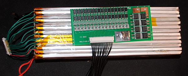

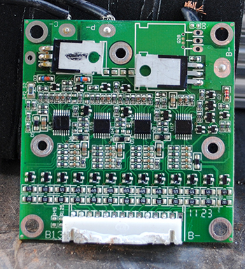

The BMS:
There appears to be a short in the BMS, (as the seller stated in the auction):

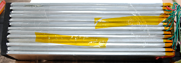

To my surprise, this battery appears to be made of 3.2v LIFEPO4 cells instead of Li_Ion's that the seller advertised. I'm not complaing, I just was expecting round cells, (Sigh, backto the drawing board on my plans! ;) ).

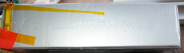

There is writing on the side that reads:
HY11F14
104111E28
HPPN7070260 - 12AH
OK, now that I know what I'm working with, what would be my best choice for a replacement BMS? Also, is it possible to add more cells to increase the ah's? I think that I already know the answer to this question, but I'll ask it anyway, if I can add batteries to increase the ah's, can I use round cells, or do they have to be flat cells?
Thanks!

fechter
Posts: 12446
Joined: Dec 31, 2006 3:23 pm
Re: looking for recommendations for BMS upgrade
Post by fechter » Nov 12, 2017 12:23 pm
So it looks like a 13s, 12Ahr LiFePO4 pack. A quick search on eBay didn't come up with any 13s boards, but there are plenty of 16s versions, which should work if the unused channels are tied together at the positive end.
example: https://www.ebay.com/itm/48V-30A-LiFePo ... SwaGFZcLww
BesTech Power will likely have a 13s somewhere.
You may be able to fix the blown BMS if just the FET is bad.
That pack will be able to run about 20A. Not nearly enough for "the Beast".
Yes, you can add more cells in parallel to increase capacity. Shape doesn't matter, but chemistry does. A123 cells are the same chemistry, but generally good at much higher discharge rates than the generic Chinese LiFePO4 cells.

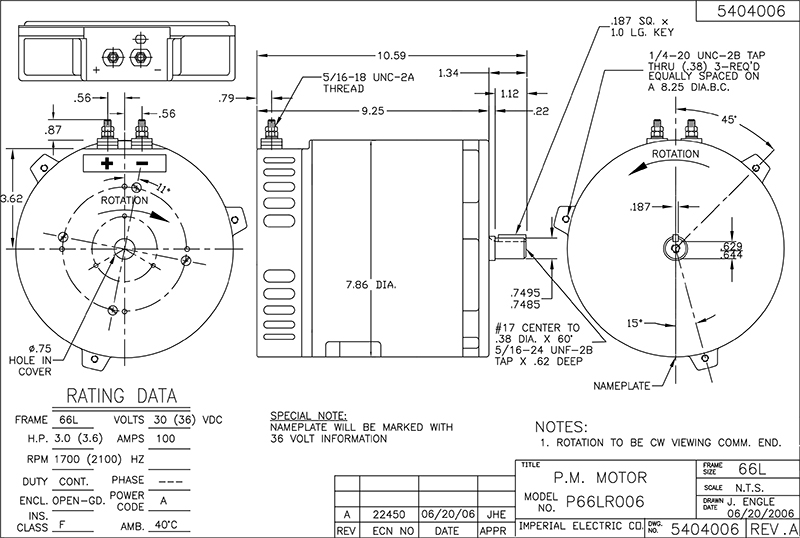

BTW, here is the spec sheet on the Imperial Electric P66LR006:
Maybe I'm wrong about it and the batteries will work? (He says hopefully!)
Hmm, I just realized that it's 3 hp?!?! Not sure why I thought that it was 9.5. (I've done so many project that they seem to blur sometimes! :lol: )

It looks like it's rated as a 100A motor.
If the controller you're using with it is also rated at 100A motor output, (at least 100A battery input), then the battery has to be rated to output at least that amount of current (and with cheap batteries, I'd get one rated for twice that so voltage sag wouldn't be so horrible, and cycle life would be longer).
At 48V, then depending on voltage drop under load, it's around 4800W or higher.
Now, whether you'll actually be using that much power depends on how it's geared to reach the road, and how fast you're going and whetehr there are hills, headwinds, etc.
But on accelration from a stop, it's likely to take the full power it's capable of if you use full throttle, for at least part of that acceleration up to cruising speed.

fechter wrote:So it looks like a 13s, 12Ahr LiFePO4 pack. A quick search on eBay didn't come up with any 13s boards, but there are plenty of 16s versions, which should work if the unused channels are tied together at the positive end.
I found these on the BesTech site:
http://www.bestechpower.com/416v13spcmb ... -D245.html
http://www.bestechpower.com/416v13spcmb ... -D205.html
I like the 16S one from eBay, I can always try to reuse it after these cells reach end of their life, (if I don't fry them first! :roll: ), and build a larger pack with it. However, since I'm a total noob to these, I will ask more experienced and knowledgeable people which board they would choose, (and why!)
fechter wrote: You may be able to fix the blown BMS if just the FET is bad.
I took a second look at the board and I'm not sure if it can be repaired. You can't see it on the pic, but the circuit path on the board is missing about 1.5 mm of material and the board looks like it's burnt underneath it. Since I don't know what caused it to fry in the first place, I really don't want to risk the batteries when a new board is cheap.

I found another thread about this project tht says you've got a Kelly KDZ48200
http://kellycontroller.com/kdz4820024v- ... p-951.html
whcih means that unless you change it in it's programming, it will allow 200A if the motor asks for it (which it can at startup from a stop, or in stall conditions, even as a 100A motor), for up to a minute. Continuous it'll allow 80A.
But it is programmable, if you have the stuff to do it (if not, ask Kelly about that)

amberwolf wrote: But it is programmable, if you have the stuff to do it (if not, ask Kelly about that)
Yeah, I was thinking about that and I checked the programming software and while it will allow you to adjust the voltage, it doesn't allow you to play with the amps. :(

zogthegreat wrote:Yeah, I was thinking about that and I checked the programming software and while it will allow you to adjust the voltage, it doesn't allow you to play with the amps. :(
It does show a Max Motor Current, and a Max Battery current--are those not adjustable?
(if you don't have it connected to the controller, it might nto allow adjustment of things until it can talk to it).
If it's not directly adjustable, you could use it in "reverse mode", swapping the two wires from motor to controller so the mtoro still runs forward, and then enable the half-current option. That'd get you down to 40A continuous and 100A peak, at least. ;)

So, after 2 bleeping months, I finally received my new BMS:
I really don't recommend the seller that I got the BMS from, 2 months is somewhat excessive, IMO. I will list him in the for sale section so people know to avoid him.
So, now the question is how to hook it up to my battery. Do I connect the wires one for one, starting with the red one on from my old BMS? I seem to remember someone mentioning that I needed to hook the spare wires to the red wire, but I can't find the post.
Thanks!

Yes, connect the balance wires in sequence starting at the negative end then tie the extra unused wires to the battery positive. Be very careful to keep the wires in correct order or you can blow things up. I always try to connect the main plug at a slight angle so the negative end makes contact first. Make the B+ connection last
