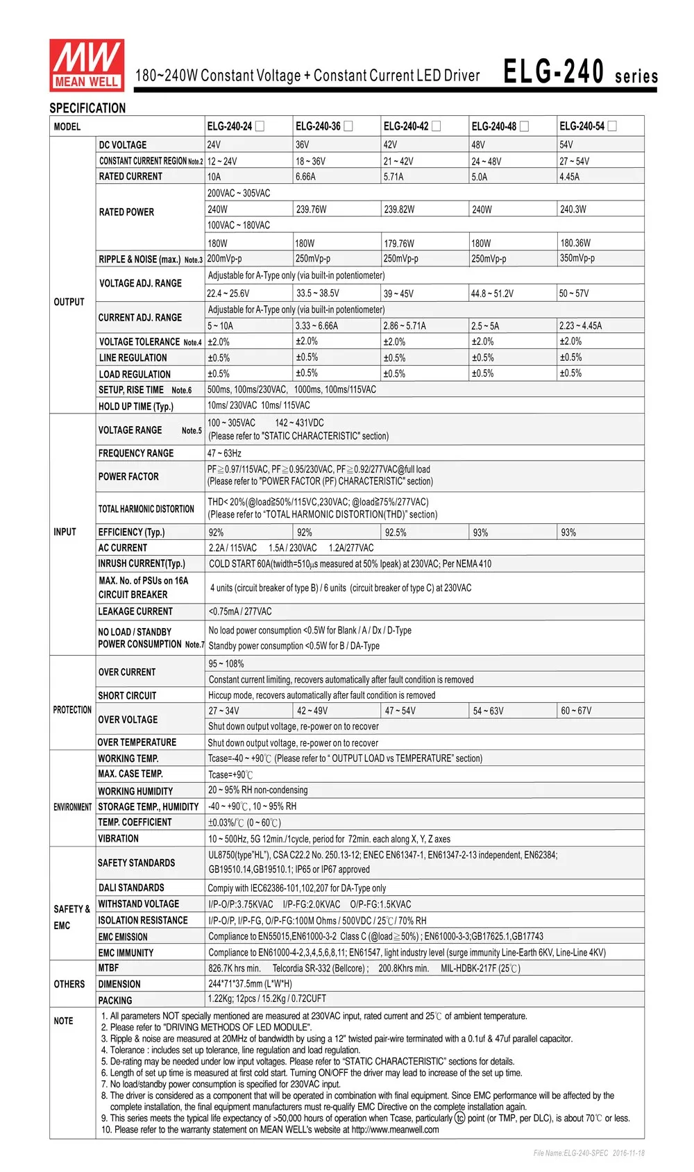

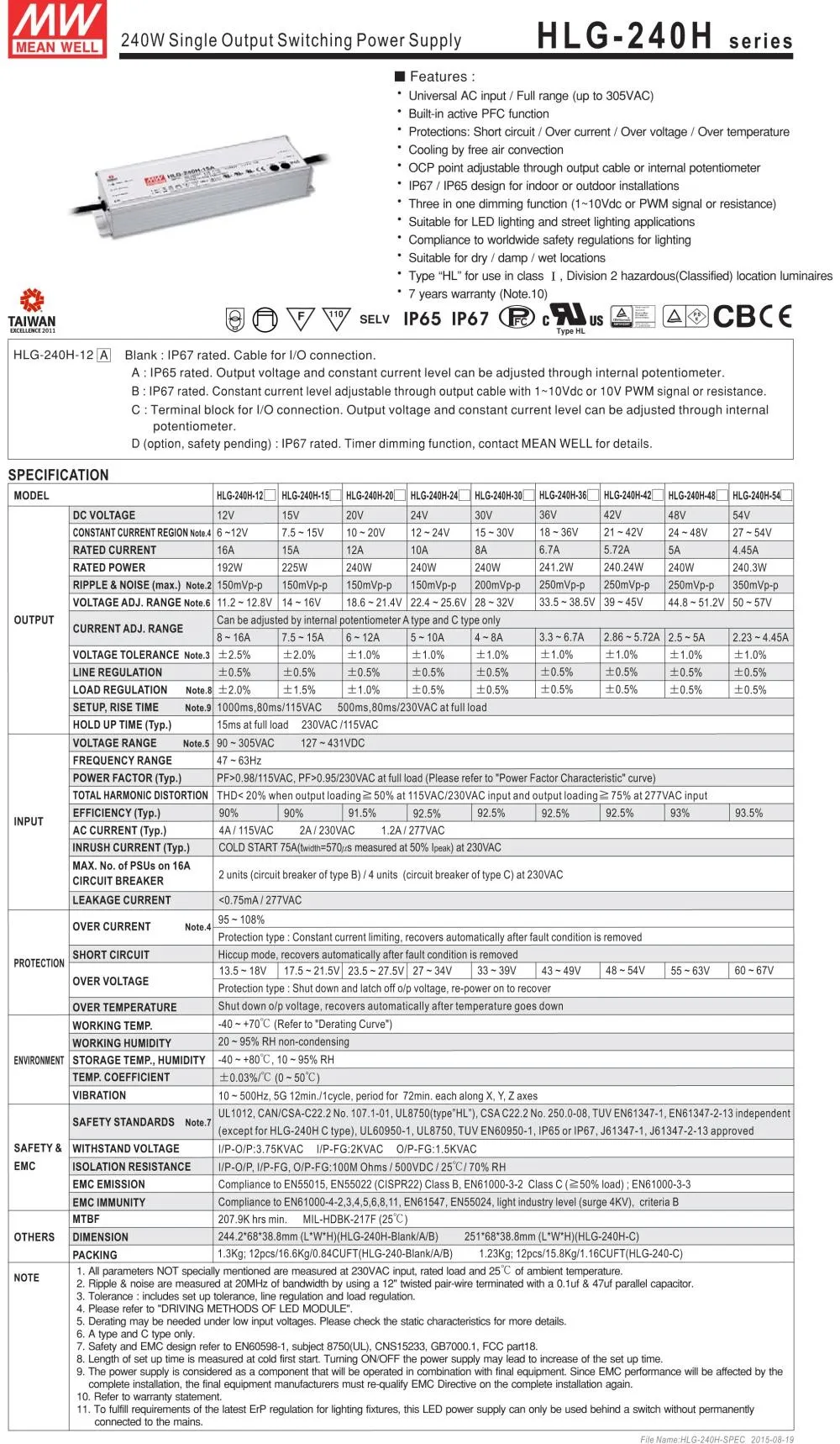

ELG-240-54A
vs
HLG-240H-54A
for charging 13s packs 13*4.2 = 54.6
they seem to have the same specs but ELG has the adj pots at the back. HLG has them in front. and their metal cases are different
ELG is cheaper
any other differences i've missed?

The ELG has a reduction in output power when on 120vac input. 240->180. The HLG does not say that.

"Derating may be required under low input voltages".
I wouldnt count on the HLG holding up equally on 110v, especially since it also says:
"All parameters [...] measured at 230vac"

Well, I have the HLG-600-54A here, and use one on the trike to charge to nearly 58V, starting off at 12A when the pack is low enough (around 54V, IIRC) running off 115VAC. So around 600-650W, which is what it's basically rated for. I've run thepack down to near empty a few times, and the HLG sustains that current fine until the pack is charged enough to slow current input down.
So I guess that means the HLG's *should* work at their rated wattage with either 115VAC or 230VAC input (I haven't actually tested mine on anything but 115VAC, but I could make an adapter cord to run off the welder plug to do so, I suppose).

Yeah. Reading a bit more, it seems even the ELGs hold up under full load on 110v, no derating required.
Someone on another forum pointed out that ELGs have a 5 year warranty vs the HLG's 7 year. Also mentioned that each HLG was QA'ed manually, where as ELGs were machine tested. That one I found a bit odd. Take it with a grain of salt.

ELG uses a bit cheaper components and less pfc stuff on the input side. Also uses a cheaper case.
Becayse they use slighty different components there is also a different (smaller) voltage range. It is small but it can be a big issue if you are on the edge.
So far of all the mean wells i use(d) only one ELG died on me.
Once i tool a HLG apart and after a LOT of digging i did find a couple of witness marks of manual QC so the above mentioned migt be true. I still have the dead ELG so i might judt want to take it apart as well and see if there are any manual QC marks or test pads.

The HLG is IP67 rated, which means you can use it in the rain (water resistant). Not sure about the ELG. Otherwise, the specs look the same and both look like they should work fine.
