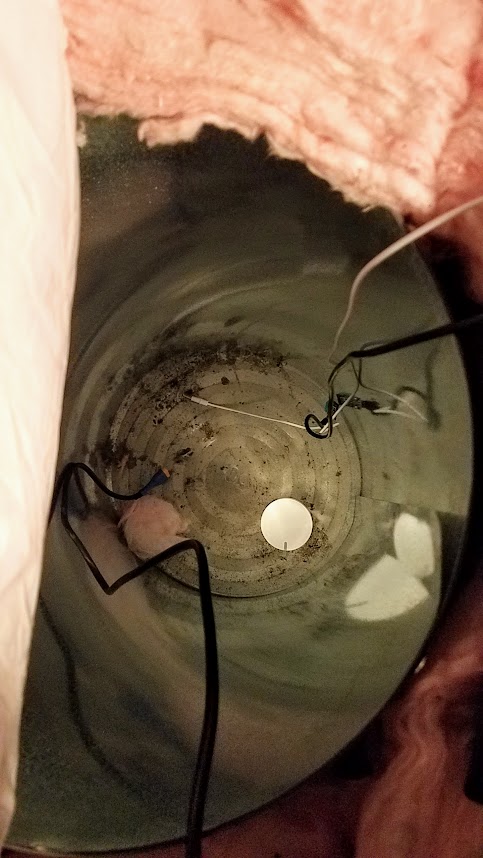

I have an unheated, detached garage where I store my ebikes and I have been wanting to build an insulated, heated, fireproof-ish, charging solution that I can use in that garage.
Sort of like a reverse refrigerator with a charger inside.
So here's what I built and plan to test in the upcoming months:
I picked up an old school galvanized garbage can at Home Despot:
Some pink insulation:
a roll of metal sheeting and a heating blanket:
I placed a layer of insulation at the bottom of the can.
Placed a metal plate on top of that and rolled the blanket around the metal sheeting and placed that on the metal plate.
I then insulated the remaining gap and made an insulation bag cover to put on top but under the lid.
And voila! An insulated, heated, fireproof-ish, charging station:
I also wanted to insure that the battery doesn't charge below freezing, in case the heating blanket fails or can't keep up with the cold, and that the heater doesn't overheat the battery on warmer days.
So I used an Arduino that I had laying around and hooked it up to a DHT11 temperature sensor and a relay board to control the heater and charger separately based on temp.
The logic goes as folllows:
If Temp <3C/35F: Turn off charger and turn on heater.
If 3C/35F<Temp <15C/65F: Turn on charger and turn on heater.
If 15C/65F<Temp <45C/110F: Turn on charger and turn off heater.
If Temp> 45C/110F: Turn off charger and turn off heater.
Also added an I2C 2x16 diplay for info.

Note the ambiguous ONF setting (a bug)
Here it is in the garage with the DHT11 sensor in the garbage can..ahem, I mean, in the temperature-controlled charging system:
For remote monitoring, I placed one of my Notion sensors that is part of my wireless home monitoring system, at the bottom of the can.
I can use the puck to monitor temperature, sound (detect smoke alarms), water and motion (for doors and windows) and send alerts to my phone. https://getnotion.com/
I tested the heater yesterday in 10C/50F weather and it performed well.
But might need to add another 60W heating blanket in February when it hits -20C/5F.
Here's a screenshot of the Notion app showing the internal temp of the unit rising after I turned the system on:
So tell me what could go wrong?

I'd be surprised if you need an extra heating blanket if it's used indoors (garage/workshop) as the volume is pretty small and well insulated. If it doesn't hold temperature.
Re: A solution to charging Li-ion in freezing weather: Testing an outdoor temperature-controlled charging system.
Posted: Oct 26 2018 4:01pm
by LuboN
If the battery is frozen, it will take some time to warm up to its core. Because You don´t have temperature sensor inside the battery, the easiest way to sort this out is to delay the charging after the temperature inside the chamber reaches "warm enough". The delay should be longer if the initial temperature was lower and vice versa.

That's a very good point although I don't plan to ever leave it in below freezing temperature. I could have another probe inside to double check in case it was left in a freezing environment for too long.
Re: A solution to charging Li-ion in winter freezing weather: Testing an outdoor temperature-controlled charging system.
Posted: Jan 29 2019 9:07am
by SamRich
Just wanted to follow-up after using it for a few months. I has been working great with outdoor temps nearing 10F (-15C).
It's stays pretty solid at 9- 11C (50F). Drops a bit when really cold. Here's the internal temp of the last month.
And here's the temp of in my detached garage:
