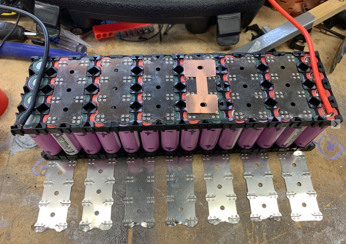

This is my first battery build and I'm a little nervous. I *think* it's all setup correctly.
14s4p 30Q using .2 nickel plates with premade weld dimples. These will function as parallel and series connection (except the first and last ones where I'll just use a single strip of nickel) My welder handles these without any problem.

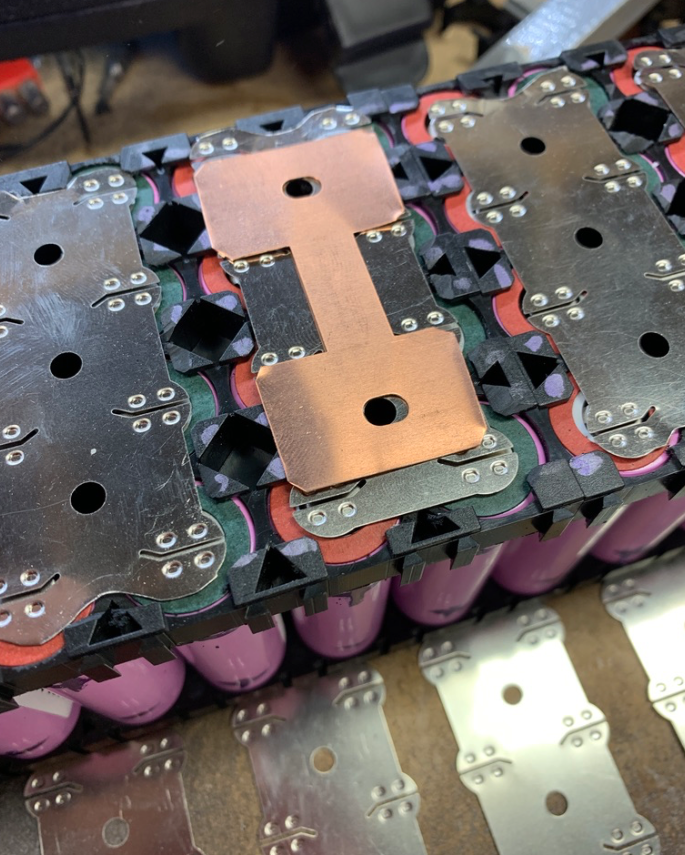

Just want to make sure I have all the (+) and (-) set up correctly. If I need more series connection I could solder some copper across like in the 2nd picture or just weld some more nickel. This will be for a generic 1000w rear hub bike.
Any input is appreciated...

Rich,
Looks good to me. Like the custom nickel strips. How much amperage are you planning on pulling out of this pack?
Personally I just use round 10g copper wire for current share, yours looks better though.

Thanks, good to hear.
The controller is 30a and I'm going to be doing a lot of pedaling.
I got those nickel strips on a whim... I tested them and they are pure nickel (and everything else I've gotten from this seller). I did have to modify the standard cell holders by dremeling/filing out some of the plastic so they will lay nice and flat.

For the end collectors, you could cut one of the nickel sheets in half lengthwise and solder a heavy copper (10ga) wire across it. I like to avoid soldering heavy wire directly to the cells. You could bend the sheet so the wire sits above the plane of the cell tops if that fits your enclosure better.
Otherwise looks good.

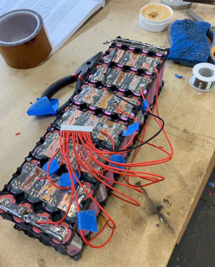

An update on my first battery build.
Before I welded it I soldered some copper bridges across the nickel (left a bunch of blobs because I wasn't sure where the BMS wires would come in) and added a 12g copper wire at each (+) and (-). Did all the spot welding tonight. Connected the BMS and soldered up the mains. All voltages where they should be and all the smoke stayed inside (so far).
After planning this all out I got to a point where I wasn't sure what end result I wanted for wire management so I'm just winging it and getting it built. It's been fun.

Careful of that near short on the positive end. Might just be the angle of the photo but it looks very close. If I feel uncertain about the way wiring sits, i imagine how its going to be/look after being ridden down dirt roads and bashed around for 10000+ cycles.
I'd change that before you go any further. Yeah looking more closely at that-its dodgy.. Fix it now while it's still open :wink: :flame:
Yes, thanks I will fix that.
