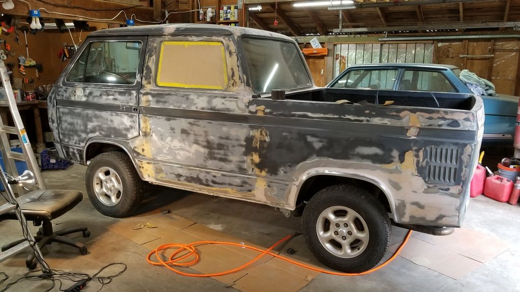

A few years ago I 'chopped' my VW van and made it into a DOKA (German for 'double cab' pick-up). 97% of the people who see it say "effing cool!" with the remaining 3% saying "if you wanted a DOKA so bad why didn't you just go out an buy one?"
If I had the time and resources I'd do it again! (In fact I might try to make a business out of doing the conversions?)

By the way Vanomo is almost ready for paint after spending the past few months of intense bodywork.
