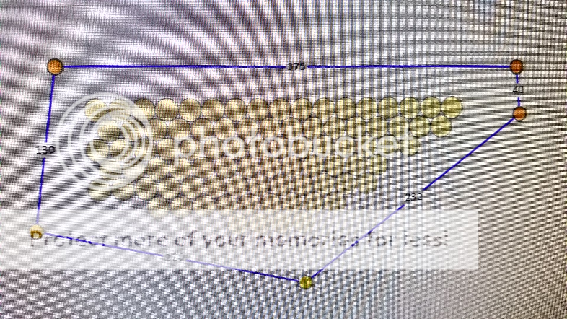

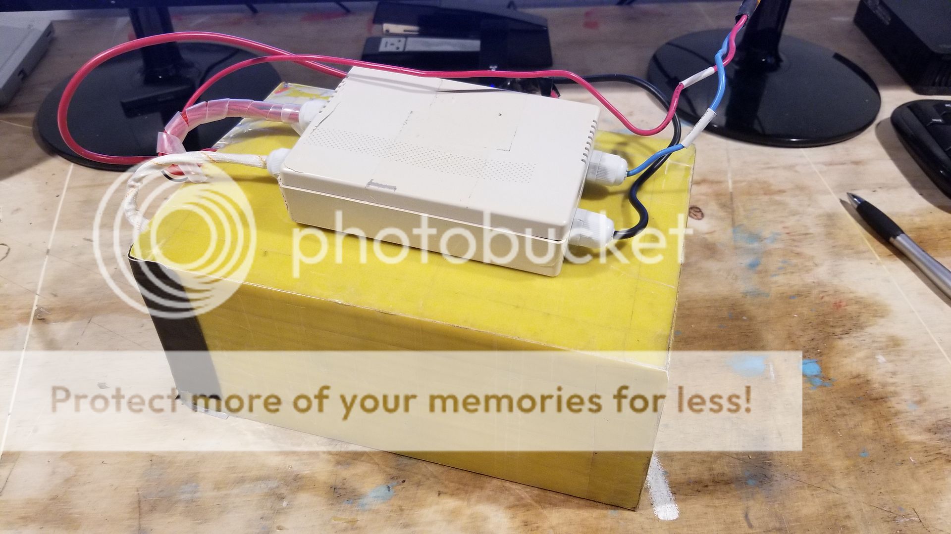

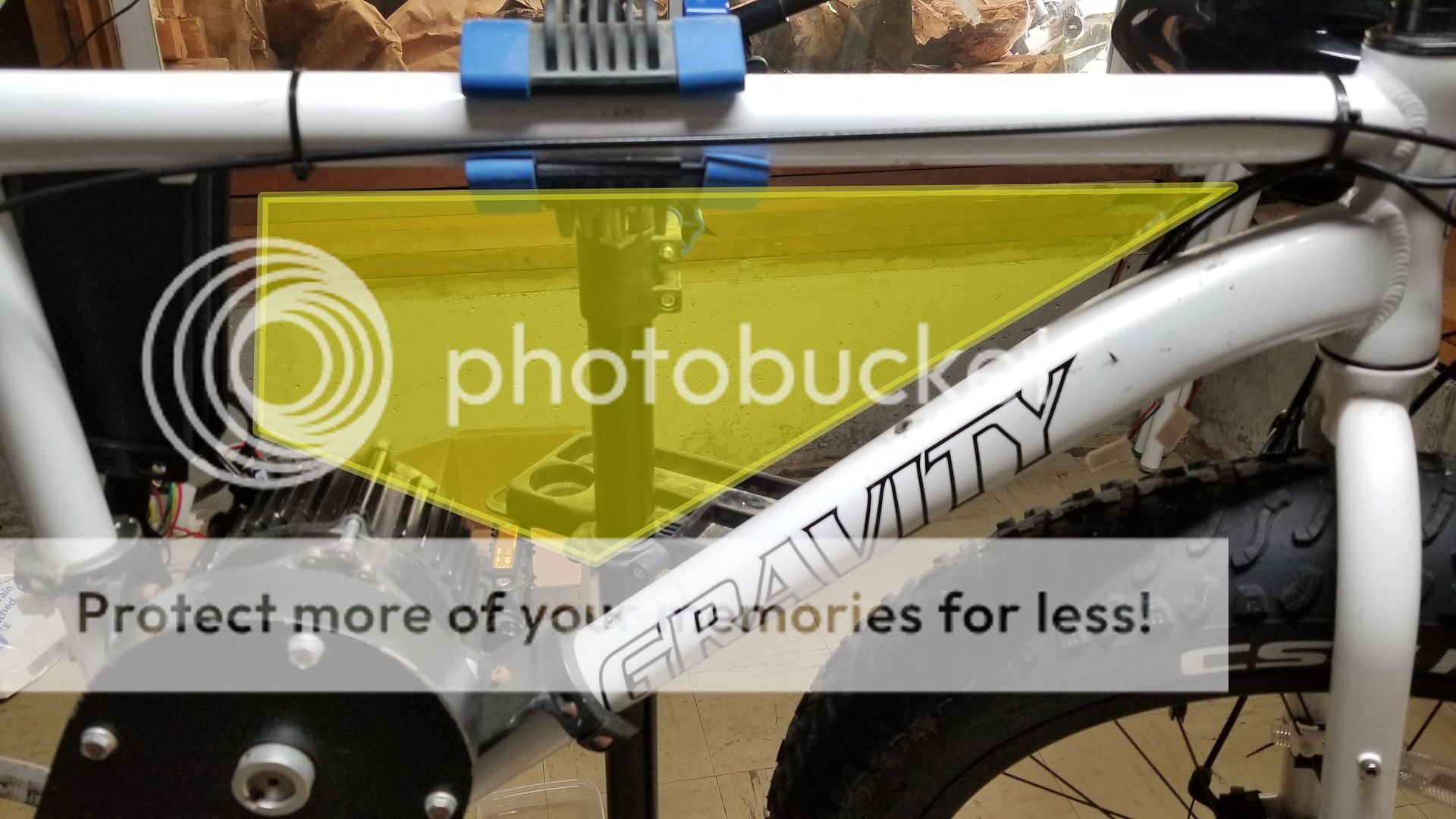

So after taking a few months off for other projects I finally got around to figuring out just how much space I have above the mid-drive Cyclone motor (mounted above the bottom bracket) in my Gravity fatty. I had ordered these two big, heavy 48v/20ah battery packs off Risun Motor in China for powering my fat tire bikes. I don't know why I assumed they were some configuration of 18650s. They're not! What they are, are 16 Lithium Ion pouch cells roughly 10"x7" stacked on top each other forming a 'brick'.
Image I put each brick in a rigid case/bag and strapped each on seat post racks on the bikes. While that works ok with my girlfriend's bike for cruising up and down the beach, it's no fun at all on my fatty for taking on the back trails through the dunes.
This thread began when I had the crazy idea of scavenging the 18650s that I assumed these 'bricks' were made up of and building my own custom pack to fit in the triangle of my Gravity.
I'm relatively adept at building stuff and a housing would seem to give me enough room for lots of 18650s in just about any configuration I want. So I went to the Russian battery building website and gave them the rough dimensions of the space available.
Remember I'm shooting for 72volts (that's what the Cyclone 3k can handle) and maybe 12ah? I could easily get 50% more cells in this space. So give me reasonable numbers here. Budget for the cells about $500 (less? :-))
This bike has a 3-speed IGH on the rear and I rarely go above 500 watts although I've pulled as much as 1,800 if the CA is to be believed. And I just like the idea of a full 3,000 watts for the rare times when I want to power straight up a hard-packed dune face. So assuming I find the right BMS, what are the appropriate 18650 'S' and 'P' numbers for something that can put 72 volts to the motor for maybe an occasional 30-sec hi load burst but more normally operate at loafing along speeds?
And what 18650 chemistry (make and model) is preferred these days?

okay, I'm a big dumb ass. Those big pouch batteries were LiFePO4 things that prolly were listed in the catalogue as scooter batteries and actually the thing isn't that big of a deal on a beach fatty. lots of weight but a fair amount of power for not a lot of money. But now I'm gonna build a proper custom 18650 battery so previous questions still apply?

Yes, that style is known as "prismatic", soft pouches internally, but shipped sealed up in a hard case with easy bolt terminals.
Can be one LFP cell per big block, so 3.3V nominal at say 40Ah up to thousands of Ah, obviously those need a forklift to install.
Huge advantage in only one or two series needed to get to target Ah capacity, fewer interconnects and can just use marine battery cabling with crimped ring terminals, super easy to break out the pack for maintenance cell testing / re-balancing, replacing faulty units etc.
But the larger size can make that style inconvenient to fit for many bikes.

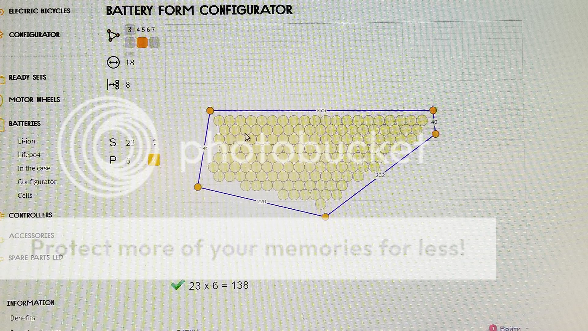

I don't want LFP! (I don't think) I want 18650 form. According to the battery design site I could squeeze a custom made box in there that would accommodate 138 cells in a 23s6p configuration. I don't think I need 23 cells in series (23x3.7=85volts) to get 72volts and 6p sounds like lotsa amp hours. or do I have this all wrong? Image

mammonista wrote:I don't think I need 23 cells in series (23x3.7=85volts) to get 72volts and 6p sounds like lotsa amp hours. or do I have this all wrong?
As I said, 20S is the norm for "nominal" 72V with non-LFP, as in NMC, LCO, LMN, NMA.
The more Ah the better, lower C-rate and DoD gives better longevity.

It goes like this: If you want a 72v battery pack, then take the 72v and divide it by 3.6v (72/3.6= 20 cells) However since these cells charge to 4.2v when totally charged you will need a battery charger that can charge to 84v if you want to fully charge these cells. (20x4.2=84)
Ok, so as stated above, 20 3.6v 18650 cells is normal for 72v. But each of these PF cells has a limit of how many amps it can deliver. It happens to be 10A continuous according to the specs. So if you have a 20s 1p pack (a total of 20 cells) then you could run at 72v but no more then 10A or you might over heat the cells and cause a fire. So say you want to run a 30A controller, then you have to go with a 3p arrangement which would be 60 cells. (20s x 3p = 60) So now you have a pack that can take 30 amps continuous according to the manufacture. However there is no room for error. So say you want to build in a little bigger battery so you are not fully taxing your cells when you are at maximum amp draw and you go with a 20s 4p arrangement. So now you have a pack with 80 cells. Because it uses batteries that are rated at 10A and you have 4 in parallel, this pack could handle 40 amps draw continuously according to the manufacture. But since you are only going to draw 30 amps, the cells are not over taxed.
And as for watts, (volts x amps = watts) you would have about 835 watt hours to use. Or, 2.9A per cell x 4 cells in parallel = 11.6 ah usable. 11.6Ah x 72v = 835.2 watt hours usable. As a rule of thumb around here people use 25 watts per miles of range. Your mileage will very.
:D :bolt:
