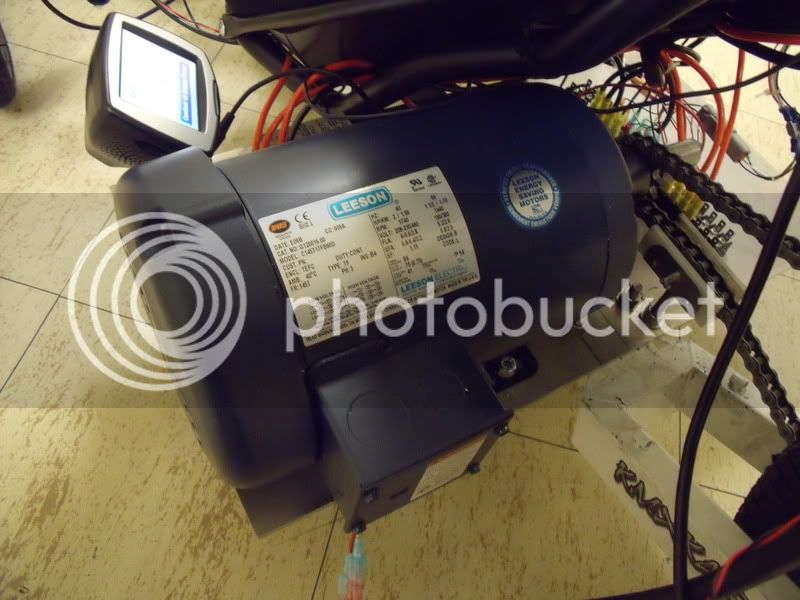

The prototype has been tested for about 1000 miles and still runs smooth. It has a small 110V 1.4KW 3 phase brush-less AC induction motor and a 120V controller that holds up to 100A current. The motor is brush-less and its lifetime is endless, the only thing you can change on the motor is the ball bearings. With a such small motor and weight of 330lbs (150kg) because it has lead batteries, it runs about 35mph (55kmh) on a flat road and more on a downhill. We are in need of a investor for a mass production. We have more than 3 years of experience with electric scooters, two conversions so far. Excellent skills in microprocessor coding with assembler and I'd say electronics genies. The electronics for the Tesla Scooter are self-made from scratch. Every tiny resistor is bought and soldered by us. The technology we use is similar to the one Tesla Roadster uses, the main difference is that they use third party controllers made by Siemens and we made it all from scratch! You can contact me at ackovski@yahoo.com and find the videos at YouTube on the ShotgunEasy's channel.

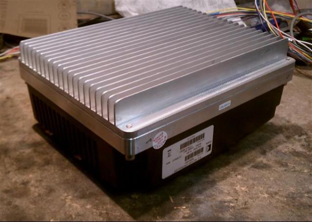

Whoa! Your little 6x TO-220 size FET controller uses poly-film caps. lol I respect that you made it work though.

I gave up on TO-220 package FETs about a year ago in my controller designs. The package was designed around a 25a Ids back in the days when that was all the silicon die supported. Now we've got dice that can do 200+amps in the package, but even the beefy version of the package are still crippled by ~75A package leg limits, and crap Pd figures (particularity so when you have to isolate the drain tab). Our typical FET of choice is the IRF4110 for ~<100v controllers, it's got a good die, but it's package limited to ~75amps. I always connect directly to the drain tab for one connection, but the remaining leg connection is always a weak-link, and when you add up the switching losses and freewheeling clamping on the intrinsic diode, and the I^2*rdsOn, you use up the avaialble Pd pretty quickly for the package ~50-60amps seems to be the useful ceiling for something with any degree of reliability in a 6-fet configuration (of course the motors inductance plays a roll in this). I would love to know what TO-220 FET you've found there that performs so much better. :)
I went to TO-247, then TO-264, then some exotic packages, and now loving the Y3-I package.
Here is a little shot next to an old POS 18 x TO-220 fet I built for a size compare:
Here is a little shot of the current project (the cap mount stage unbolted from the rails obviously, it's still being optimized).
1. Bad idea... its cheap and affordable... and as you can see does the job even at 100A, even though someone told you it can max 75A per leg.
2. I saw no 3 phase AC induction motor... only DC motors with permanent magnets!
liveforphysics said:
As far as 1/3rd of the weight, 4-5x the power bicycles go, here's one of my bikes (controller limited to 100A 100v per motor):
You compare those tiny electric motors to a 44lbs (20kg) AC motor?!

ISKRA 3KW 3-Phase AC
900Rpm 6 pole 3 phase AC induction motor, 3KW continuous, 6KW peak.
6kw peak for a 44lb motor?
sounds a bit..... wimpy.... for a 44lb motor.

Yep. I spec drives and setup controls for multi-mega watt 3p induction motors, gens, and rotary UPS' as part of my job. Soooo much easier to work with than PMBLDC motors, but you pay the price in efficiency, size, weight etc.
I call induction motors boat anchors (that have a good purpose in industrial applications). No offense to Nikola Tesla (whom I've always revered with God-like esteem), but induction motors are a really shitty choice for an LEV situation where power/weight and efficiency matter. When you control an induction motor, you get to operate in slip, so with nothing to sync, the controller brain design has a lot of room to be sloppy, and the R/L constant for the motors is very Di/Dt friendly, so current control is cake, even with low carrier frequency like you can hear in his video (maybe 12khz?). If you want a challenge, try building BLDC controllers for motors with <10mOhm winding resistance, extremely low inductance, and operate in 5-digit RPM ranges with 24-28poles. Driving an induction motor is like eating ice cream in comparison.
We could replace that 44lbs induction motor with a 4lbs BLDC motor (but then he would quickly become disenchanted with the TO-220 package when he tried to drive it.) ;) :p

The statement about the capacitors gives me a good picture about your knowledge, I guess the recognizing the chassis of the FETs was a google search.
You gotta share with the world your deeper understanding of capacitor selection for myself and the other folks who have to google-search to identify a FET package. All this time I've been designing around selecting caps with ESR minima's in the carrier freq range, and then a second paralleled set in the commutation freq range, giving inductive placement priority to the carrier freq caps, and then selecting the combo that ends up with the highest ripple current that fits the other needs. It seems Siemens and Yaskawa, NASA, and the whole rest of the world have got this entirely wrong though. This is where it's at for ripple current and low ESR caps guys, while the rest of the controller building world is busy googleing to ID fet packages, this is what the smart guys go to. :)
You can tell it's all about flattening out ripples just by the massive leads they throw on the packages, all the better to couple with those thick thick high current handling foils in there. ;)
