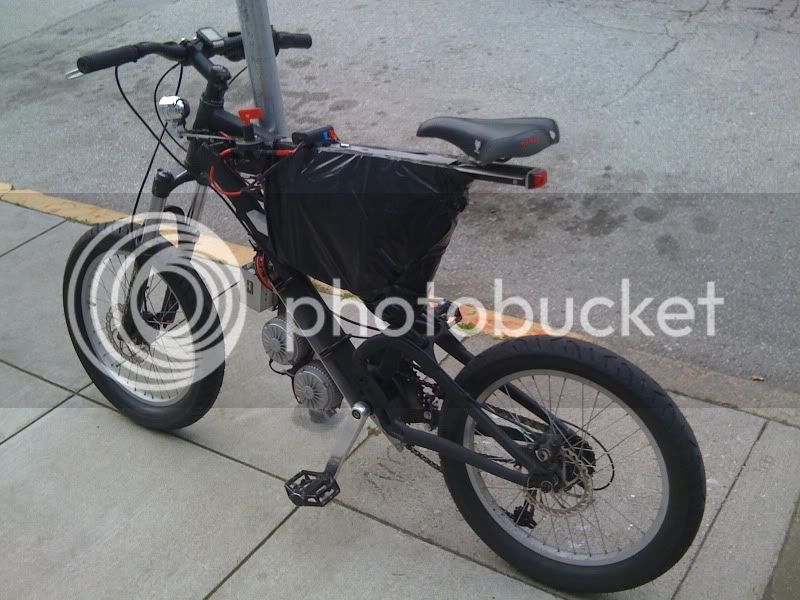

Postby colby » Tue Jun 01, 2010 5:28 am
your going to love the feel of the motorcycle tires :D
here's my set-up sense feb. (this bike is constantly changing)
pirelli ml-75 2.5 in the back and 2.75 in front
colby

Postby colby » Tue Jun 01, 2010 5:33 am

Postby bzhwindtalker » Tue Jun 01, 2010 7:16 am
wow it just looks so cool!

Postby dbaker » Tue Jun 01, 2010 9:46 am
Looks great! And you managed with such narrow rims!

Postby colby » Thu Jun 03, 2010 4:56 am
bzhwindtalker wrote:wow it just looks so cool!
hey bzhwindertalker,
that's what my friends are saying too.
oh, and the moped guys are giving me double takes :)

Postby colby » Thu Jun 03, 2010 5:03 am
kenkad wrote:For Colby,
What is the rim brand so we can see the rim specs as far as width, etc.
Thank you.
kenkad
hey kenkad,
they are just some no name brand lower quality rims.
there about 1 inch wide :oops:
but, they work!
eventually i would like something better/wider...
colby
Posts: 111
Joined: Wed Jul 01, 2009 11:51 pm
Location: San Francisco,CA
Re: 20 inch BMX rims with motorcycle tires
Postby colby » Thu Jun 03, 2010 5:08 am
dbaker wrote:Looks great! And you managed with such narrow rims!
amazingly it works!
i just have to keep an eye on the proper tire pressure to keep the bead seal on the tire/rim in check :wink:
