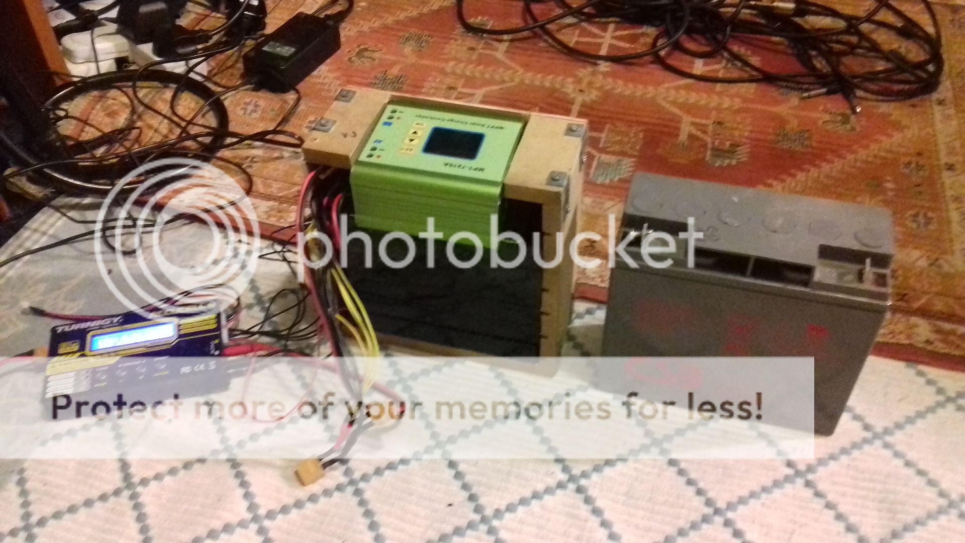

i have a semi defunct mpt 7210a solar charger.
i was hoping to use it to boost my batteries as they are getting old saggy (voltage).
they are three 6s 12000mah lipos in series.
although they begin at 75.6v they quickly go below 72volts. id estimate there usuable h now at around 9-10,000mah
rather than buying newer or bigger ah batteries. my hope is to make a smaller 12 or 24v battery to power the solar booster and this will add a few more amps at 72vs to increase my range a little and reduce stress on the main battery.
my hope is to have it working all the time while the battery/bike is under use.
i would like any advice or help about this.

its 1500 watts divided by 72volts which is about 20 amps max draw. half the time im no where near that. which explains why my 12ah battery lasts about an hour on a normal ride.
i have done some preliminary testing with smaller batteries in several configurations. a 20ah 12v pb, a 4ah 24v 6s lipo and a 72v 18s 4ah lipo
12v -72v = 0.01amps charge rate :( pooey
24v -72v = 0.3amps charge rate :( no so great
12v -24v = 0.7amps charge rate : s getting better
24v -24v = 1.3 amps charge rate :) verging on ok
im not sure how defective my charger unit is, that is why i bought a different/better one for my solar setup, and this is left spare.
i could need much bigger batteries ah-wise on the input side or the unit is just poorly designed/broken.
it was rated at 600watts which should mean a much higher charge rate. it should in theory charge a 72v at just over 8amps.
although a 12v charging a 72v at 8 amps should in theory be drawing about 48amps from the 12v battery, which seems like a lot for this little unit.
in its current state it would appear i would need to make another 72v battery and still only get a 1.3amp charge rate.
over an hour ride that is about an extra 10% (6 minutes) of runtime.
im not sure if the extra 1.3amps of current would add the extra %5 of torque or if it would even be noticeable.
an extra 8amps would be though :D

I've read this several times and I'm still not clear what you are trying to do. Some sort of variation of the perpetual motion machine I guess.
I do have some experience w/ the $30 mpt 7210a solar charger, both as a solar controller and a boost charger for LiPoly.
As a solar charger, it really needs at least 48 Volts of array to be worth the effort and the MPT feature is sketchy at best. Any small clouds at all will disrupt the charging cycle and it takes a long time to get back on track
As a boost charger it was remarkably inefficient unit. W/ a lead acid deep cycle 12 Volt batt., it wouldn't really put any Current into a dis-charged 12S LiPoly pack. I think w/ 2 12 V batteries is series, I could have put 2 or 3 Amps into the pack, but not even 50 Watts.
Aside from practicing your math, I think you are engaging in an exercise if futility and would strongly recommend you just buy some new LiPoly and ride your bike.
There have been times, years ago, when my LiPoly reached the end of the service life, I felt I could have used it better and extended it's service life. These days' I've gotten so good at treating my LiPoly right that I look back and think about all the miles I've traveled and I'm amazed at the value received.
The smartest thing a user of LiPoly can do is buy it on sale, even if it's not needed and store it. It lasts forever in storage mode.
The Universal Law of "If you want to play, you got to pay" doesn't change, no matter how much math one does.

by "semi defunct" i mean the unit as a solar charge controller sometimes would not switch on properly/automatically in the morning when the sun came out, meaning it wouldnt charge all day unless i manually told it to start by pressing a button.
That is normal for that unit. If it times out(Night time) , it has to be manualy restarted in the morning. It is one of the things folks complained about in the reviews.
....i have a feeling i need to put a much higher ah battery with less sag on the input side.
It only puts out a few Amps, ilreguardless of the input Voltage. It just isn't very good as a boost converter. You would need at least 48 Volts input to charge anything in a reasonable time. Get a Mean Well, they are cheap.
although this is a cheapy mppt i still think it does some form of power point tracking. meaning as the voltage on the "battery in" drops, it drop its current draw to compenssate. this could explain the dismal charge rates ive been seeing.
The MPPT only effects the charging in the sense it's cycling. If a cloud interupts in input voltage, it stops charging. The MPPT is supposed to maintain some charging and help it ramp up quickly when the cloud passes. The MPPT doesn't work very good on this cheap solar controller.
There's tons of info on the Net.

I had the 7210a and it is limited to a 10amp input. Mine is fully dead after been in service for 4 months boosting 120w (18V)solar into 6 old lipo's. (To then run a 24V inverter to run a pump on an aquaponics setup. )
The more voltage you have on the input the more watts you can boost.
Eg 22.2V in you would be maxing the 7210 out at a 3amp output at 72v.
I don't think the 7210 would last that long.

1) The MPT7210A sucks. I've never gotten it to work well.
2) If your batteries are saggy, then your problem will occur under load, when the extra few hundred watts you will get won't matter much. You could get the same result by limiting your throttle by say 5%.

with some further experimentation.
i have managed to get it to charge from a 12v (pc psu) upto a 72v with a max amps of 0.7 (50.4 watts)
it would appear i was correct about needing a much larger ah battery on the input side that would sag less.
even the pc psu sagged from 11.99v down to 11.5v
i have a 6ah 6s lipo charging currently and i will test it on that once full. hopefully ill see 1.4amps charging current (100.8watts)
i think your right john61ct/billvon, the concept i have is a good one....... but the equipment i have (the dam mpt 7210a) isnt.
i might get one of these or something similar to replace the mpt7210a

here it is, half done. I put it next to a 20ah lead acid for a size comparison, a little bit bigger (only taller) but it weighs a lot less :)
its a 6s 8p 16ah, so about 384wh.
i just need to neaten up the wiring, add a switch, add a front plate and maybe paint it.
if you do learn from your mistakes, i should be a genius by now.

Hmm I understand what your doing but it would have been more efficient to just reconfigure the "6s 8p" into 18s 2p and then parallel it to your existing battery. Of course you lose flexibility to boost your other toys.
I envy your available time :mrgreen:

i get that a 18s2p will probably be more efficient than this contrapration but itll be far less configurable. my box does have some benefits over it other than being able to be used on various other toys.
i dont use a bms on any of my batteries....just a balance charger (isdt 600w)
with my current 72v batteries i actually use 3x 6s in series. but i charge in parrallel. before i connect them in parrallel to charge, i do make sure each cell is ok (withing voltage range). this is a bit of a faff and takes a minute or so.
with my box i can just plug in the large amphour 6s battery and balance lead, if it was a 72v 18s battery id have to go through this faff again or resort to a "dreaded" bms and buying a 72v charger.
another point is although my three rc lipo pouch cells are rated to 4.2v and 30c.
my 18650's.....are dubious and are more so probably li-ion than lipo and should only really be charged to 4.10v,they also have a questionable 1-2c discharge rate. id be hesitant to just connect them in parrallel as in theory as they have different discharge curves which also could make their own inefficiencies.
also a 18s 2p would be less dense in the avaiable area i have to work with than the 6s 8p i have made.
