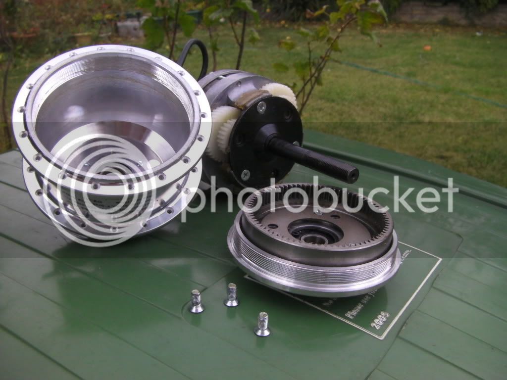

Greetings all, sadly this motor left its last breath near the top of a 300m hill (grade ~15)
Symptoms (bicycle flipped upside down = almost no load):
- when starting, it jerks back & forth.
- when it picks up speed, it produces much more noise than it used to.
Any ideas how to open it up? I've removed the three ~1cm screws that used to be in those three holes, but the side plate does not come off. There is also something within the motor that can be seen through those holes and that moves together with the axle. That is what the screws screw into.
The whole sideplate is threaded around the edge and unscrews instead of popping off. You need to get or make a tool to stick in the holes to get the leverage to unscrew the plate.
Aside from the clutch (springs), there's nothing you can repair inside the motor. Even the smallest/simplist part, the Hall sensor(s), can not be replaced on the Q100.
From what you are describing, it's more likely the controller has developed a problem.
Also, ck the phase wires to make sure they didn't melt, especially the bullet connectors.
Pic is from one of D8veh's posts, ( here ) this shows the threads in the side.
But really, this sounds like a controller issue.

I've seen a much cruder version consisting of a rectangle piece of flat steel (approx. 1/4" thick) w/ a hole cut in one end to slip over the axle. The rough edges leads me to believe it was cut w/ an act/oyx torch. The three "tangs" consisted of hex-head bolts "double nutted" to a-line w/ the indentations in the side cover.
Yes, the side cover turns off normally, counter clock-wise (lefty loosey), but on the rear motor versions, the cover is extremely tight because the action of the pedal drive tightens it.

There is a home-made set-up that might work, but I doubt it because it's a rear motor. Take a 4' X 4' piece of 3/4" plywood and double-nut the hex-head bolts w/ large flat washers, lay it on the ground, stand on it and drop the whl. ASM on it and turn the whl.
Really, I've been though this several times and you need a wrench tool at least 2' long. The idea is, you have a machine shop make it, but machine shops are few and far between these days. Plus it would be at least $50.

Often, if the motor hasn't been used, the cover can be unscrewed by installing a single hex/Allen head screw in one of the three locating holes and strike it with a punch and hammer.
"Lefty loosey" of course.
