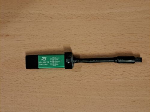

Can you post a pic of your connector?
You have brown > RST, black > SWIM, orange > ground and red > 5v? Also are you on Windows or Mac?
Also check that the actual USB plug on the ST-Link isn't loose. I had to resolder mine on because it was so crappy. Changing out the controller is probably more work than just flashing your motor, you are so close! For reference my connector is only about 4 inches long.

Potentially my connections are fine but maybe the drivers for the ST link are not correct, or conflicting choice of wires to connect.
I did have a similar problem for a long time in flashing the screen, but eventually got there. I am losing hope that this will work.
I've go a bunch of the yellow ST link keys and most have the same printing on the outside, but one has swim and ground in a different spot.
I do appreciate your experience with this, if I don't get there I'll be stuck using the car next week for my 300km commute per week :cry:
Aquakitty wrote:
Aug 22 2019 12:57pm
tsdz2 connections.jpg (270.88 KiB) Viewed 665 times

The two major things that could be causing this are 1) your connector is too long. My wires are like 3cm total. 2) The ST-Link V2 you received is a dud. On the wiki you'll notice he suggests buying multiples from different vendors because sometimes they are just garbage. Mine, for instance, stopped working because the USB connector was soldered badly (was an easy fix myself).
Bigsy, looking at your pic (sorry I didn't reply sooner) that connector is possibly too long for the motor connection.
Sorry about my original post on the colours, I accidentally looked at the connected wire not the original wire thus the red should be brown. It should be orange > ground, black > SWIM, brown > 5v . Here is a pic of my connectors that work fine:
Note the long one is for the LCD, and I had to make the motor one that short to work.
Also why are your ST-Link keys yellow not blue? Just a different vendor or?

i've solved the problem only with a very short cable (maube less than 10 cm) between usb stick and speed connector......looking in front the connector 5 v on top, ground left bottom e swim right bottom...that's all.(wiki instruction)
Thanks sfwebcom, you might have just given me the detail that justifies trying again for a few more hours.
My interpretation, of the ST link print is the other way around.
RST and SWIM pins totally look on the diagram like they should be the top row, not the bottom.
I am also now keeping the battery connected to avoid 3 connections the the usb stick.

A pic of your connector would help. What exactly are you having trouble "keeping tight"?
anything to add guys? You are my gurus!
Thanks Aquakitty,
I am now connecting the controller cables direct to the usb to try to get around the length of wires.
I've got 5 different yellow ST Links and one blue one.
They are all but one printed the same. strangely one of the yellow ones has rst and swim the other way around.
I had wondered about my reading of the print and assumed that the top row of connections is SWIM, GND 5V etc
Did you win by using the top or pottom row of pins?
Thanks again!
