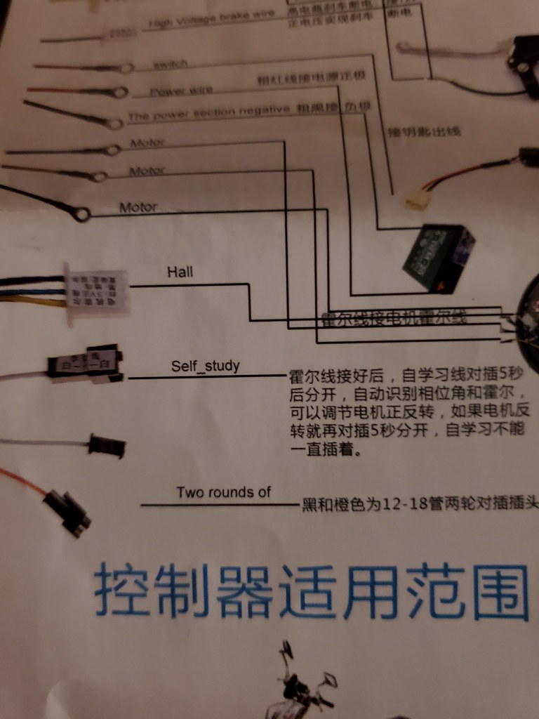

I am looking for some assistance with wiring the controller. I swap out a 48V to this one but I cannot get the "low brake" to work. It does cut power to the motor but does not apply the 'brake' to slow down the motor. Any help would be greatly appreciated, thanks.
Link to 2000W 48-72V brushless controller: https://www.ebay.com/itm/2000W-48-72V-D ... 2749.l2649
There's also a single orange wire label "Two round up" which I have no idea what it is...

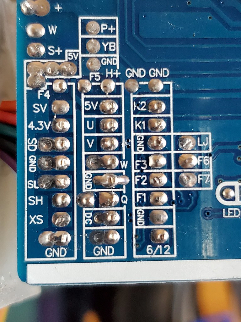

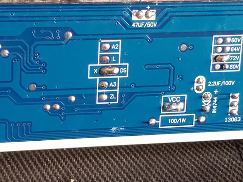

I've tried opening it up but can't find anything that look like "regen"....here are some photos.

Here's the translation using google translate:
"Two rounds of Black and Orange 12-16 tube xxx-steel plug connection"
- amberwolf 100 GW
- Posts: 31748
- Joined: Aug 17 2009 6:43am
- Location: Phoenix, AZ, USA, Earth, Sol, Local Bubble, Orion Arm, Milky Way, Local Group
- Contact:
Re: 2000W 48-72V DC brushless controller wiring help
the actual image you linked says' 12-18 two-wheel, rather than 12-16 xxx-steel.
if that is correct, then perhaps it is a link to connect two controllers together so that one of them controls and synchronizes the second, based on control (brake, throttle, etc) inputs to the first. there are higher end controllers taht do that.
what the "12-18" part means, I don't know, nor do I know what the "two rounds of black and orange". But that might mean it's a black wire and an orange wire, and they are specified to be anything from 12g down to 18g.
but that is all guesswork, and any or all of it could be totally wrong.
i don't see any of the common labels that've been used for regen activation there, but it doesn't mean it isnt' just anmed differently.
which of those pads do *not* already have wires going to them?
wich of them have wires going to them that you aren't using and/or haven't identified the function of?
whcih of them have wires that you *have* identified?
it may help if you trace the wires that you do know what they're for and cross-reference mark the pads and the wires with their corresponding label names. so put the pad names on the wire chart, and put the wire chart names on the pads. that willhelp show you where things are actually at on those pads, which may cluster related functions in the same area.
knowing which ones don't have wires to them at all means you thenknow what is not being used at all.
some i cna guess at; any or all of these could be wrong.
the 5v and 4.3v and gnd pads are all voltage supply and reference.
uvw are hall signal inputs from the motor.
sd - throttel signa
sl = brake low
sh = brake high
6/12 is 60/120 degree hall spacing
k1 and k2 are the wires fro a three speed switch
there's a chance that xs is the regen enalbe pad if it doesn't have a wire on it yet. if so, you could just bridge it to the ground pad next to it with a bit of solder, and then test the bake leevr to see if it turns on regen now instead of ust disabling the motor.
q could also be it, since it has another pd next to it in line with it that may be inteded to be solder-ujumpered to it--total wild guess, and is proabaly wrong.
n o dea on the other ones. well, ideas uut not based on anything i'd trust yet.
I am happy to report that I've found the pins. Thank you very much for all the help. I was able to open up the old controller that I had and trace the "EABS" wire...and luckily the controller almost look identical. If someone has this same controller the pin you want to look for is "X" and "DS" in the middle of the PCB.
The "XS" pin is like a "throttle limiter", if you short it to ground no matter what position the 3 speed gear switch it is always on "low"
I've still no idea what the "Two round" wire do but here is the answer from the seller ""Two round" means that you need to accordingly plug in if yours owns 2-wheeler, but ni plug-in if 3-wheeler." It's outputting a 5V like the "low brake" but does nothing when I ground it.
Again, thanks everyone...
You have to think like Chinese. They write in pictures.
Two Rounds. What's round? Wheels.
So 2 "wheels."
... Of tube 12-18. So, two wheels of size 12" and 18", connect this one.
I'm guessing it will mitigate torque on launch or affect the operation of EABS for the smaller wheel sizes. It'd be interesting for sure to find out.
So 2 "wheels."
The gray wires with the matching black plugs are the self study... You temporarily plug them together for that function.
Whatever the 2 rounds wire is, it's just the single orange one. It sounds more like a description of the plugs themselves, and the gauges of wire they can handle than what the wires do.
The main reason there are high and low brake outputs is for running 12v brake lights, so you don't need a way to reduce that down to 5v for the motor cutoff, but can just run the same voltage thru the brake switch as the lights use.
