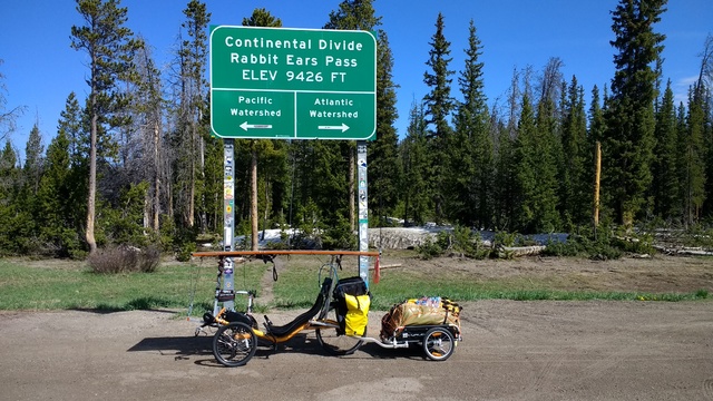

This is going to go an a Rotovello (a moderately heavy velomobile). I also have a 48V 30AH LiFePO4 battery that I will be using with it. My goal is not high speed, instead, I am looking for range and the ability to pull a trailer with solar panels. I already have the solar panels and charge controller from my Kansas to Utah "never plug in" tour.

Installing the NuVinci on the one in the picture I learned about installing shifters on the NuVinci. You are right, it is a bit different. My first NuVinci was on an N360 commuter bike. Then I had an N330 on a terra trike I got my wife, it later Became an N360 on a different trike for her. Then I built the one in the picture with an N380.
I also have another N380 sitting here in my home office, I was going to go with it and a mid-drive on the Rotovelo. I just never got around to truing up the 20" wheel I was going to use. All that said, I never did use the earlier series of NuVinci, the N171.
Parts support can be an issue on the road, but I have never needed any parts. The only odd thing was the chain breaking I mentioned. I went to a bike shop in Pueblo (A great one right along the Trans-America Trail). I went in and asked if they had any heavy duty single speed chains. they had some BMX chains and I took three. I ended up doing some tinkering on the chain line, on a sidewalk, but I did get the rig working for the rest of the trip.
Recumbents have long and complex chain lines. I would like to simplify it as much as possible.
