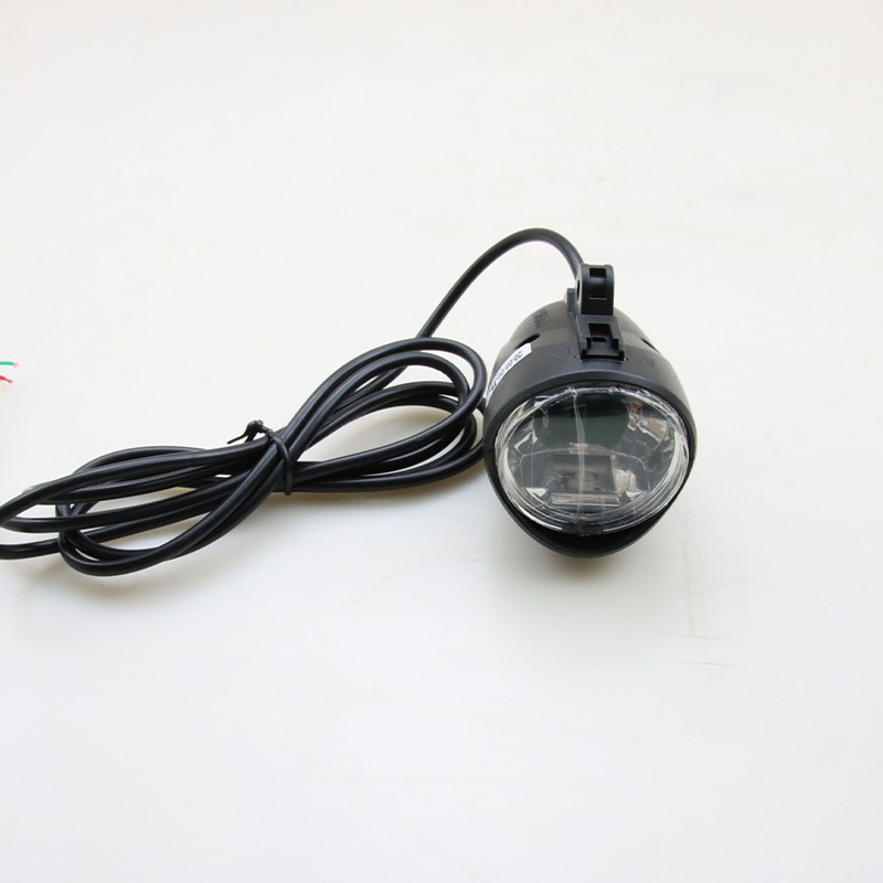

I have a headlight that works off battery voltage using a switch, and a separate, rechargeable brake / tail light / alarm that uses an accelerometer to activate the brake light. But I'd prefer brake lever operated battery voltage brake and tail lights, and I'd like those tail lights and the headlight to get turned on by the controller because I'm a glutton for punishment. Truth be told, this is my wife's bike and that rechargeable brake / tail light isn't very bright and has to be set a certain way for the brake light capability to work. She has a knack for mashing on her brakes for mysterious reasons so I want her to have a very bright brake light that works as soon as the bike is turned on so that I don't run her over.

I have a headlight working now, through a fuse and switch, but it's a good time to tinker while it's pulled apart.

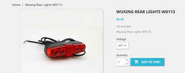

The front and rear lights I am using on my trike are rather bright, and work with anything from 12-60v or something. I used a motorcycle-style handlebar mounted rocker switch. One trick with these auto- or motorcycle switches is that while the simple ones seem happy at switching voltages well over 12vdc, the ones that include an indicator led are an issue since that will generally cook also if you try and use the indicator at much over 12.
I have a stepdown buck convertor for 12v but have no current use for that on the trike. Opinions may vary, but I think brake lights - that is, a rear light that is brighter to indicate the application of the brakes, are of limited use for cycling as cars would seem to have no real regard for bikes or trikes, regardless of whether they are slowing or not. I wired both leds in my tail light to be on all the time to maximize basic visibility.
