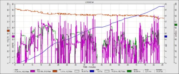

I tried E-Data 1.2 on my W7 setup and it's perfect !
Today i drove to work for the first time with my scooter. It went superb! as you can see on the graph i drove 51km with 19.15 Ah
I used a 22S4P setup with all 5A6S turnigy's. See screenshot E-Data 1.2

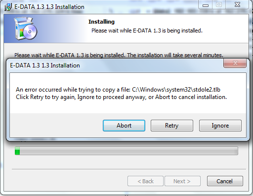

tried to instal 1.3 but i got an error while doing it.
so i couldn't test it.

I don't have any ideas why my fancy store-bought installer is showing an install error.
Which operating system are you trying to install on? I know from your previous post that Ver 1.2 worked on Windows 7, and I see from your recent post on "120% timing" that Ver 1.2 is still working for you. Did you try to install over Ver 1.2?
If Ver 1.2 is still working on your system, all you need to do to use Ver 1.3 is to copy its executable to your hard drive and run it. All the supporting files are the same as for Ver 1.2 and, if Ver 1.2 is running on the same system, all those files are already present.
Here's the 1.3 executable, see if it works . . .

Works perfect !! Thanx dude! 8)

Unfortionatly still no go. Whilst installing I get a message that "An error occurred while trying to copy stdole2.tlb ". A google search shows this to be a common problem with VB6 and Vista with no easy fix, looks like I'm out of luck.
Thanks for trying though, I'm sure it will be useful to other XP users;)

Jozzer wrote:Unfortionatly still no go. Whilst installing I get a message that "An error occurred while trying to copy stdole2.tlb ".
I got the same error. I clicked "Ignore" in the dialog box and the installation continued and completed. I had specified to have the program create a desktop shortcut, however, the desktop icon was a generic one. When I double-clicked it, it tried to find the file. I clicked the Browse button and the dialog box showed the E-DATA 1.3 folder. I clicked the E-DATA 1.3.exe and the icon changed to the correct one. I launched the program, loaded a sample text file, tried changing the scale, clicked all the buttons and everything seems to work!
Thanks Older...
Oh, one other small issue. the directory that the program creates in the Start Menu is called, "E-DATA 1.3 1.3". No biggie.
Thanks again. What a great program!
