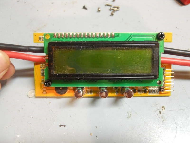

I managed to screw mine up trying the mod, constantly reads ~135amp doesn't change
the voltage is correct though, any ideas how i managed to get it wrong? would connecting the negative and
positives ass about be the cause possibly? I was going to swap them but ho8ught i would post and ask also...
's a series of pics i took while doing the mod, i also just lifted the LCD out of the way. This Turnigy
also has a mod on it to increase the voltage it can read, done by an ES member (soz i forget the nickname)
Thanks in advance for any help fellas...

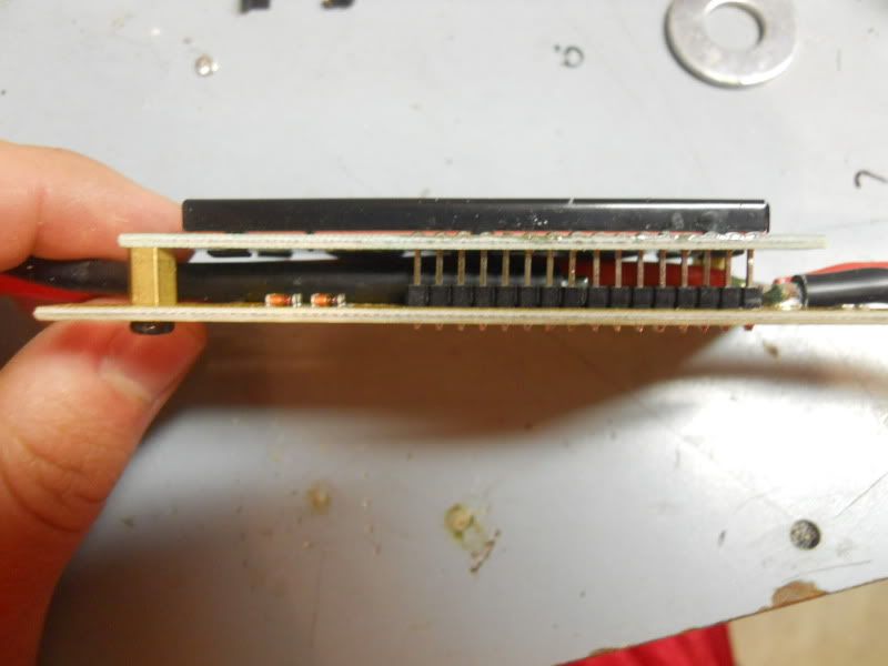

The little shunt itself is not polarity-sensitive; it's basically just a piece of "wire".
If solder flows on the shunt beyond the pads on the end, I can imagine it would affect the readings, especially if it ended up all the way across the shunt, but if it's only on the original pads for the purpose, it should be fine.
If the wires from the shunt to the pads on the meter PCB are long and really thin, they could have a bit of internal resistance that might slightly affect the reading, but so little current flows thru them that it is nearly irrelevant. However, they *could* pick up RF noise or induced currents from other things, so twisting them together along their length, or using existing twisted-pair wire, should help to minimize that.
If there is a lot of induced RF in there, a tiny ceramic capacitor at the PCB end of the wires might help; not sure what value but in the pF range, I'd guess.
Other than those things, I don't see where having the shunt outside the unit should make any difference to it.
It is of course possible that static electricity (ESD) from your body discharging into the meter's circuits during the mod process could damage things, making them act wierd, but many circuits have at least some protection against this. I don't know if that design does.

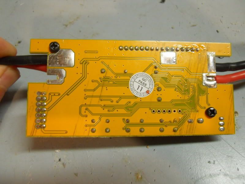

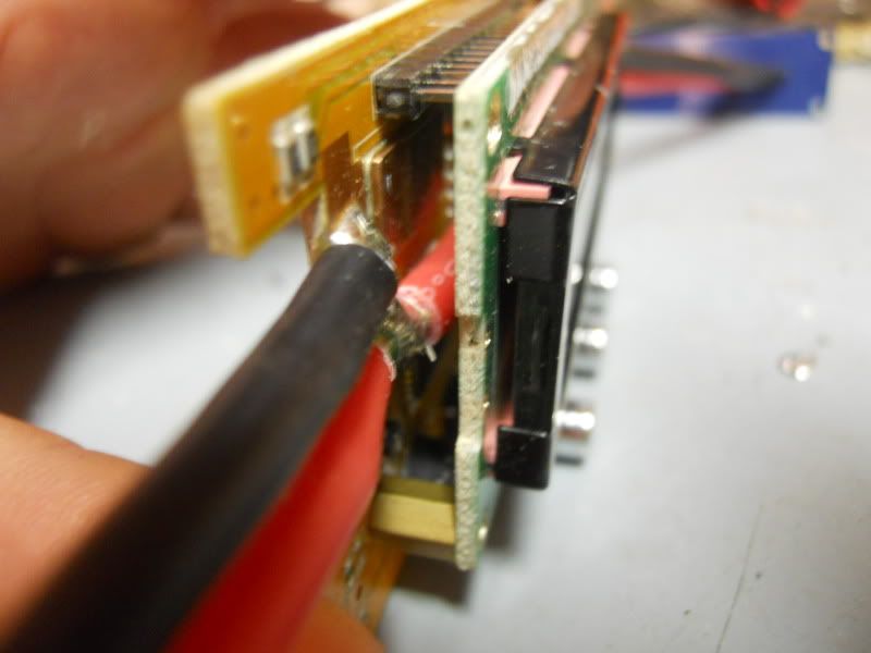

If your amp reading is flying there - you probablly just need to solder your shunt wires again, take a good look at the shunt's pad.
When the shunt is soldered on the board the shunt connects the big wire pads with the small pad - you need to connect the two with soldering iron.
left side soldered good, right side - not!
* this is true only with the older Turnigy WattMeters boards.

What makes the left solder good and the right bad? I can't figure it out from the pictures
Metallover   10 kW
Posts: 502
Joined: Jul 08 2009 8:09pm
Location: South Dakota
Re: Mounting Turnigy Watt Meter
Post by Metallover » Jul 10 2011 9:46am
You can see space on the right solder board that was dry and free from solder. See on the left solder covers the whole pad.

Post by iovaykind » Jul 10 2011 7:23pm
Is it that part that needs to be connected to the big pad?
Cause I got rid of my 157amps reading not be resoldering that pad but by simply unsoldering it from the shunt and moving it around in different places.

Yes, that is why my meter wasn't working.
