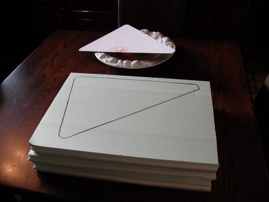

Today I made a cardboard mock up:
19/01/2011:

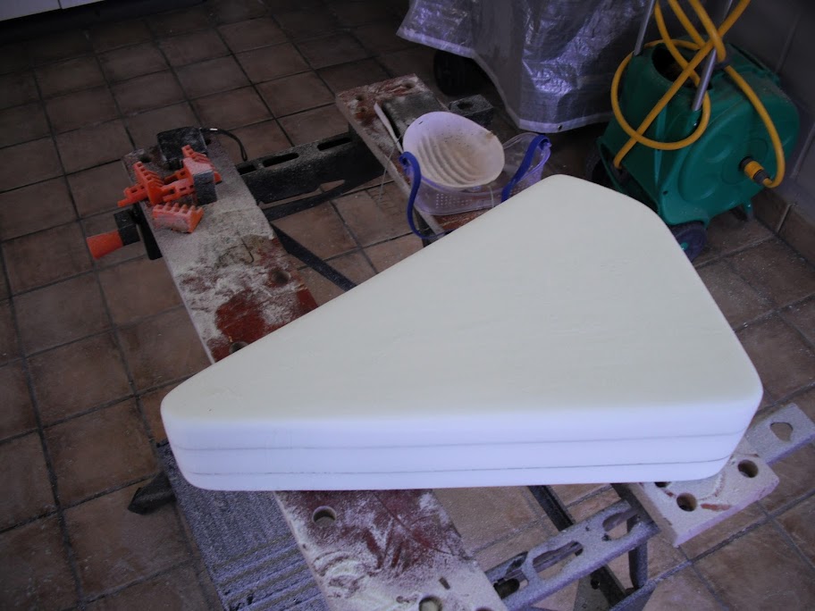

I bought BASF Styropor insulation foam, only 4 cm thick insulation was available so I needed to glue them together.
After some sanding my foam mold is finished, I adapted the design a little bit to make some room for a larger chainring:

06/03/2011:
OK guys so its bin a while, I had some busy weekends and I ordered some stuff online and it took a while to be delivered.
Today I've fiberglassed my mold. Don't mind the ski goggles, the fiberglass usersguide mentioned spray water proof safety glasses ... You will also notice the tight Tyvek suite, I borrowed it from my dad and he isn't as big as me.
It was my first time fiberglassing, I did one layer of fiberglass and one of kevlar/carbon. I used epoxy resin. I hope it will turn out ok, I'm pretty satisfied with how it looks but I'll wait with getting excited till its cured.
13/03/2011:
OK guys, another weekend, another job completed, it may not look like much happened but images can decieve...
During the week I decided to put another coat of resin on the box because I wasn't completely satisfied with the coverage (in some places I could feel the roughness of the cloth). So I did on Saturday.
Today (Sunday) I planned to sand it completely to make the surface nice and smooth. First I tried to fit my box in my bike but to my surprice it didn't fit anymore :D . I kinda saw this one coming because I knew I did (to) much layers in the corners to make it extra strong. This is typically me, when I saw I had some spare cloth and resin I thought what the heck, let's put on an extra coath for added strength :D .
So I've spend much of the afternoon sanding the one corner that didn't fit anymore. Offcourse I needed to sand that much that I had to sand into the cloth ... not very happy with that. It fit's now and I put a little resin on the places where I sanded into the cloth.
Next week I will sand the box as smooth as i can without sanding into the cloth and I will take the foam out (really curious if my release agent wil work :D). Weekend after that I plan to make it completely smooth with some filler and put in my electrical stuff, final step will be painting and mounting it on the bike frame.
1/05/2011:
It's been a while but this weekend I finally found time to work on my box again. I finished taking the foam out. Special thanks to my neighbour, he helped and if it wasn't for him I would have quit and start again another time :), my release agent worked but the space to work in was so small I went crazy at times.
When I found my sanity again, I started with the filler to make a smooth surface. The surface needed a lot of filler to make it straight but now it feels and looks pretty good. I need to do some finishing touches but I ran out of filler. Will do the last details another time, I also need to find a solution for the places where I sanded into the cloth, maybe I'll do some filler on it but then my box will not be straight anymore.
Next weekend will be electronics weekend I'm going to lay out the complete circuit and find places for everything in my box, I will mark these places and cut holes where needed.
