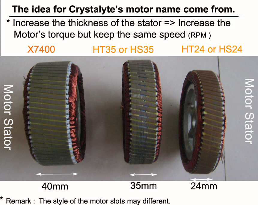

Have you any pictures of the stator or inside .. that would help revelating the degree of performance and power they can do. ??
These pictures posted on crystalyte website are wrong and i remember we posted the correction to them with the real data we measured about the stator dimensions. i'll try to find that and post teh link
from Crystalyte website:
The correction i made that make more sense according to real measurement and existing confirmed data :
file.php
Here is the thread about stator measurement :
http://www.endless-sphere.com/forums/viewtopic.php?f=3&t=23963&hilit=7400

Btw.. What exactly is the stator width ( WITHOUT the wires on each sides).. I mean just the core of the winding... 38mm?

A wider stator doesn't always translated better, as I have listed from above differ width of stator:
408 - 42mm
5304 pre-2008 33mm
5304 2008 32mm
Hx24 25mm
Hx35 35mm
A 408 is 42mm, does it mean it is more powerful? 5304 only had only 31.6mm, does it is mean it is weaker motor? When you make the stator wider, other problem will show up like disc brake will not align, freewheel with not fit, etc... It's all about balancing power, speed, lighter weight, cost, production, etc... to make fine motor.
Hx35 is a like mix in between 408, 9c, 5304, a bit of Bionx (narrow motor case that can fit 7,8, 9 freewheel easily).
