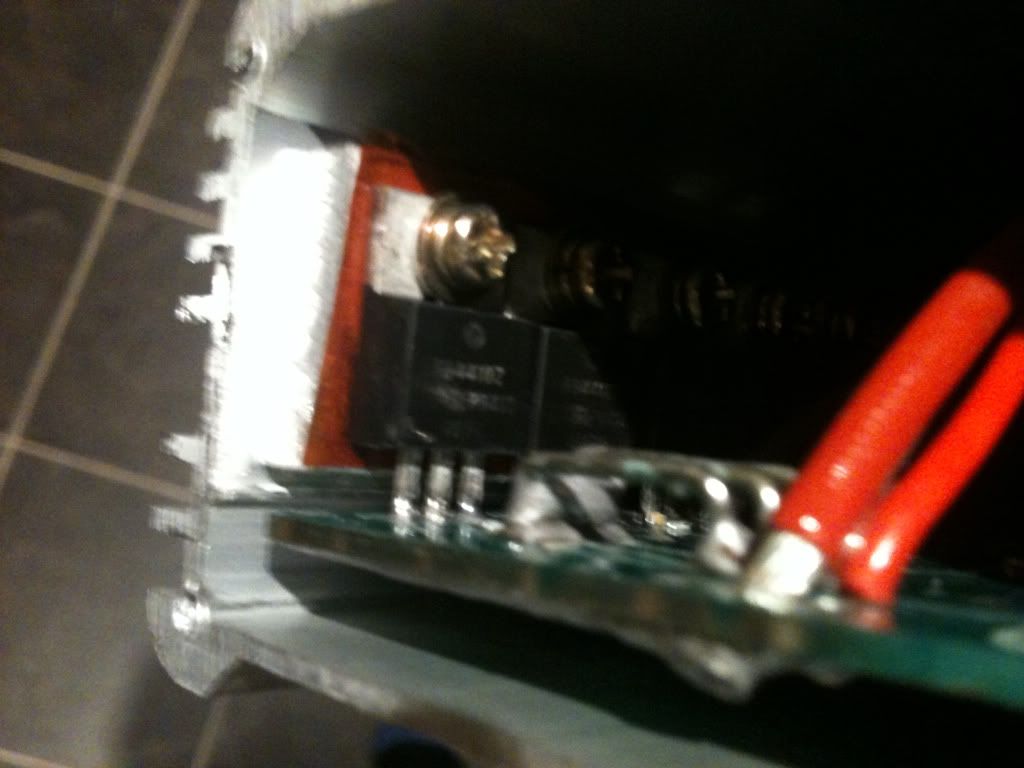

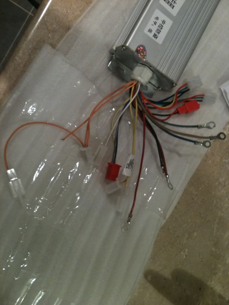

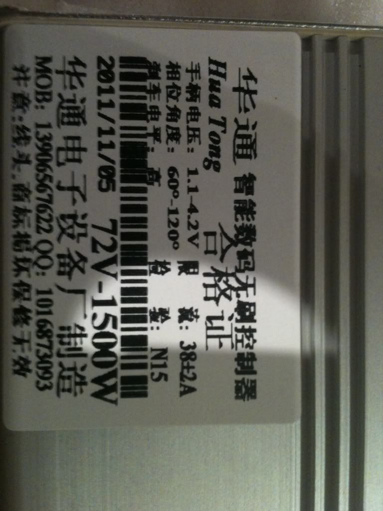

Hello all,
Mine turned up this morning a week after ordering.
I've attached some pictures for refererence. I couldn't open it fully because the screws started to round off which is annoying. I'll have to cut them before I round them to far. So unfortunately I can't get you board pictures for now.
Anyway some pictures for reference. It's quite a bit larger than my 9fet controller from bmsbattery.
I'll be using it on a geared bafang. So the 38amp peak is far to high so I will cut one of the shunts to drop the amps to a more reasonable 25amp peak.
Mine also had the sticker 38amp peak.
The MOSFET used are fb4410z if that means anything to anyone.
Marin kentfield FS - Unassisted
Gordo   100 kW
Posts: 1218
Joined: May 23 2010 4:46pm
Location: THE COLD WHITE NORTHWEST, EH?
Re: 72v 1500W 40A Hua Tong CA08 XM06AD_P04.1 controller
Post by Gordo » Jan 04 2012 4:13pm
Scottyf wrote:Hello all,
Mine turned up this morning a week after ordering. The MOSFET used are fb4410z if that means anything to anyone.
It means someone printed on the FET'S, not much more :) Seriously, this presents a contradiction to the assumption that the #OT100 quit using 4410's and switched to 4710's a few months ago. When you get the board out, look at the number on the board. CA08 XM0XXXXX ?? I would think your date of 11/11/05 would have the 4710's :?:

cohberg wrote:
The Mighty Volt wrote:I must have a very early model because I have the genuine IR 1470 Fet's which have a rated RDS of 7.8mOhm, 15 Fets only. Controller is 48v 50A rated.
I'd be wary about calling them genuine.
Physically, they stack up, with the same copper tint, notch and half-a-tear-drop.
I'll grab some photos and put them up.

The Mighty Volt wrote:I got it wrong. Sorry it is 1407. A good fet too it seems.
http://www.irf.com/product-info/datashe ... rf1407.pdf
Only good to 75V though. Good for a 48V controller. Not worth a hill of beans for a 72V controller.

wesnewell wrote:Only good to 75V though. Good for a 48V controller. Not worth a hill of beans for a 72V controller.
Yeah i think he has the 48V version that kentlim26 has. 48V controller typically run 75V fets and 63V caps right?
All my 48V controllers have 63v caps and 70-75v fets. Both my 72v controllers have 100V caps and fets. Someone said they had a 72v Hua Tong controller that only had 75v caps though. It was the model with 2 wire bundles out the end. I think they sell both as a model OT100, so be careful about what you buy.
Yeah pretty much. I'm happy with it though, I can make a custom battery of around 55volts resting. I'd sooner have a small controller with real IR fets of a lower value than dodgy stuff of dubious origin.

yes, the 48v the caps is 63v, so i will not bet to run more then 60volts. If not i will have to order another huatong controller. however im currently testing the 60v controller the caps is 80v. 48v lifepo4 ,16cells cannot work with the 60v version. when u fully throttle , it will draws lots of current and shut the controller down. so i just simply add lipo 7.4v x 20amps + 16cells lifepo4 i can get 60v ~ 61volts, and it works really very well for the 60v controller version. results is not bad. I think i will stick this controller + conhis motor 48v 1000watts . i can easily get 55km/h on flat. , i think this is the range i like 55km/h, if my ebike is going at a speed above 61km/h ++ the handling is abit scary + Risk i think is up also as well
cheers..

Well I got mine today, 38Amps and the board has a D3.2 number.
BTW I don't plan on modding this controller much just try it out with a yescomusa kit, I don;t really need regen or all the built in features.
