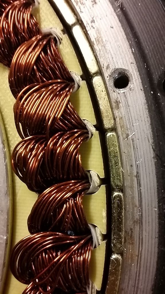

Emmett wrote:BTW: My hub never drips oil. Even when stored for over a month.
Well after saying the above ... yesterday my leak-proof hub motor leaked! :oops:
Simple problem and fairly easy fix, so some people might be interested.
The castor oil leaked out past some of the countersunk bolt heads which hold the side plate on the disc brake side of my H40xx motor. The oil resistant silicone sealant held a good bond and the side cover seal is generally OK but some bolts loosened a little despite the loctite on the threads. My 7.5kg hub motor takes a good beating off-road, with 3" trials tire smashed into square edge rocks at moderate speeds. Often with substantial side loading. So the side covers, mating surfaces and bolt fasteners take a lot of load.
If anyone wants to seal their side covers on, to oil fill a hub then consider this:
0. Drill your breather hole and drill+thread tap your oil fill and drain holes in the cover on the chain side.
1. Thoroughly clean the mating surfaces using a high speed wire brush, then brake cleaner and compressed air.
2. Also clean out the thread holes for each bolt with brake cleaner jet/tube spray and compressed air.
3. Use oil resistant RTV silicone sealant. The auto gasket stuff. Put a very thin layer on both surfaces. Careful put it around each bolt hole and don't let any sealant contaminate the threads.
4. Use blue loctite on the bolt threads. Threads only. Keep the bolt head clean. Let no silicone sealant get on any bolt. I use phillips head bolts since they sit easily on the end of a screw driver.
5. This is my new step as of today ... Before torquing each bolt (about 15Nm is plenty) put a bead of JB-Weld epoxy (metal repair glue) around the neck of each bolt head. This will seal and seat each bolt.
I'm sure the bolts can be removed easily in the future with some heat on each bolt. Put a phillips driver tip into a large soldering iron and get each bolt up to temp and the epoxy will soften and let go under torque load. I've done this many times with no problems assuming the neck+head are the only part glued.
You could also skip the loctite and use epoxy on the entire thread length, however do that and you must first put a release agent on the bolt thread so the epoxy cannot strong bond to it.
Instead of ATF, I recommend castor oil, since it has no foul smell and is easy to wash off if it gets out. Just monitor how thick it gets at room temp and replace it occasionally.

Castor oil has no significant odour and wipes off so easy with a rag, or when washing the bike. Both ATF and motor oil stink and are very difficult to clean away.
Yes the castor oil thickens slowly. How fast depends on your usage/temp. As I wrote in my last post, drain it occasionally and you'll see how it goes. This is the main disadvantage with castor oil. The cost is low under $20 for litre.
I use 100ml because I found by trial and error (when it had a temp gauge) that in my motor the stator's steady state temp for my usage reduced quickly as the oil vol increased from 0 to 100ml, but adding over 100ml the benefits were very minor. I took a syringe on the trail and stopped for a couple of minutes and added in 20ml increments then keep riding the same track and looked at the temp gauge to see where the stator temp levels out at.
At present I wipe the axle ends with a rag after about every 5th ride. After sealing the axle slot+wires with the oil resistant silicone so far (after 3 months) I've not detected any oil seeping along my phase or halls wires. Leaning the bike either way when stored makes no difference. The film of oil on the axle ends just comes out. But no smell and it wipes off.
With more than 90ml of oil and "no load" full power test, the RPMs come down a bit and the watts goes up. I don't recall the values, but the losses were minimal (a couple of km/h), and for my usage at mostly under 50 km/h I didn't care about the drag. My range and economy is mostly determined by my riding habits.
I don't understand why I'd consider FF, when I found that 90 or 100ml of relatively cheap castor oil is the best volume of oil for my hub. I didn't know FF existed when I converted to cooling about 2 years ago. Prior to oil cooling my bike was effectively useless. Today I've not yet found a reason to change anything. With liquid heat transfer I'm loving the new hubsink!

At first I thought maybe it was the steel magnet ring conduction causing the bottle neck, as it is thick, but from online calculators, the magnet ring would be able to shed something like 12,000 watts of heat from very rough thermal transfer calculations. Therefore this is not going to cause a thermal bottle neck.
It would seem that the FF is acting as a thermal bottleneck, being that it has to bridge a very large gap, using an oil which is about 400-600 times less conductive as steel when transferring heat. Bascially, oil or FF is a crappy thermal conductor, but still better than air.
What also is interesting is that you would think the bottle neck would arise in the windings to stator transfer. However, this does not seem to be the case because the stator seems to suck all the heat up until the stator gets too saturated with heat. This is because you can full throttle the ebike for a very long time on a cold motor before the windings get hot.
Justin also potted the windings to the stator, trying to fill in all the air gaps around the windings, and this offered almost no benefit with the FF/satoraide.
I would assume this is because the windings are wrapped tightly around the stator at enough points to transfer the heat to the stator fast enough, even though the windings are separated by plastic and fiberglass which are also bad conductors. I would still bet there is a thermal bottleneck here also, but not nearly as bad as the stator to magnet gap.
