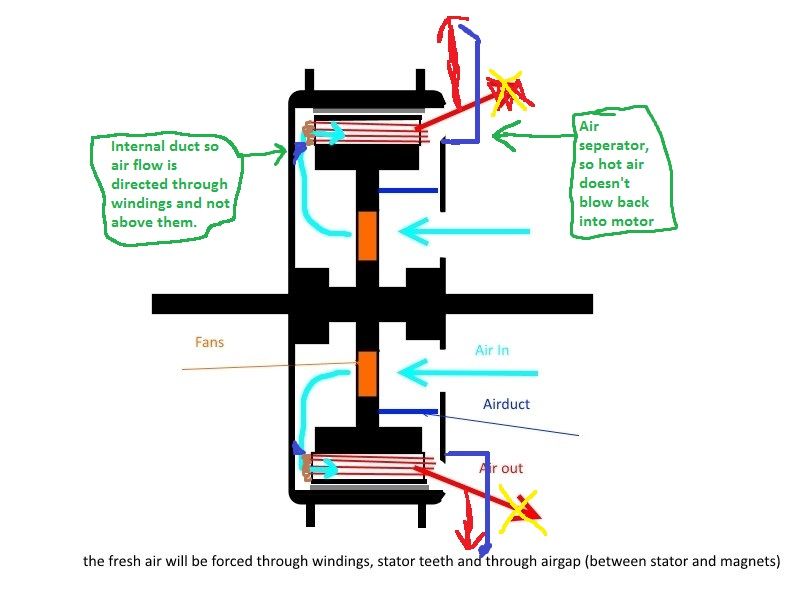

I decided I'm not going to try out the FF and just modify my new motor for air cooling.
I have a few reasons. I'll just put numbers on them to make the post more readable.
1) I believe alternative cooling methods need to be explored, if I used FF then there wouldn't be more research into the potential of forced air cooling.
2) My last forced air cooling worked great but was not optimized, very inefficient. While I did have the air ducted to have cold air in and hot air out, it was very inefficient.
Inside the motor I did not direct the air through the windings efficiently, so lots of air flowed above the windings (In my cromotor I could fit my finger between widings and side covers, lots of air would blow right above the widings), up to 50% or more of air flow.
Outside the motor I had the intake and exhaust too close and used no ducting so a lot of hot air was being pulled back into the motor.
My fan was smaller at 30MM using thin 24 awg wires, no where near as powerful as my new 35mm fan using larger wires.
My new forced air cooling setup I plan to build into my new motor should have about 3-5x more air flow through the windings. The outside air intake / exhaust will also have a separator/duct outside the motor so that much less hot exhaust air will be sucked back into the motor through the intake holes. This should reduce intake air temps dramatically.
This should make my forced air cooling much much better than before, and what I had before worked well.
3) I use my bike under the toughest ride conditions. My favorite type of riding is on steep dirt hills which I ride up and down and the limits are usually my winding temps. I can also turn up my fans to max speed during these type of riding. Forced air allows control of cooling speeds while FF + hubsinks does not.
4) My preliminary findings of running my fan inside a sealed motor showed that there was a bottleneck in heat transfer to the motor shell.
5) I'm honestly not convinced FF + hubsinks can come close to the performance of sucking cold air in, and blow hot air out. Until I see evidence I'm going to stick with what I know works. Most people don't push their bike to the limits like I do and FF + hubsinks will be the better option for most. But if you are pushing your bike to the heat limits often, then you need something more.
To me it is all common sense, hold your finger right in front of your mouth and blow on it. This is how the windings will be shedding heat in my new motor. The air will be blowing the heat right off the windings and out of the motor at a fast speed.
How can FF+hubsinks work as well when the heat has so many steps to get out of the motor. There is no way once those windings start to peak in temperature they will shed their heat quicker than air blowing the heat right out of them. I'm not trying to say you FF + hubsinks users have crap, just saying I need something better.
Below is a picture of how my setup works if anyone is wondering.

Offroader wrote:I decided I'm not going to try out the FF and just modify my new motor for air cooling.
Certainly eager to see your progress, maybe do a thread for it so we can follow easily
Personally i have found the FF + Sinks to be super effective (obviously i am biased but that is from months of hands-on experimenting during the development process as well)
The main thing I would disagree with is what you mentioned about having Many Steps to remove the heat, especially compared to installing a complex system of fans and vents and powering them,
installing the FF gives the heat a direct path to the air outside, effectively making the stator and magnet ring/shell a single unit as far as heat transfer is concerned, and the sinks then increase the surface area (and increase the turbulence of the air for more effective transfer) used to dissipate that heat markedly
(to borrow from your image)
(Justins diagram)
Regardless of my opinion though, i am keen to see how you go with it,mostly because i know what its like when you get an idea you want to follow through until completion, and if worse comes to worse, your plan doesn't preclude the use of sinks and FF combined with the fans and you can install both for the coolest motor around haha, Let me know when you get close and ill send you a set of sinks to test out

Offroader wrote:How can FF+hubsinks work as well when the heat has so many steps to get out of the motor. There is no way once those windings start to peak in temperature they will shed their heat quicker than air blowing the heat right out of them. I'm not trying to say you FF + hubsinks users have crap, just saying I need something better.
I tend to applaud those who stick to their guns and keep refining, thinkering and improving systems while other tell them not to. History has shown us some really does find the holy grail of their root problem. I agree with sketch, pls make a thread of your experiences.
However in this case I can't help thinking you are wasting time, money and effort while being the only player in the band that is "on time". Regarding FF+heat sinks we have data, we have user reports and we even have users that ride their FF+heat sink hubbies in 40+ degrees celsius weather. Repeatedly accelerate, using regen, climbing steep or even ride on sandy tracks. Then again I've been wrong plenty of times. If your way is better we all learned by follow your progress.
If you are sure your usage will put too much heat in the motor to use FF+heat sink may I suggest to look into even larger heatsink, paired up with heat pipes as well? Then your hub will have closed loop liquid cooling system, air cooling of heat sink, and phase transition cooling taking place in the heat pipes That combo should take care of your heat. You still have a closed system, no debris or sand, dust or anything else will find its way into the motor. And you will benefit from various heat transfer solutions.
Personally I can't think of anything better then that unless you go for liquid cooling with radiator, pump and reservoir. But liquid cooling as well as EDF will add more complexity.
If it was not for the harsh riding conditions, salty air from the sea, as well as all the salt covered roads during winter I would have jumped the FF wagon myself. But due to all the salt I think the only thing that will prevent rust inside the hub is oil, so I am going for oil filled hub.

I say go for it Offroader. Don't start a new thread though....we already have one....lets revive it. :)
https://endless-sphere.com/forums/viewt ... 0#p1202235
I'm a fan (pun intended) of both FF + Hubsinks and Fan cooling methods. I'm only sticking with fan cooling currently as I started out on that path, venting all my motors some time ago to make it work well. If anyone's looking for proof that fan cooling works, it's there...just not a recent as the whole FF + hubsinks development.
https://endless-sphere.com/forums/viewt ... 25#p946731
And more recent harsher/hotter testing with better fans:
https://endless-sphere.com/forums/viewt ... 0#p1123565
I'm actually going to be re-doing the Leaf motor from the test above soon, as I accidentally pushed too much voltage through the fans frying them. This time around I will be using 12 fans so performance should increase quite a bit. :)
Anyway, Offroader, I suggest we quit hijacking this thread or they might kick us out...lets pollute the cooling fans inside hub motors thread and come back here when we've got more results/proof to share.
Cheers
