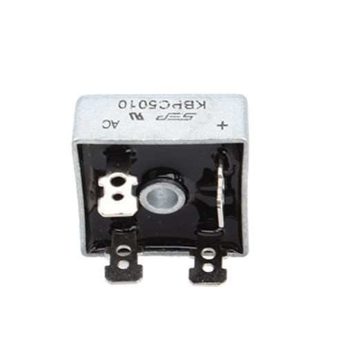

I recently was watching a thread about how to build a hybrid eBike ... using a generator.
After shaking my head at various complex, impractical, EXPENSIVE possibilities I decided to put my mind towards the project.
As always ... I believe ... "Simpler is better!"
Doable!
Parts list:
2 - 48V capable brush motors (OP requested 2 motors to handle cargo etc.)
1 - 96V capable brush controller ... might be tough to find?
1 - 96V "buffer" battery (109.2V full charge)
4 - 30-50A rectifying diodes
1 - 1200-1500-2000?w 110V AC generator w/4 cycle engine
96V will run 2 - 48V brush motors in series - 48V through each motor but requires 1 - 96V controller
(I doubt a typical 48V controller placed between motors would work ... perhaps a top quality or cheap crap one might do it?)
Actual generator Voltage output may vary but many generators have voltage "trim" or "governor" adjustments between 110-120V
4 diodes will "full wave rectify" 110V AC into DC with a minimal <1V voltage loss ~109.2V DC
Higher generator output might be usable with directional diodes protecting battery from generators over voltage.
Battery replenished by charging through its BMS, (most provide over voltage protection).
Dependent on the size of the 96V battery, this might be classified a hybrid or a series hybrid.
