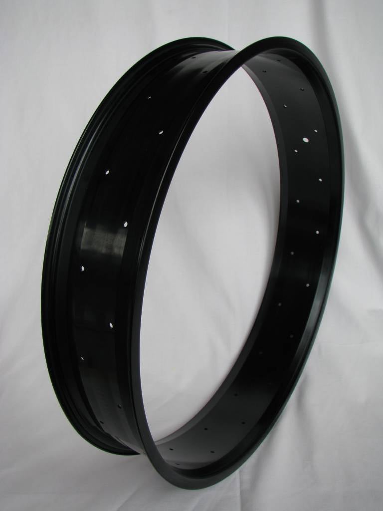

Hello,
I read the thread and learned a lot.
So my project is a bit different from normal as I am building a chopper style ebike.
Currently I am researching tyres/rims sizes and this thread was really helpful.
The idea was to use a street motorbike large tyre on a large custom bicycle rim: 17"/16" x 5"
Motorbike Tyre: 17" or 16"
Custom made Rim: 5" = 127 mm
So I was looking around and can't really find 5" bicycle rims, largest I found was width 20"x3.9"=100mm
The easy way would be just to use an entire street motorbike wheel, rim and tyre, and most likely cut the spokes since these wheels have 3 or 4 big spokes, but they will be pretty heavy.
But I wanted to see if I could make a custom build.
Any advice and also any information on the sizes?
I mean, can I make a custom bicycle rim build of 17"x5" to fit a 17" motorbike tyre?
Does it make sense?
Just wanted to add, if I tell these guys to make a 17"x5" custom rim, can than I mount 17" motorbike tyre on it?
Alessandro

biskero,
welcome to the forum!
i think you need to decide what tires you want to use first..
then find rims on the market that are readily available and are the recommended size for your tire choice..
sounds like you want a small diameter wheel with a wide tire (for street use..)
most likely you will not find bicycle tires / rims in this size because bicycles (for adults) tend to have larger diameter wheels.. and bicycle tires will not normally be super wide because that would pedal very slow with much rolling resistance.. but maybe that is where the (e)motor comes in handy.. but super wide tires will not be as efficient and will require more power and batteries.. and that adds weight and money..
that said check into "Supermoto" rims.. Prowheel sells several rims for supermoto/ street tires and Shinko sells street tires to match.. check the tire specs of your desired tire for recommended rim size / width..
if possible go to your local motorcycle shop and check out the tires in person to get a feel for the size, weight etc..
http://www.shinkotireusa.com/tires
http://www.prowheelracing.com/rims/
or maybe check into kids fatbikes with 20" small diameter fatbike wheels that you could source the wheels from.. this would be much lighter weight than moto rims & tires.. and likely less expensive as well..
example: http://www.bikerumor.com/2014/03/09/wal ... -fat-bike/
or maybe something like this 24" x 4" fat wheels..
you would not want to have a rim custom made because that would cost LOTS..
rim manufacturers rely on quantity so a one off custom rim would likely be very expensive..
also if there are tires made in a size that works for you then there will already be rims to fit that tire on the market.. tire manufacturers do not make tires that have no rim made to mount on..
hope this helps some.. keep us posted on what you get and your build!

Ciao,
thanks a lot for the infos.
Like you said I need to match motorbike tyre to bike rims.
Currently I have the following requirements fixed as looks like from various infos I gather that:
A motorbike tyre of 16" will fit in a 20"x100mm rim bike. I have found such rim so will buy it and do some testing.
Now I need to decide which width of motorbike tyre I want and my thinking is <180mm else it's too wide.
So until now I got the following requirements down:
Rim: 20"x100mm
Tyre: 16"x 160-180mm
By the way I am building the body of the bike so my requirements are flexible in a way to adjust details.
About the custom build of rims and cost I am contacting some manufactures and the costs are not too prohibitive as I thought before my research.
Anyway thanks for the feedback and information.

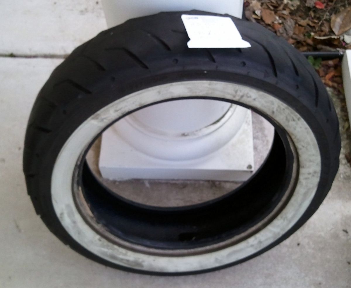

Basically I want to understand if the tyre in this post which have the following information
D407 180 65 B 16 81H and it's dimensions are:
Inside Diameter = 16"
Outside Diameter = 25"
Outside Width (bead to bead) =4 3/4"
Outsude Width = 6 3/4"
would fit into a 20"x100mm rim like this one, any idea?
So at that point I have the following requirements for my rear wheel:
RIM (bike): 20"x100mm
Tyre (motorbike): 16"x160-180mm
About the spokes I will ask you later on.
I know is very wide tyre but that's the all point for this project ! :)

This is correct Allesandro, you can use 16" MC tires on 20" BMX bike rims which is actually 16 inches. But, I am not at all familiar with those bicycle chopper tires and rims, but it should work. Remember the bicycle industry uses the outside diameter of an inflated tire to measure wheel size with a 1.75" wide tire with proportional tire profile heights and the motorcycle industry measures the size of the tire by the rim its mounted on. This is why a 24MTB tire which has a 20.5" rim and a 19x1.4 MC rim running a 2.75-3.00-19 size tires is really close in size. So for you question, if that black rim is rated as a 20" chopper bicycle wheel, it should have a 16 inch rim, and yes there have been folks on Endless Sphere who have mounted 16"moto tires to 12" bicycle rims because they are the same size. I would search ES and speak with someone that has specifically worked with that size of rim and tire combo.

thanks for the explanation, finally I got a definition that makes sense! :)
My plan at this point is to get the 20"x100mm bike rim and than search for moto tire 16" to a local moto tyre shop, maybe used ones to see what works.
After that, hub and axle research and planning which is going to be tricky.
