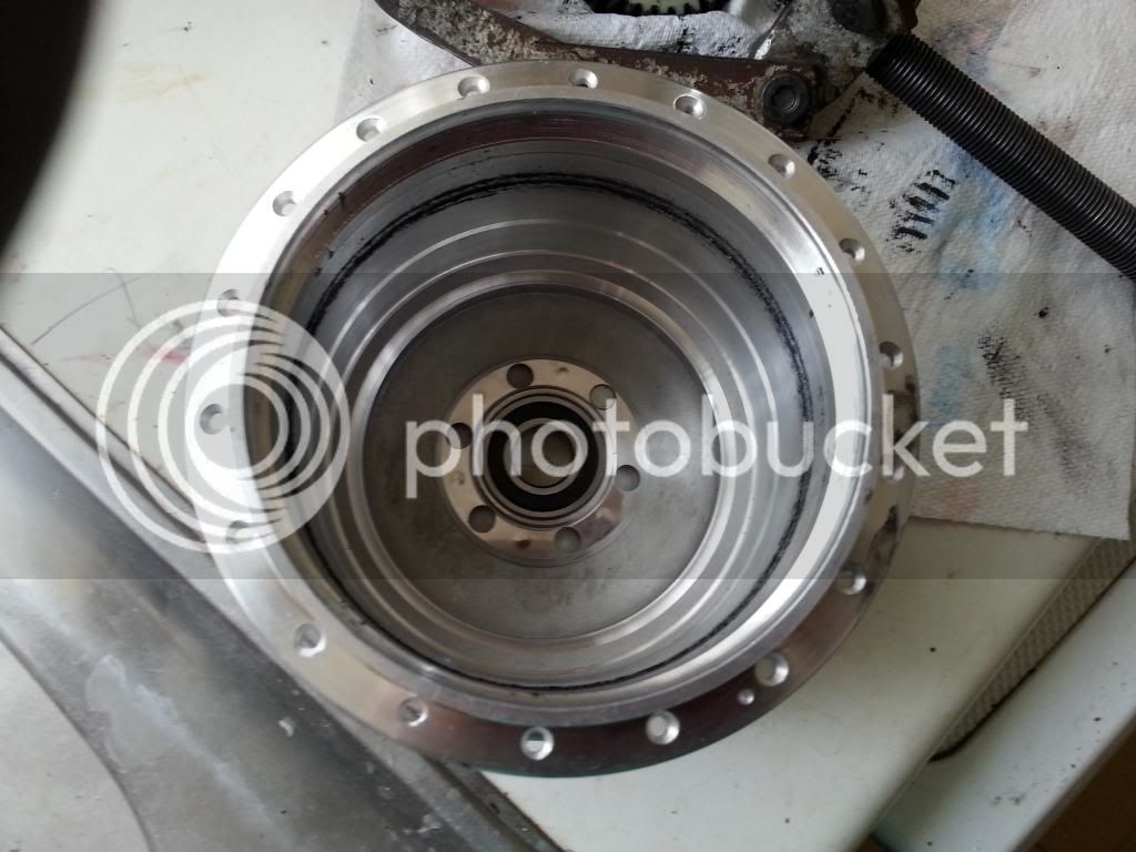

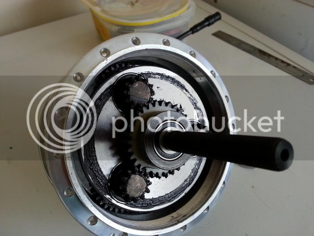

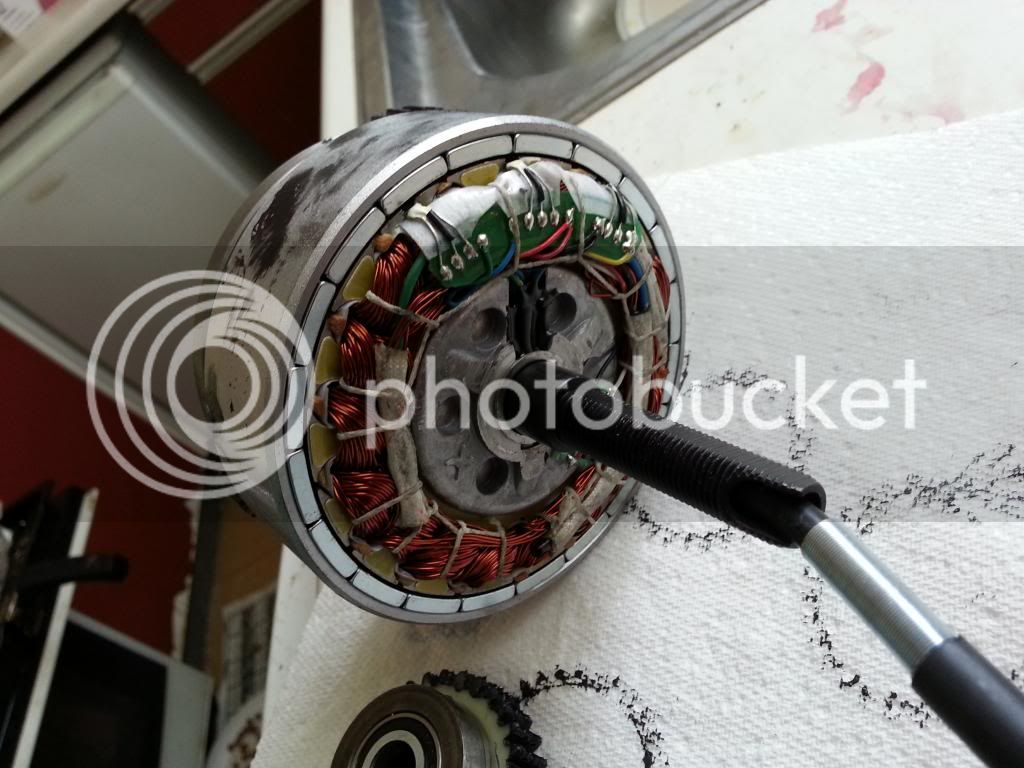

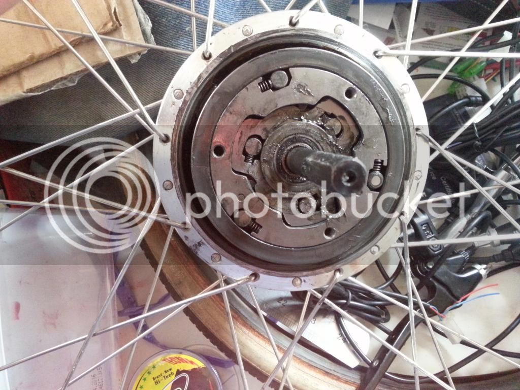

I opened one up today, and this is what I found:
It opend like a Q100. You remove one of the three screws and replace it with a cap-head screw and washer, then you can lever it round counter-clockwise with a wrench.
Inside, it's nearly the same as a Q100. It has two-stage planetary gear reduction. I'll give all the gear ratios later.
The plate only holds the gears. the clutch is in the outer cover, which is the clever bit, because it has a double clutch in it.
When the motor turns one way, the inner gear s locked to the side-plate, so it turns it directly. The outer ring-gear has another clutch, so it's disengaged. When the motor turns the other way, the inner gear is released from the plate and the outer gear engages to turn the plate in the same direction, but with a lower ratio. The planetary gears are turning the ring gear and inner gear all the time, but only one engages with the side-plate in each direction. The difference in ratios is the difference between the number of teeth on the inner and outer gears. There's no reason that this simple mechanism can't be scaled up for a more powerful motor.
The motor looks very well made inside. There's a magnet behind the disc fixing, which gives the speed of the motor through an additional hall sensor (hiding behind the axle in the photo below).
Last edited by d8veh on Mon Apr 28, 2014 5:23 am, edited 1 time in total. View post history.

Postby d8veh » Mon Apr 28, 2014 6:25 am
20 magnets
18 stator poles
Magnet size 20 x 14.4 x 3.5mm
Lams 0.5mm
stator lam width 20mm
Stator dia 90mm
Final gears 30T.54T composite
Planetary gears 12T steel, 32T composite
Rotor gear 18T steel (I forgot to count the teeth on that one. That's the best I can count from the photo).
Spoke hole PCD 120mm

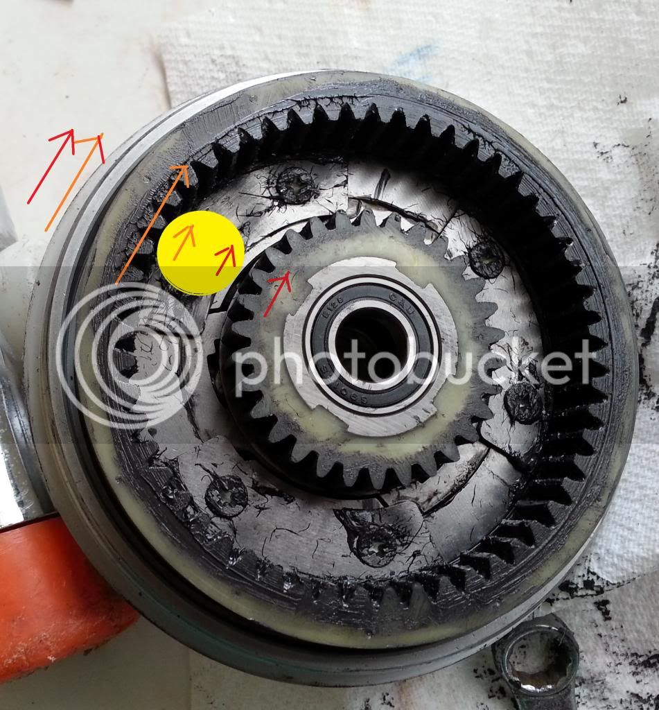

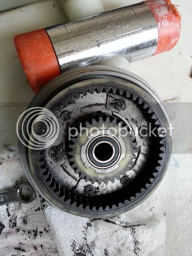

Postby d8veh » Fri May 02, 2014 4:31 am
It's pretty simple really. The planetary gears are permanently engaged with both the inner gear and outer ring-gear on the side-plate, so those two gears rotate in opposite directions.They each have a ratchet (clutch) that drives the side-plate in the forward direction, so when the motor turns in one direction,the ring gear drives the side-plate, and in the other direction, the inner gear drives it. The side-plate is only engaged with those gears by the ratchet. The mechanism is a stroke of genius - so simple and logical.
it's not possible to show by video because the side-plate has to be assembled for it to work. Look at this photo. The yellow circle represents a planetary gear and the red and orange arrows its two directions of rotation. In the red direction, it turns the inner gear forward and the outer gear's clutch slips. Int he orange direction it turns the outer gear forward and the inner gear's clutch slips.

Postby d8veh » Mon May 05, 2014 4:34 am
No. The planetary gears are permanently engaged with the inner output gear and the ring output gears, which turn in opposite directions and at different speeds.
In low gear setting, the ring gear's clutch engages and the inner gear's clutch disengages, so it's exactly like a normal geared hub-motor.
In high gear setting, the motor reverses direction, and hence the planetary gears rotate in the opposite direction, so the ring gear's clutch lets go and the inner gear's clutch engages. The inner gear rotates in the opposite direction to the ring gear, so with the motor rotating the opposite way, the output drive is still forward.

Postby d8veh » Sat Jun 28, 2014 4:48 pm
Here's a better photo of the double clutch:
