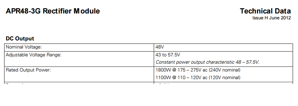

Just wanted to update that I believe based on the specs that if you use constant power, the voltage range is 48-58.
Because it says in the spec sheet "Constant power output characteristic 48 – 57.5V." and lists voltage range 43 to 57.5. I assume constant power is based on adjusting the amps?? Mean you can adjust say 43 volts and 5 amps, only 48 volts and 5 amps. Kind of sucks if you are between voltages when using more of these units.

Allex wrote:Used pop rivets again, the tool does cost less than 10 bucks.
Not sure what you mean but one of my PSUs is running 43V10A and another is 44V10A
Thanks, I didn't realize the tool was so cheap.
Just quoting this from the APR48-36 Technical Data sheet.Where is says the Constant power output.

Post by Allex » Aug 17 2017 3:06am
Adjustable Voltage Range: 43 to 57.5V
You can always try to set a lower limit, if it does not accept it it will just run at the lowest possible.
So if you set it at 41 and this is a no go it will run at 43

Allex wrote:Adjustable Voltage Range: 43 to 57.5V
Ok, so you did not try it, then its up to me, ill buy the USB Link and will see

I plugged the charger into a plug meter. the network is 230Vac 50hz.
When plugging the charger into the battery the meter is marked 2570W.
I measured the battery voltage and it was at 62V. if the current limiter is 38.5A as it puts in the programming. the rectifier is giving 2400W output. much more than the nominal 1800w.
Have I left the rectifier withstand 2400W? Under the amps at 31A to lower the power to not burn it?
Can I use normal type capacitors? Do I need capacitors low resistance and high ripple current, like the original capacitors you have installed?

vicens wrote: I measured the battery voltage and it was at 62V. if the current limiter is 38.5A as it puts in the programming. the rectifier is giving 2400W output. much more than the nominal 1800w.
so wait, you managed to get 62 Out of the PSU ?
but with a resistor Mod, not with the Software right ?

with resistance mod. set to 67.2V in vacuum.
The maximum voltage with resistance mod is 70V.

This rectifier can be programmed from 43 to 57.5V
Should be good to program from 11 to 13S.
The mod voltage of 14S can be made. without changing the capacitors.
The mod can be made from 15 to 16S. changing the capacitors.
From 10 to 15S there is much difference.
If you want to charge 100%. the 10S configuration. and the battery has bms. you can try the rectifier. It might work.
