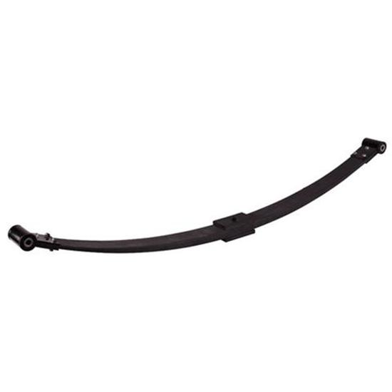

Chalo wrote: You could put the front axle stubs on the ends of a beam, and suspend the beam (e.g. on leaf springs). That could be simpler than what you're suggesting, without harming steering geometry.
This is why people missed Chalo. They use the traverse steering a lot on cyclekarts, glorified gokarts with suspension. The pic is using Honda 16" wheels has found on the Supercub, various other small motorcycles and mopeds, etc., you collect them on eBay for $20-40 each, or less even, depending on your willingness to rehabilitate them a little. http://www.cyclekartclub.com/phorum/list.php?2
The leaf springs are for a horse drawn buggy, would you believe. Tried and trusted on numerous cyclekarts, which mostly are for offroad/trail use. http://www.iowavalleycarriage.com/conte ... eat-spring
If you want A arms, you can go the ready made route, if you stick to smaller ATV's. For this price you can buy a whole small Chinese ATV NEW and sell off what you don't use. http://fr.aliexpress.com/item/Modified- ... 76804.html

With FR-4 or G10, you'll waste half the weight and fiber content by running it across the applied load instead of lengthwise. It's a good material, but yours is not an ideal application for it.
The Chevrolet Corvette had fiberglass leaf springs for decades; it might still have them, for all I know. Those might be a good module from which to cut the springs you need.

I mean all the fibers should run from end to end, not from side to side. (Relative to the spring, not the vehicle).
Most leaf sprung vehicles orient the leaf springs from front to back; the Corvette laid them out sideways. But that's irrelevant to what I'm talking about. Fibers that don't run in the direction the spring flexes do not help you, but they add weight and thickness.
