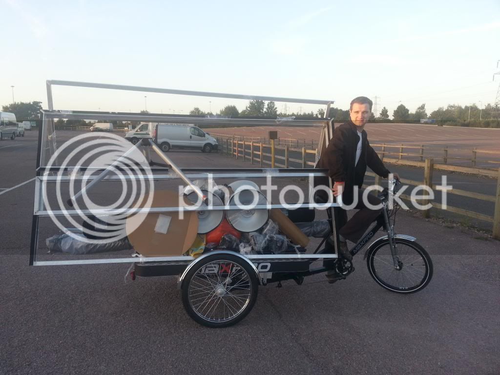

We've done it on Pedicabs using a clone 500w Bafang CST motor (Xofo). You position the motor on a set of drop-outs between the rear axle (diff) and the crank as a jackshaft. We use derailleur gears on the motor because the idea is for the riders to pedal for legal reasons, though there's enough power that they don't need to. We use a 2:1 reduction ratio between the motor and the axle by running a chain on a sprocket fitted to the disk brake fixings. That takes the maximum speed down to about 12 mph, but doubles the torque. You can make the final ratio whatever you want to trade speed for torque. The motor runs at 36v and about 22A. A EM3EV modded MAC, should run happily at 48v and 25A, so would have a lot more power. I think that it'll be enough unless you have steep hills. Here's a picture of our cargo version, which is rated for 380kg all-up:
