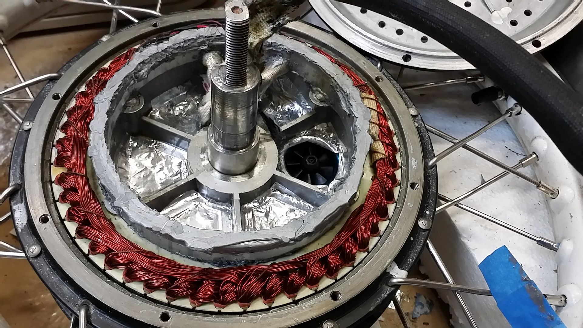

Your best bet is to just do it yourself. I was considering doing it and madin88 was able to machine a side cover and axle for the MXUS to fit water cooling hoses. Once you can get water cooling hoses you can just run some copper pipe and thermal epoxy it to the windings.
That all being said there was no reason for me to do this because I run a high speed RC EDF fan inside my motor that sheds all the heat I need. It may even work better than a water cooling setup.
It sucks cool air in and blows the hot air out of the motor like a blow dryer. I adjust the speed accordingly.
I was thinking of using ferro fluid and hubsinks for my new MXUS Turbo, but I think I'll just modify it again for EDF cooling because it simply cools the motor so well. I can't really see hub sinks & FF working better. Plus I do a lot of hills and wheelies where I really overheat the motor at lower speeds.
But don't get me wrong, if you full throttle up an extremely steep dirt offroad hill where you are at full throttle and barely moving for long periods of time you will start to overheat the motor. I don't think even water cooling could effectively remove all that heat when the motor is almost stalled like that for 30 seconds or more. However, with the EDF cooling as soon as you stop the steep climbing the temps come right back down so you never have to wait for cooldown.
If you never saw my motor modified for EDF cooling here is a pic. That little 30mm fan blows so much air. I'm actually going to be replacing it with a 35 mm EDF fan that will more than double the amount of air flow. But I usually only run the fan at 30% speed anyway.

This is why I love the sphere! Someone does something out of the box :) I bet you many people told u it couldn't be done :). So running power in is far easier than water cooling pipes, I take it no axle modification was needed?
Do u have a thread on the conversion and any stats around how well it's performed for u?

Water cooling is just way too complex to build. Especially since they don't make hub motors with large enough axles for the water cooling hoses to pass through. The other issue is you will add weight with all the copper tubing and water pipes.
In my opinion it isn't worth it if you can install a ~40 gram EDF fan that will blow air very powerful through all the copper windings. This acts the same way as a blow drying blowing through the coils. It just pushes so much hot air right of the motor. The hot air coming out of the motot is so hot that it will burn your finger if held over the vent hole. This is serious heat being blown out.
Only drawback is you will have a fan noise coming from the motor but I don't mind this noise, you can also shut it off if you are not overheating your motor and just driving around slowly.
You will also need electronics, a 12 volt DC-DC converter and tiny ESC to run the fan, but this is simple and cheap enough to buy.
The setup is very reliable also as I have run this for hours per day without any issues, cooling my motor in the extreme heat of the summer where temps are the highest.
I'm going to be modifying my MXUS turbo for EDF cooling and can show you the steps on how to do it. This motor will use a much more power and larger EDF fan which runs on 12 volts and also has a lower KV to not draw so many amps. But it is rediculously powerful in the amount of air it moves. The MXUS is also tighter which will allow better air flow through the windings. I also plan on possibly using vents on the outside of the case so that the hot air doesn't get sucked back into the intake air as easily for even extra cooling.

Sorry missed this post. Yes running power to the fan is easy, in the new MXUS v3 you can even just use the wires for the unused set of halls. I am also upgrading the EDF fan to a bigger EDF with much lower KV to run it at 12 volts instead of the 8 volts to cut back on the needed amps. No axle modification.
I am going to modify the Mxus V3 I have for similar air cooling, and this hub motor I believe is much easier to work with than a cromotor. I'll make a thread about doing it and will let you know.
Air cooling which brings in fresh air and exhausts the hot air out works really well. Just look at all those windings in the picture, the air flows right through all those windings at a very high speed. This works simply how a blow dryer works. It really pushes the hot air right out of the motor. Holding my finger over the exhaust air will start burning my finger, considering how much hot air is exhausting this has to work much better than hubsinks + FF.
