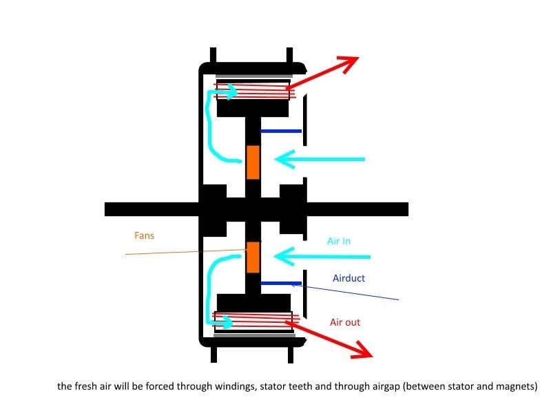

skethism, I agree with that if the motor is not spinning and the bike is stopped the hub sinks will work very well. The motor will also get very hot like that when not riding.
What I have found is that if I am riding at say 20-25MPH, the hub shell without any heatsinks will be lukewarm / cool to the touch. A spinning hub motor will shed the heat so fast while riding the bike will cool down super fast even without hubsinks.
Even if I let my bike sit for a few minutes so that the exterior gets burning hot to the touch, it will cool the exterior in 10-15 seconds of riding.
I want to use another high speed fan approach on my MXUS, which worked very well in my Cromotor.
I have to decide for my new motor if I want to give up this setup for FF + hubsinks.
Here is a basic diagram of my cooling setup, it blows the hot air out continuously at high enough temps which will start to burn your hand after a few seconds. This is some serious heat shedding and I can't believe that FF + Hubsinks will work as well. But it might just work as well.
What I need to know is how hot the exterior of the motor is getting at cruising or even slow speed riding. If the motor shell is still burning hot when riding then the hubsinks and FF are working. If the motor feels cold to the touch on the outside then the hubsinks won't help unless you are basically stopped.

Offroader you're not factoring the lack of heat path into your assessment of hubs of speed. Before ferrofluid heat had to travel via the bearings.
Especially relevant to your last sentence.
Using conduction to the case then maximising convection at the periphery is preferable to trying to perform convection inside.

Offroader wrote:skethism, I agree with that if the motor is not spinning and the bike is stopped the hub sinks will work very well. The motor will also get very hot like that when not riding.
The defining factor of the difference though is the FF here creating a thermal path from the stator to the magnet ring/sink and out to the turbulent air

I'm just saying I would like a test of the exterior motor case temperature when riding at 15 MPH+ speeds with FF or oil.
I agree when stopped the exterior of the motor gets hot.
I have found if you ride at 15-20MPH+ speeds the exterior of the motor cools down very quickly without hubsinks, so quickly I question the usefulness of hubsinks on a bike at speed.
From my own tests using forced air convection inside the motor, I could not get the exterior of the motor hot when the bike is in motion. I even tried to keep the winding temp at 115C and had my fan speed on maximum, still could not get the exterior hot.
If I stopped the bike, then yes the exterior motor temp got very hot, but still took some time to do so. When I used NO forced air convection on my MXUS, I could not get the exterior of the motor hot even when left sitting for a long time.
There is a bottleneck in the FF or magnet gap.
