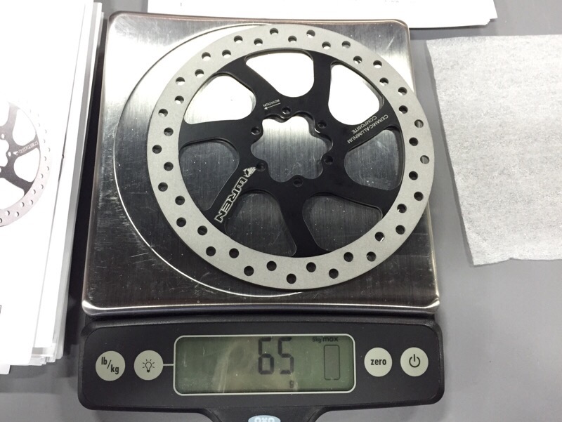

I look at a larger rotors benefit like using a longer wrench to free a tight bolt with the added benefit of more surface area for faster cooling.
Its nice when the improvements stack up like that
I have read some Pro riders use oversized heat treated aluminum Rotors , can't find any online but did find these.
Ceramic/ aluminum rotor
Both would wear out much faster then stainless I imagine.
