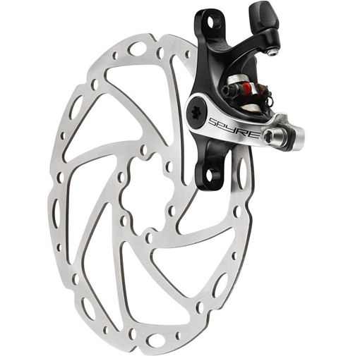

They were selling the TRP Spyre with 160mm Rotor for $50 on eBay so I ordered it.
For Mechanical disc's the reviews point toward the BB7 spyre or the Klamper with the spyre reported as the best value.

see article ~ http://www.cxmagazine.com/trp-new-spyre ... ual-piston
The main difference between the Spyre's and BB7's are the spyre's use dual pistons one on each side vs the bb7's single piston.

The mechanics of the TRP are a superior design to the bb7's which despite their short comings have worked well for people as the online reviews denote.
