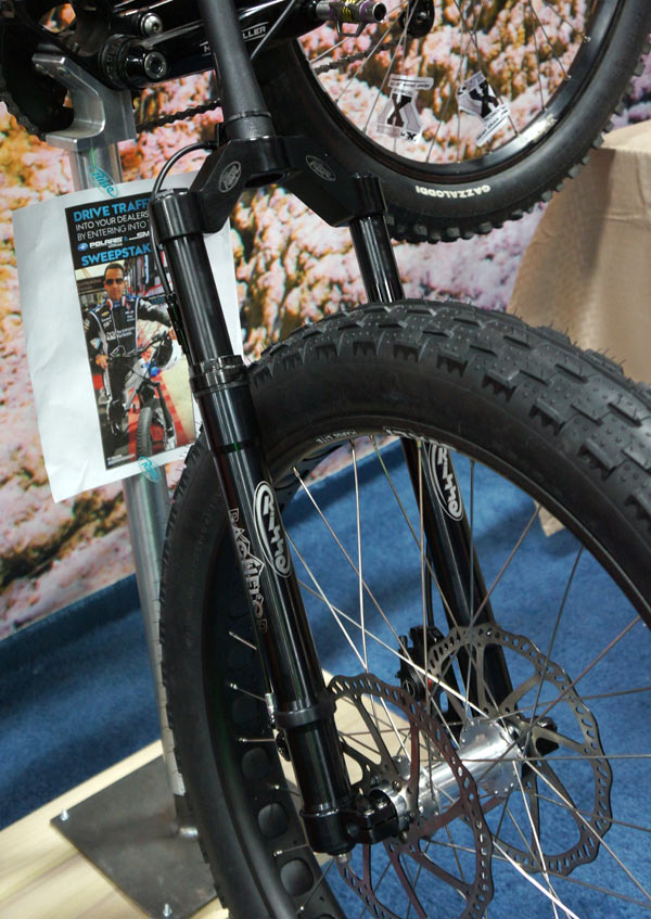

Re: Specific heat absorption capacity of disc brakes
I note that the diameter of the front disc brakes in the photo are approaching the same as the motorcycle's rims. There are also two of them. So as the need for high performance increases, does disc brake sizing tend to mimic what we already have with rim brakes? It sure seems so. Note that the less important rear brake is smaller (I can't tell if there are two of them). And yes, I understand that at some point it is desirable to move the heat generated by braking away from the pneumatic tire.

Well, it looks like somebody already thought of that:
Nice that they're running one rotor each way... that's a great way to test the spoke direction theories.
