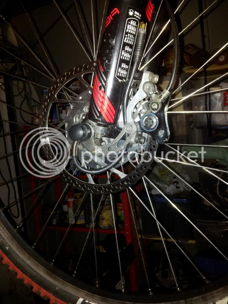

My old front wheel and fork got destroyed in an accident with a car,
so as I have to replace it anyways its now time to mount the Q100H in the front to finally have 2WD.
Do you see any problems using this fork for the task:
http://singletrackworld.com/forum/topic/fs-fox-f80-rl
edit: (the fork it postmount and not IS2000, could not find a good picture of it)
Does it make sense at all? I still want to keep the machine light...
I am a bit unsure if and how I can add a torque arm to this.
I know its disc brakes only, so I will need to add a matching brake.
Larger disc diameter does not hurt at all, right?
thank you for your inputs!
I am a little unclear what you are asking, but the Fox products are generaly good quality and you should not have any problem mounting a Q100. The torque arm is easy. Here is the frt. mount on my 2WD;
Shame on you. I'd never use one of those Jubilee clips because they have a nasty habit of breaking when needed. This is a much better way to do it but it only works with a side-mount fork or caliper:
Thank you guys for your input! It took a while, but I hold the fork in my hands right now. Its really nice built, very light and stable. Already love it. Getting ready to go 2WD soon, will keep you updated.
