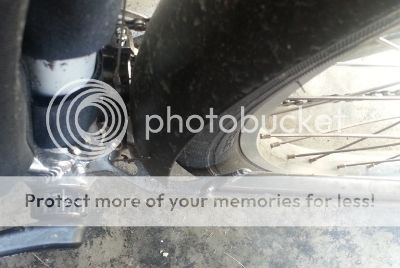

I use similar motors on my bikes for more than half year till now, just I make some modifications for them to withstand my power:
I change phase wires to 8awg silicone wires;
I add temp sensor;
I add industrial varnish on windings (whole motor stator is immersed in varnish batch and than cooked at 120C);
I change axles to custom made with M16 screws:
I add simple liquid cooling that contain of copper sheet/pipe and special thermally conductive silicone to glue it to stator:
mostly use higher speed winding: 3x19 to get ~80km/h speed with 72v battery and 24" wheel.

Hi Linas,
I would be curious to know more about your liquid cooling setup and custom axle.
Do you have any photos that show how the feed tubes exit the motor?
Did you have someone press fit the custom axle into the stock MXUS hub?
Would you be willing to sell the custom axle to people in the US? If so, how much?
Are you still using the same OD/ID bearings and MXUS side covers with the new axle?
Do you have any real world data how well the cooling works. Like temp rise after a set amount of power for some amount of time.

axles are made with 2 side grooves, in one goes hall wires, in other goes pipes and hall/temp cable, axle diameter in that side is 30mm, so side cover is modified to fit bigger bearing ID-30, OD-42. axles are pressed to standard stamped steel stator.
for now have just one picture of ussed motor:
I can offer just completely modified motors for 420euro. 4x15 and 3x19 winding. lead time is 1-2 weeks.
Sorry, I do not have any data, just compared it with cromotor in same track and same controller. Now I have a lot work on big power bikes and do not have time to make measurements, if someone wants to make all measurements I can make ~25% discount for one motor, so regular price is 420-25%= 315euro.
