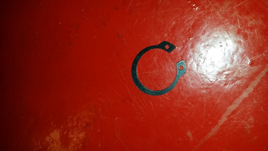

Design flaw? The C washer or snap washer they use cuts right through the thick insulation, you can see a yellow wire showing. The snap washer is so tight and sharp it will eventually cut through the inner wires.
I'm not sure why they would use it to hold the wires secure.
I'll be using a Tie Wrap from here on.
The side covers fit on so easily with the Turbo with larger axle, lots of room for wires to go through.

Yeah, that C-washer is so stupid, most use zip ties
https://endless-sphere.com/forums/viewt ... 5#p1252304
