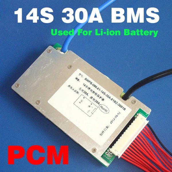

Hi All! I have BMS for 48v battery 25A rating. It has P- and C- spots touching each other. Does that mean my negative charge and load wires can be connected?

Yes P- is also C-.It just means that it doesn't have a extra port for charging like some have.
I find that BMS with their own Charge port are good for a UPS battery. While I use the other one for my E-bike because if i start with regen right off a hill it protects the battery from Overcharging.
Example A:
Example B:
